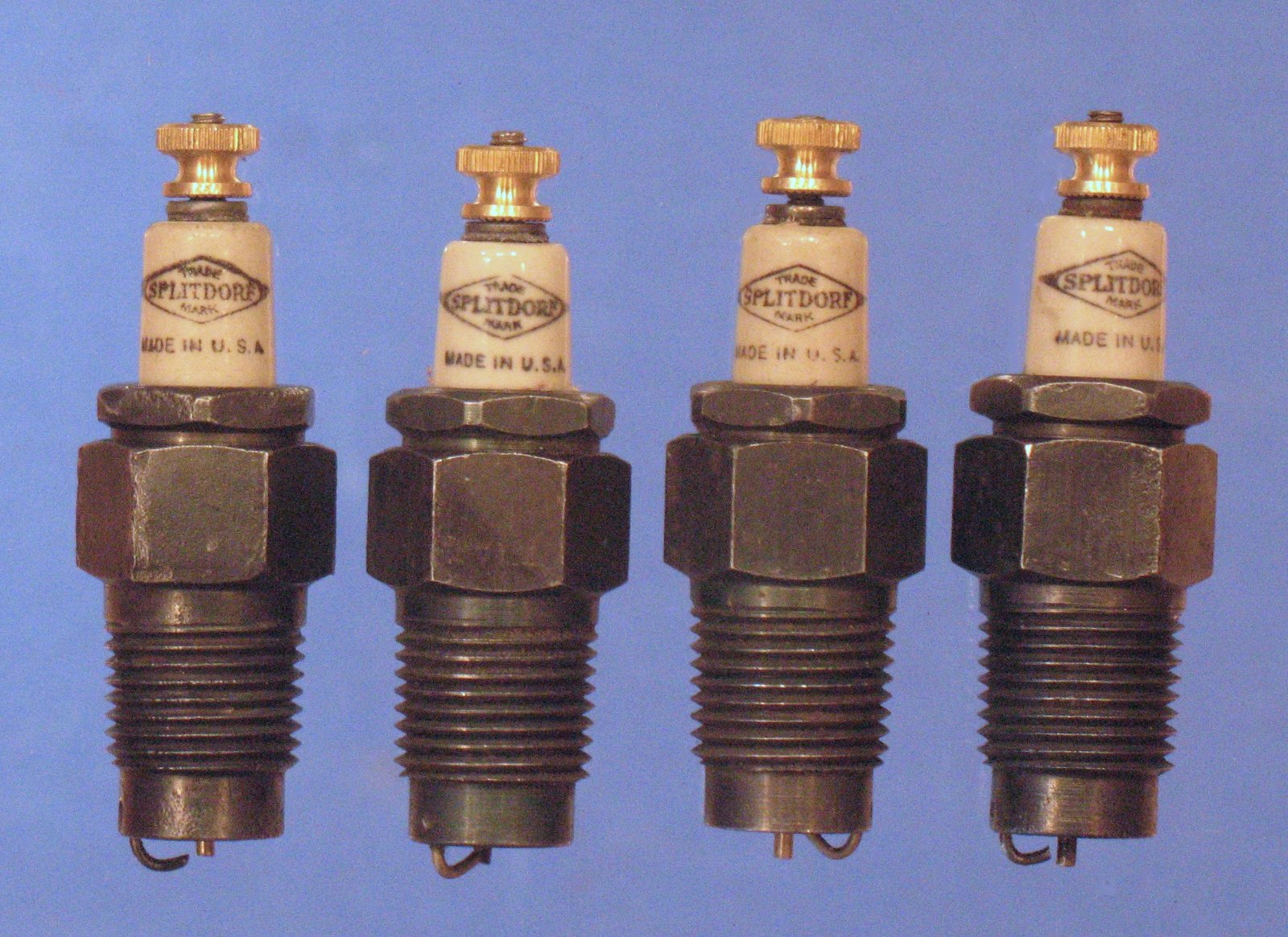

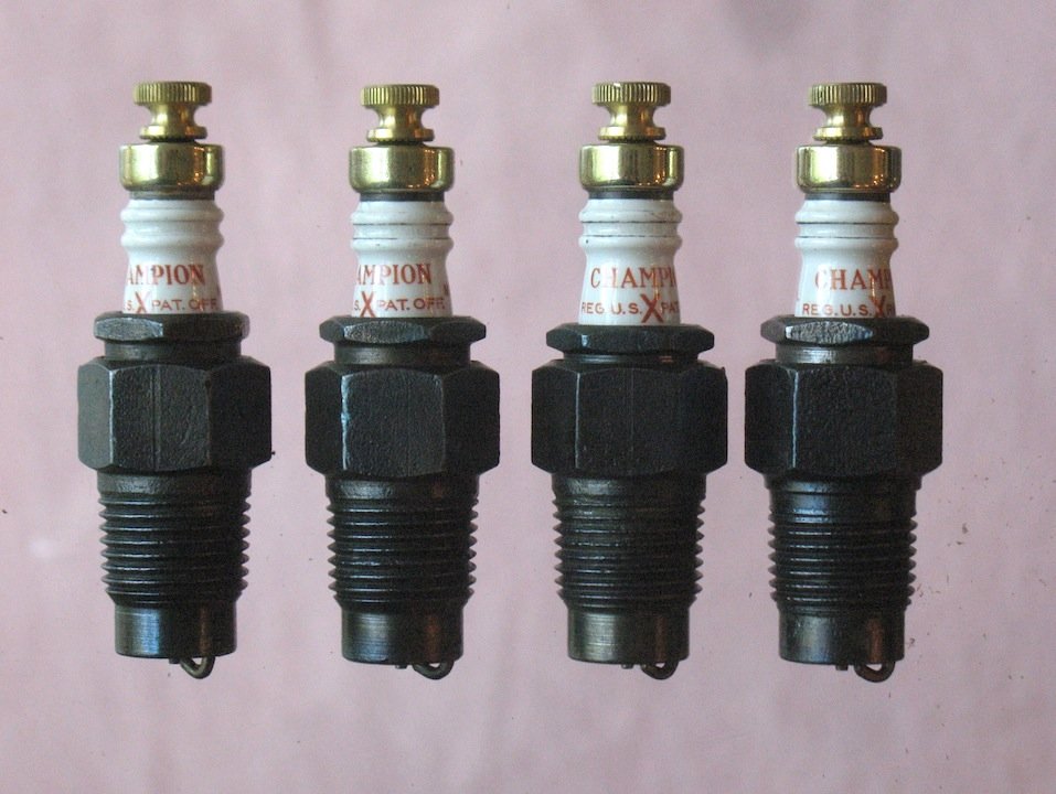

Post by Steve Jelf » Tue Feb 12, 2019 10:42 am
If raven finish = gun bluing, this is one place it was used. I don't know when it was first applied to plugs.
