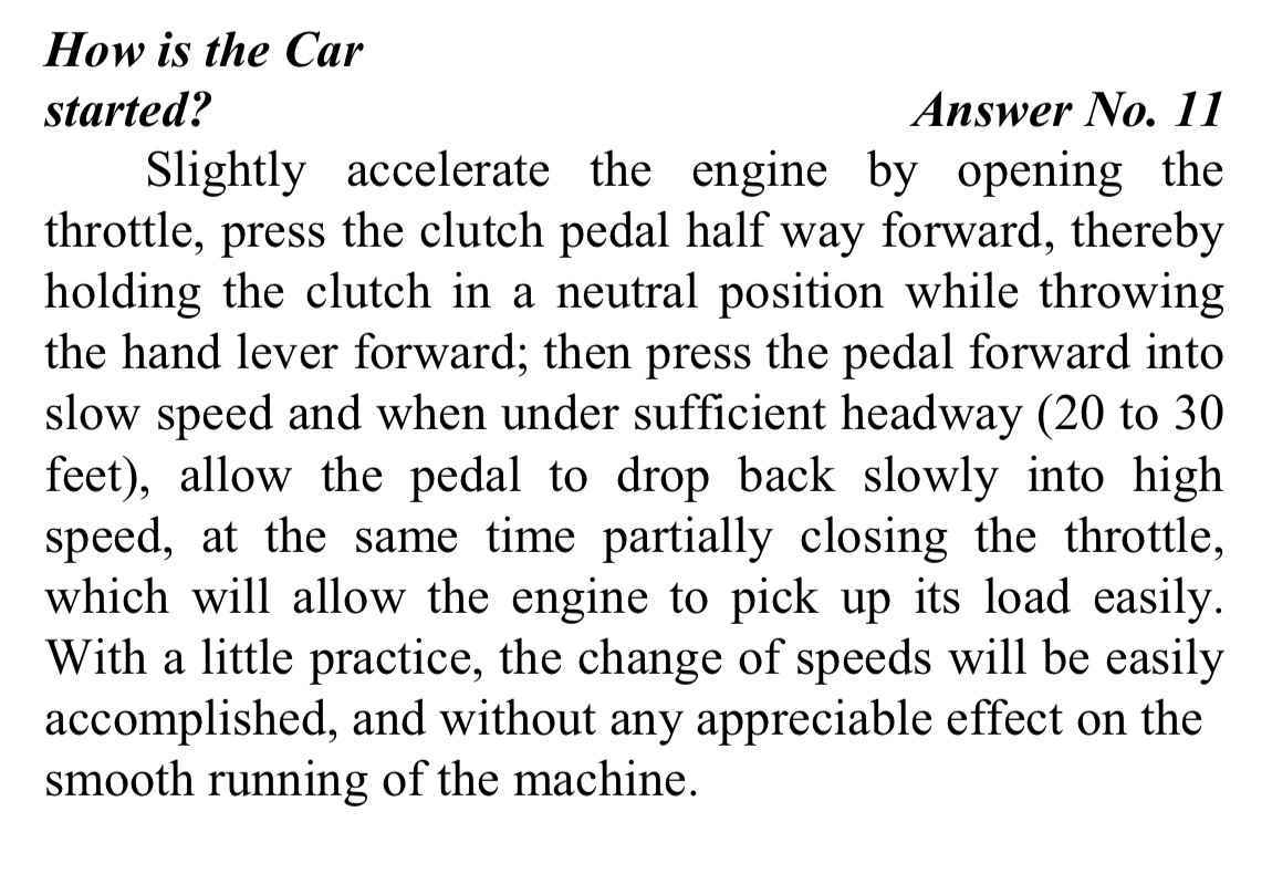

Re: 2d Gear Difficulty
From the 1924 FORD Manual:
- Posts: 6719
Well, now Adam, that's just unreasonable, citing the factory liturature and all.
