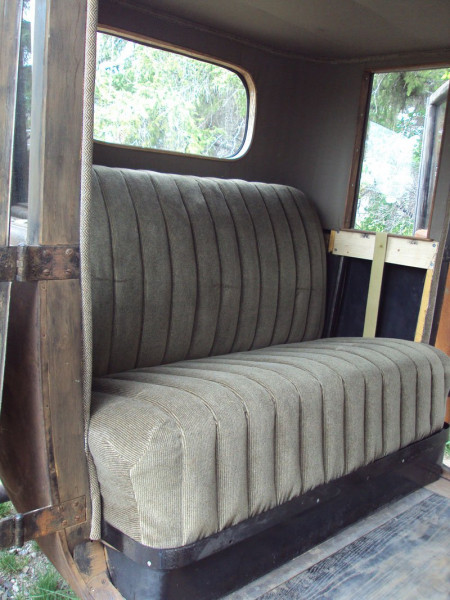

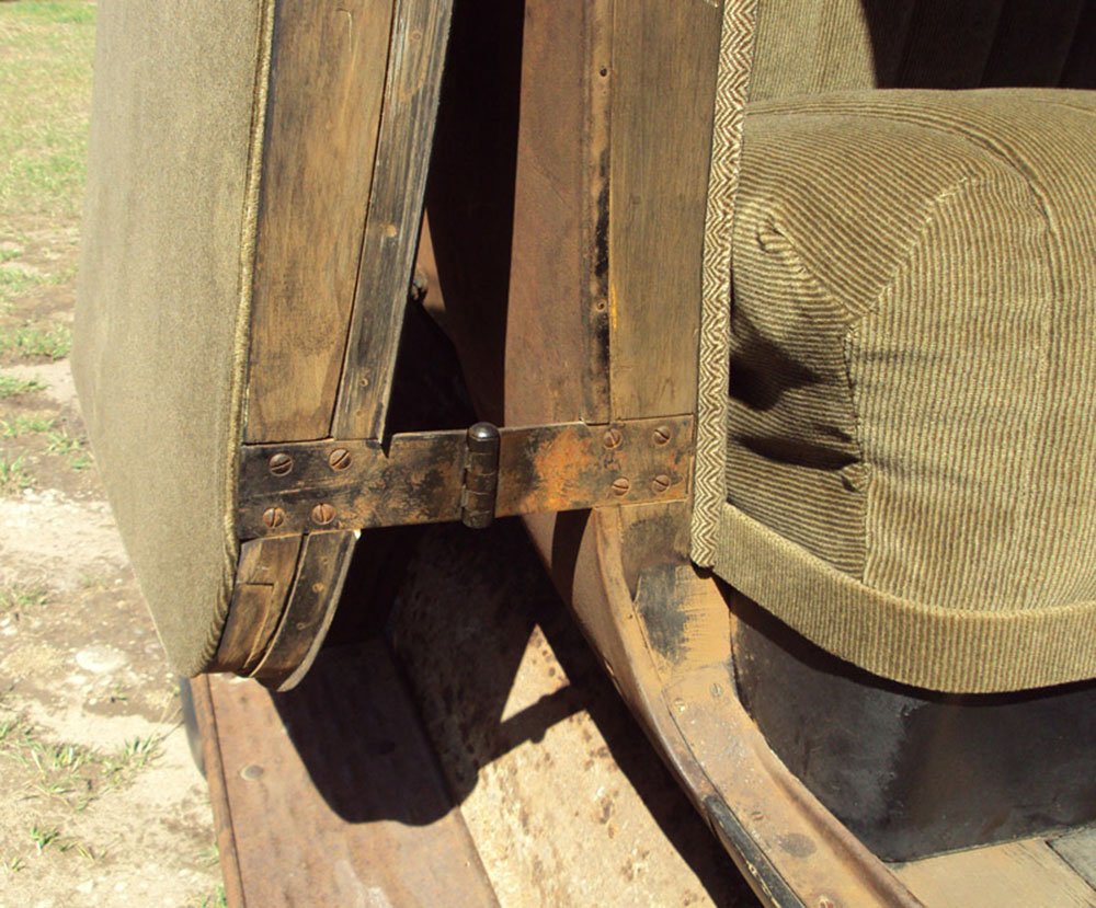

We bought this at Joann's or similar store. It worked well for our coupe.
Rich Only problem is we tried to stain the headliner and it is water resistant.

Rich, that looks great ! Corduroy is a good choice.
Bill Hirsch used to order up authentic wool broadcloth stuffs for the restoration trade, but even 30 years ago it was mighty expensive and required him to make massive orders with woolen mills in the U.K. He may still have some Model T patterns. Worth checking.

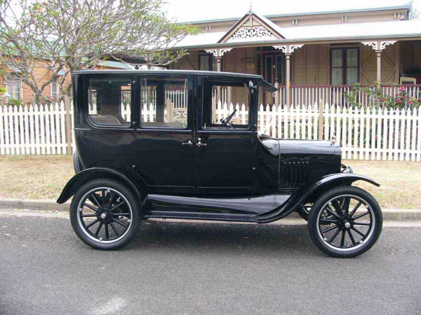

Photo of our 1924 Fordor I restored over thirty years ago.
Best regards, John Page, Australia.
http://www.mtfca.com/discus/messages/33 ... 1363463351
