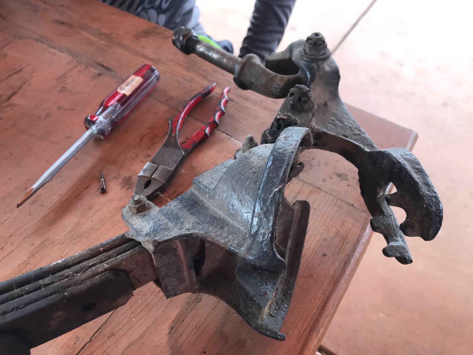

Front axle?
Post by Wwbbim » Fri May 22, 2020 4:48 pm

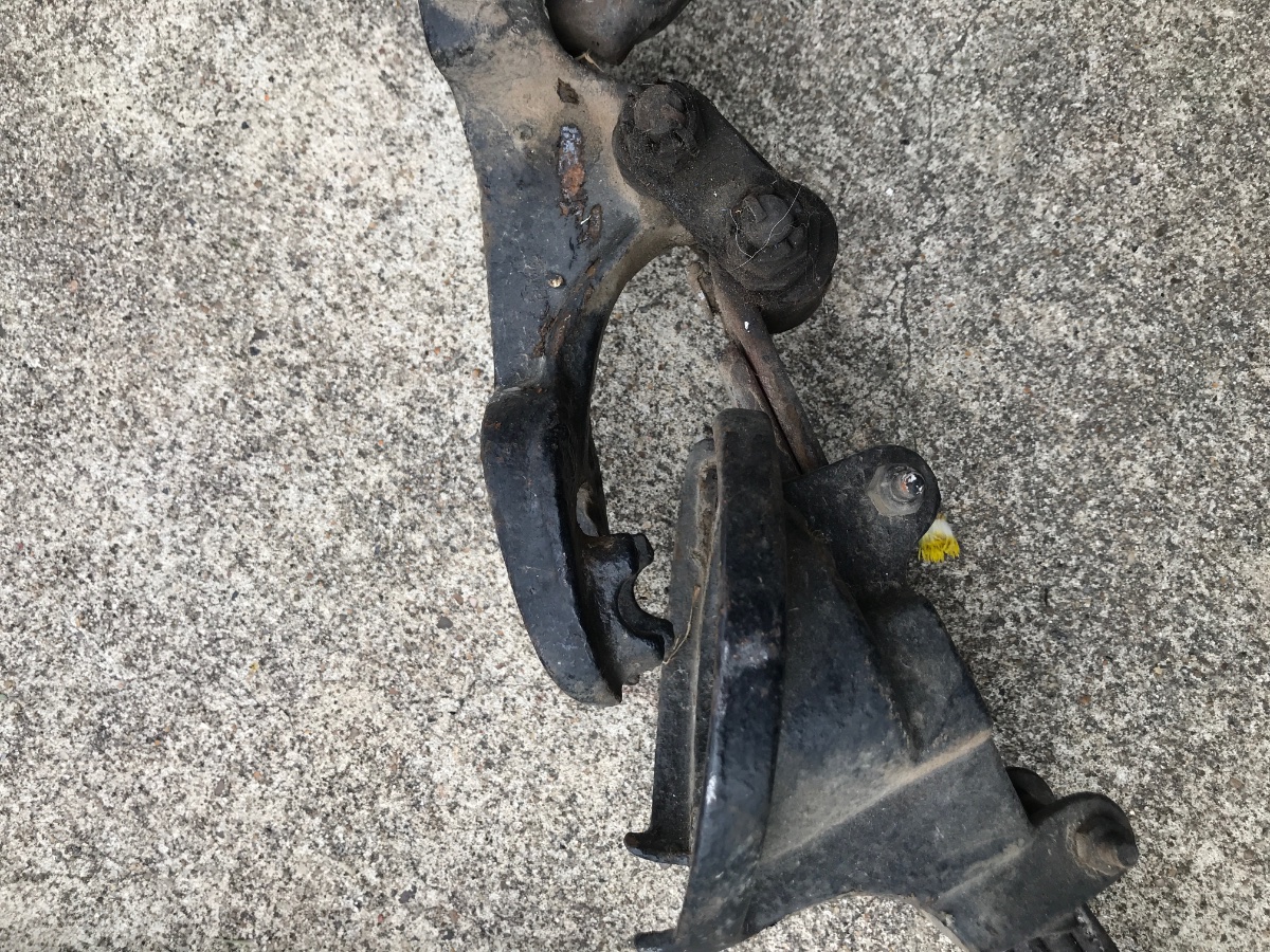

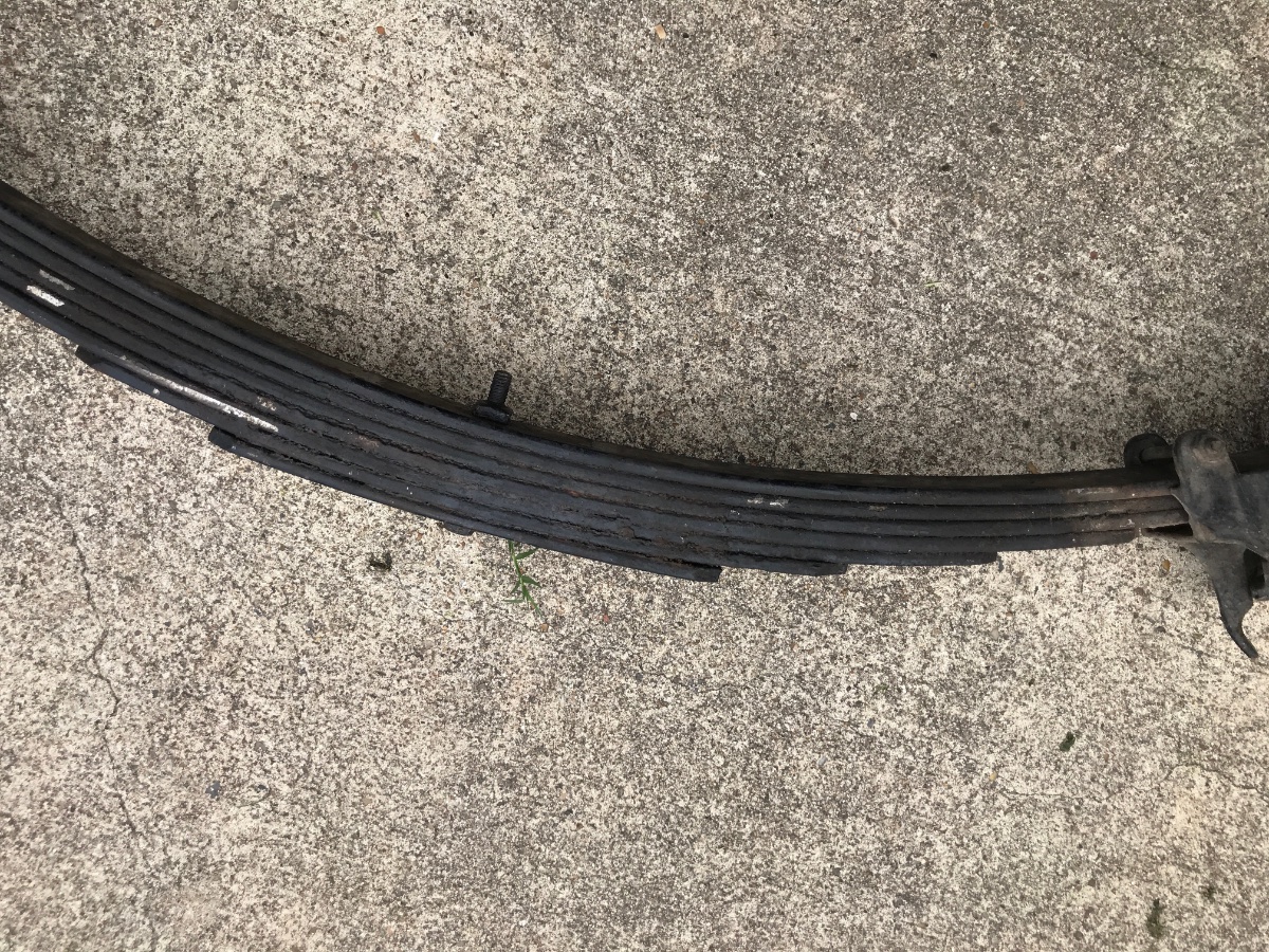

So I am confused about 4 different parts on my 1922 roadsters front axle. When I got the old parts, this is how it came assembled. I have redone the parts but am still co fused if they go like that? It is the parts that attach to the front axle spring(where it went when I got it) and attached to the actual axle.[image][image][/image][/image]

Where is the coil spring?

Re: Dan Hatch it was separated at the time we took the pictures

Take a look at this thread.
http://www.mtfca.com/discus/messages/25 ... 1339967930
It shows some good close ups.

Thanks Mustang 64‘s that makes a lot more sense

Instructions and a caution. Be careful when installing the spring! If your not going to use the Hasslers you'll need to return the perches to their correct position. Bolts are available from for Lang's.
