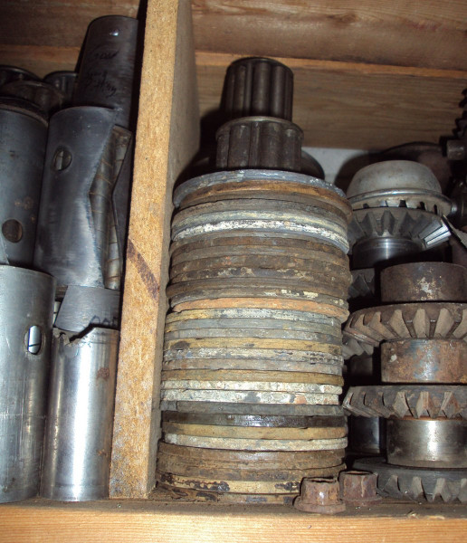

All the above is good advice. Tearing the axle down is a good idea and a rewarding experience. While you are in there you may want to replace the ring and pinion and other parts. I have torn half a dozen working axles down after reading these notes of caution and impending disaster and never regretted it. The last two were torn down because of stories about modern fluids attacking the bronze thrust washers. Each time I found the axles good enough to have run a few hundred miles further.
As I am sometimes a fly in the ointment and don't what anyone to have a catastrophic accident and I will encourage you to attend to this soon. However I will show you a stack of babbitt washers that survived thousands of miles without disintegration.
That differential could go many more miles if there is not excessive end play in the axles or if the lubricating oil shows no sign of babbitt in it. How and where you drive the car could influence how urgent the rebuild is.
Erroring on the side of caution is a good thing but I find I am less likely to drive my cars when I hear disaster stories. I do know they are well meaning and dangers are out there.
