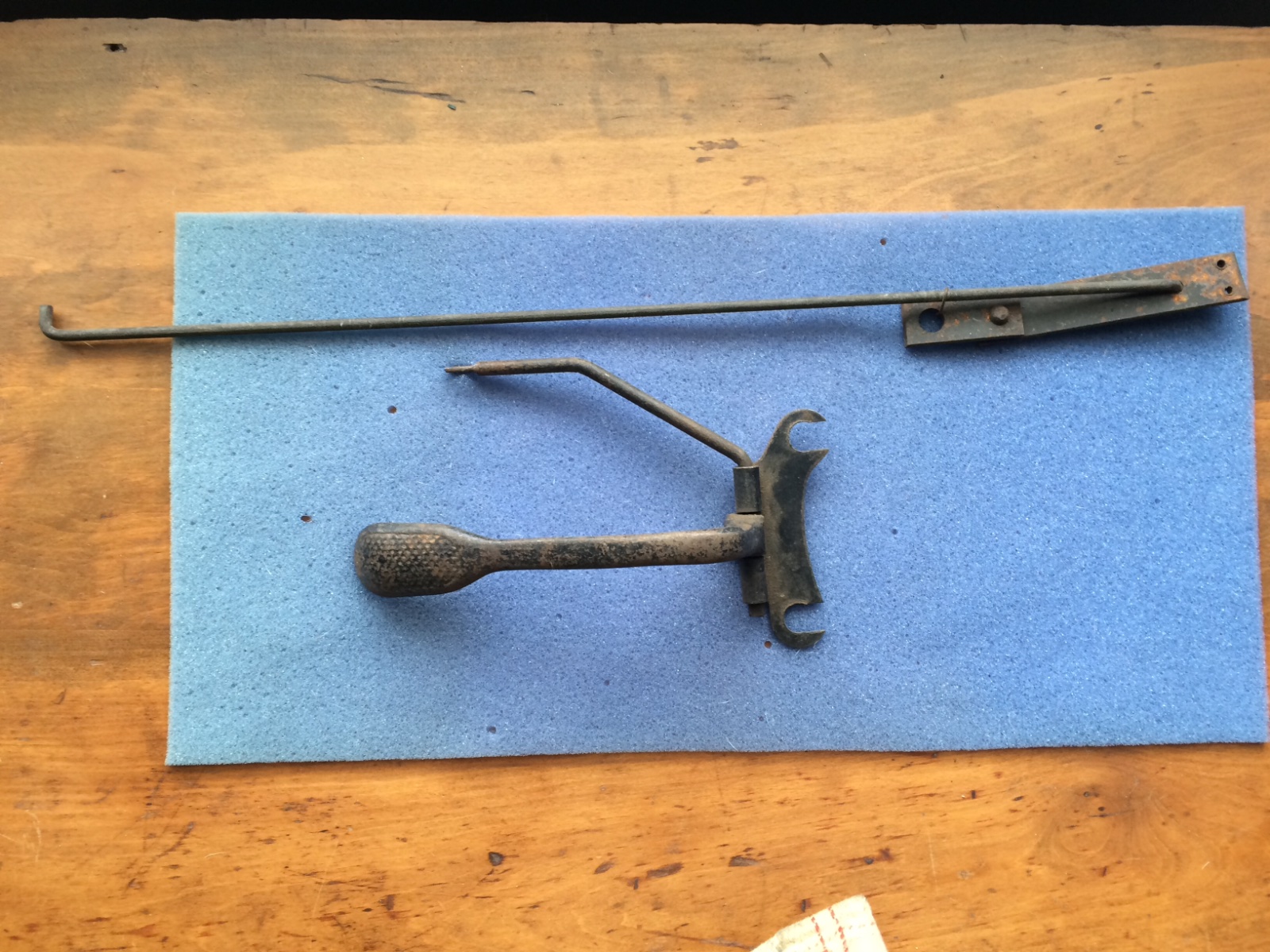

I have most of one Frank.
I had thought about using it and changed my mind.
I have the foot pedal and the rod assembly to the carburetor. I believe the parts that enable the hand throttle to be used with it are not there.
I will get a picture in a day or two and see if someone can id it.

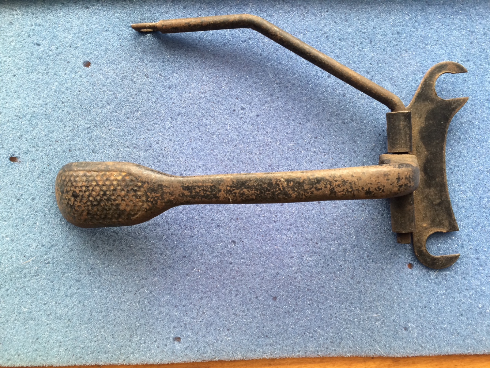

Re: foot throttle

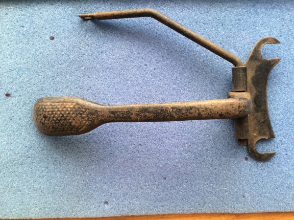

Sorry it took so long...rain all day yesterday and now about a 10 degree wind chill !!
But this is what I got.

Re: foot throttle

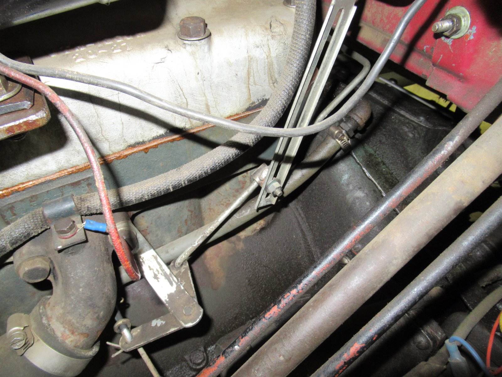

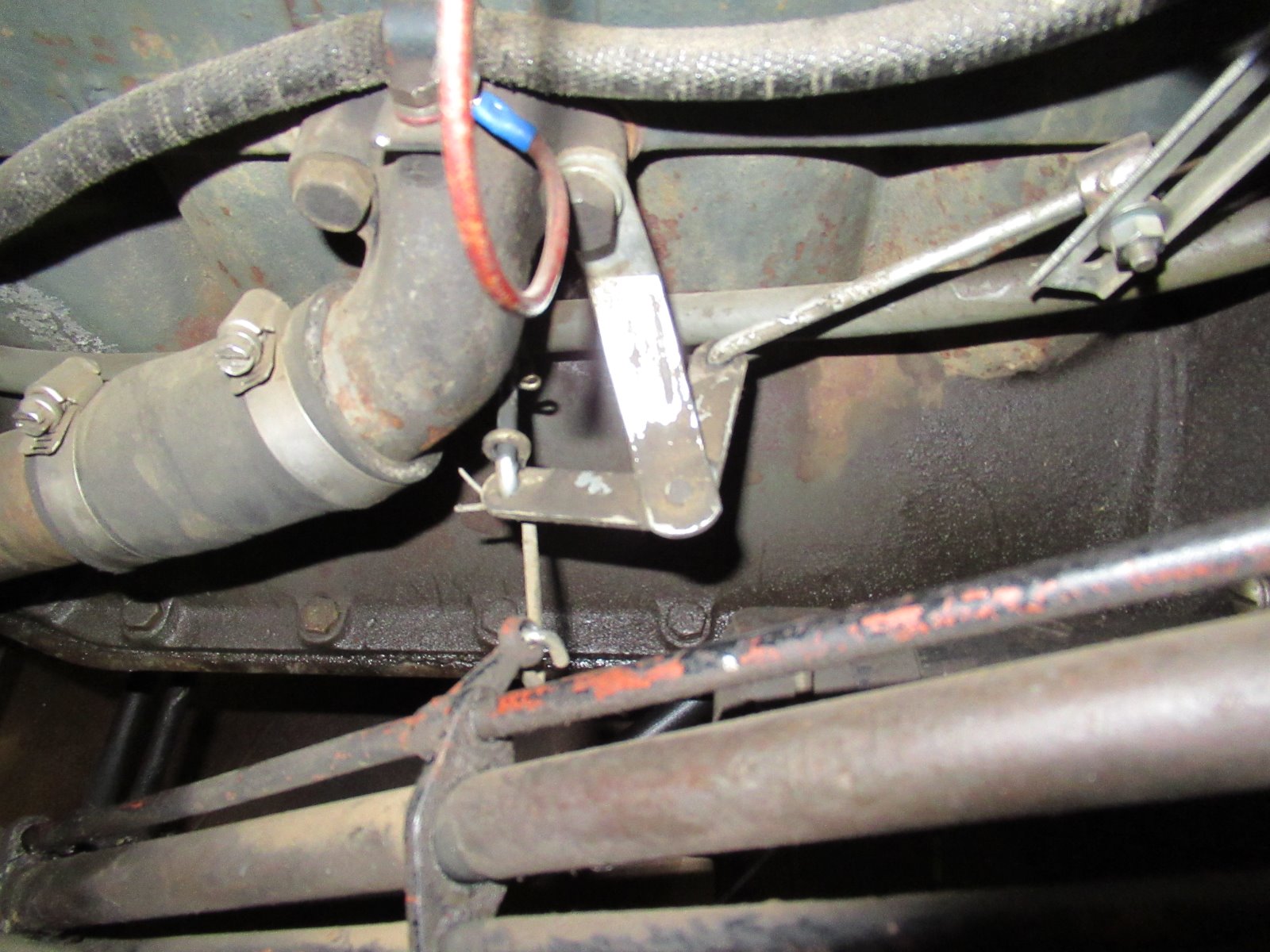

I found a foot pedal like that for my speedster. Mounted the bracket on the firewall and cut a slot in the floorboard for the arm to go through and connect to home made linkage to the carb. The pedal hangs down and I added a carriage bolt (head up) next to it as a foot rest so I can roll my foot sideways. Control without the foot peg on the side of the pedal is real tough on rough roads. No clue what my pedal was on originally, it was just an odd bit I found at a swap meet.

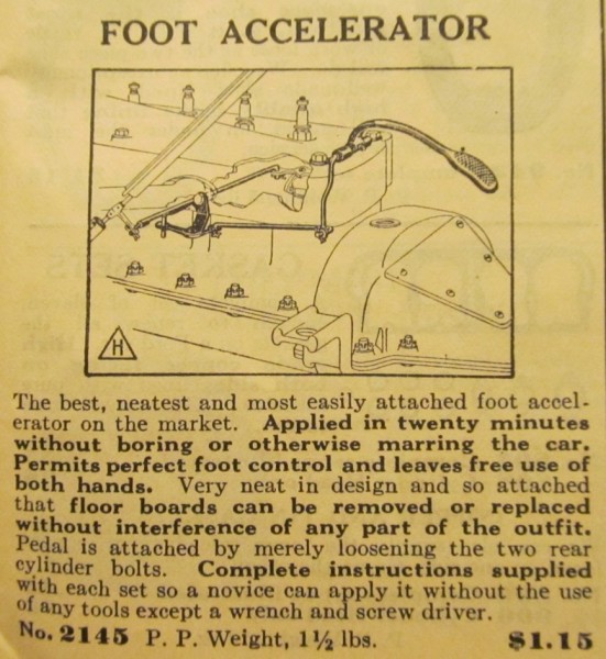

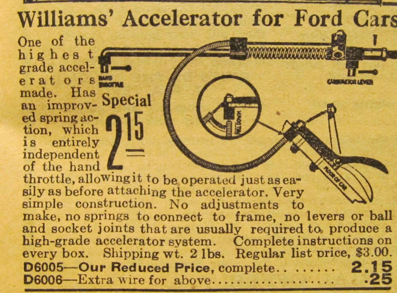

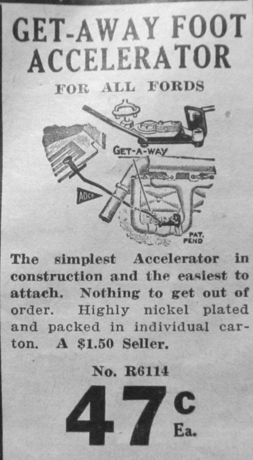

Here is period adv. for that cylinder head mounted foot accelerator.
Click to enlarge, 1920 Std. Auto Supply, Boston
The famous Williams used a modern for back then wire in a cable to pull the throttle, pretty cool as easy to buy choke cable at any auto parts store today. Have one of the pedals, but no hook up. Found this adv. for the Williams JR....this one is perhaps easy to refit, using a new cable, the existing Ford throttle rod to the carb, but a clamp on piece to it, and a length of spring to allow the Ford rod to retract easy went taking off your foot from the pedal....ah mmm, may try to work up a clip on thingy.
Regular Williams accelerator

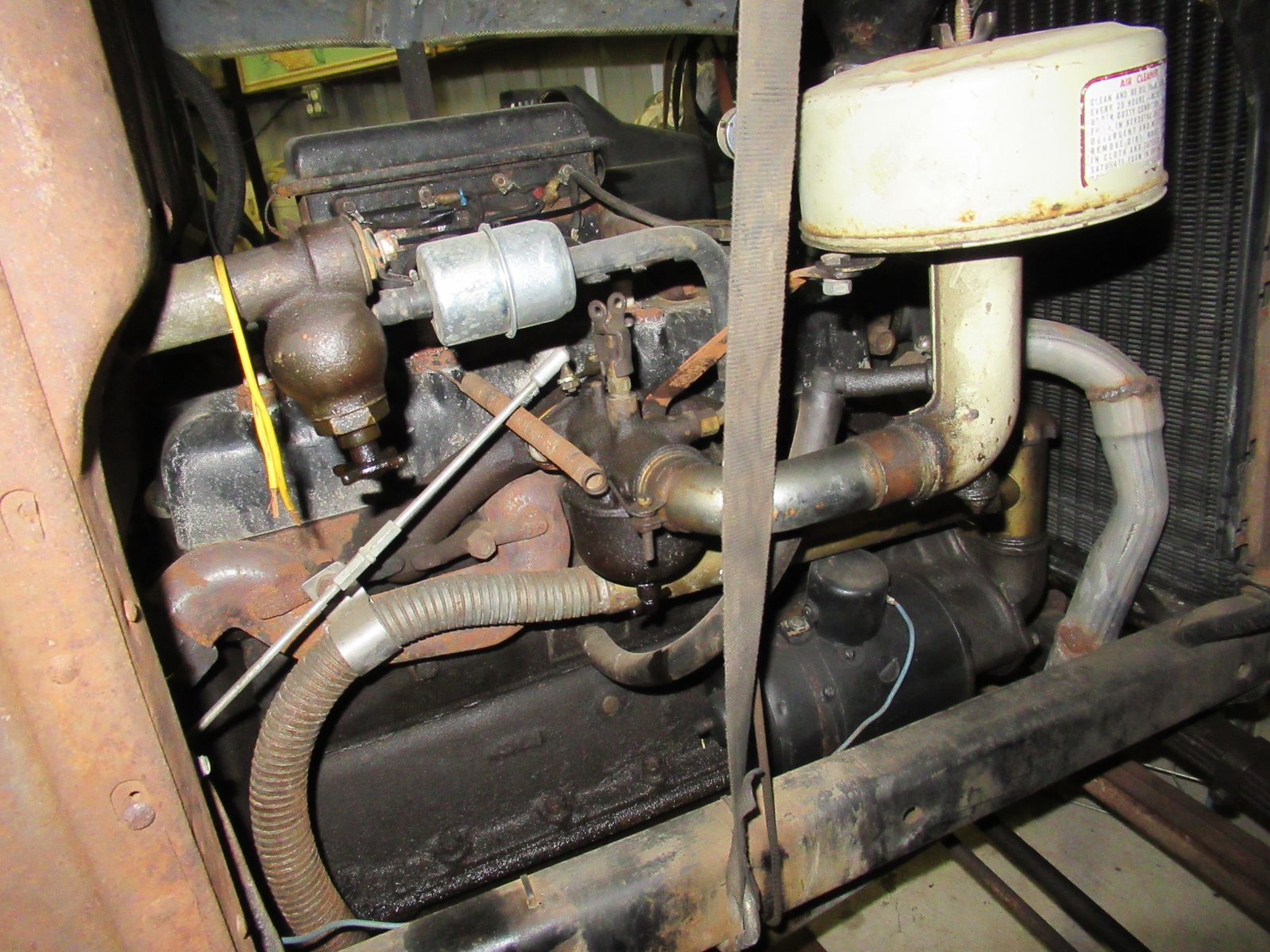

- Posts: 4090
Re: foot throttle

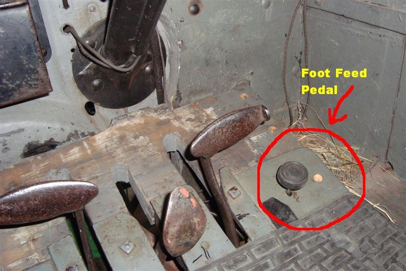

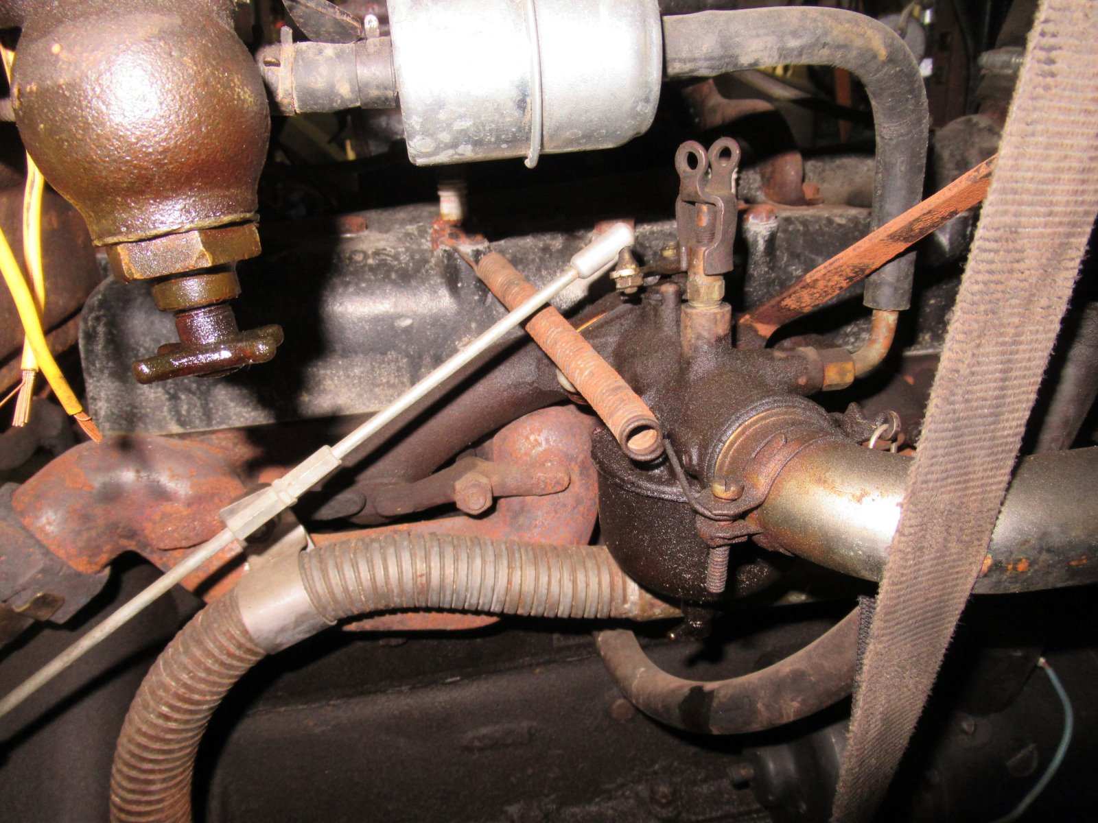

Here are a couple more style of 'foot feeds'

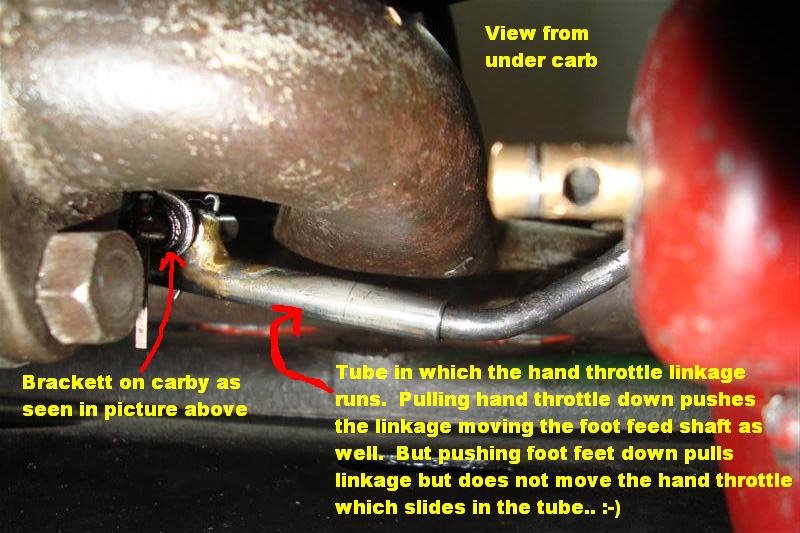

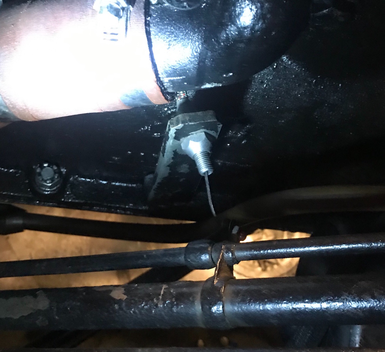

Re: foot throttle

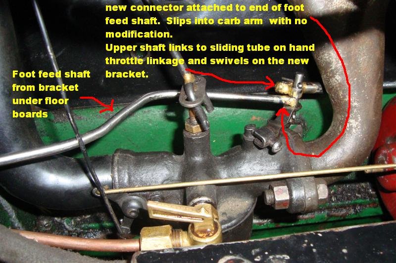

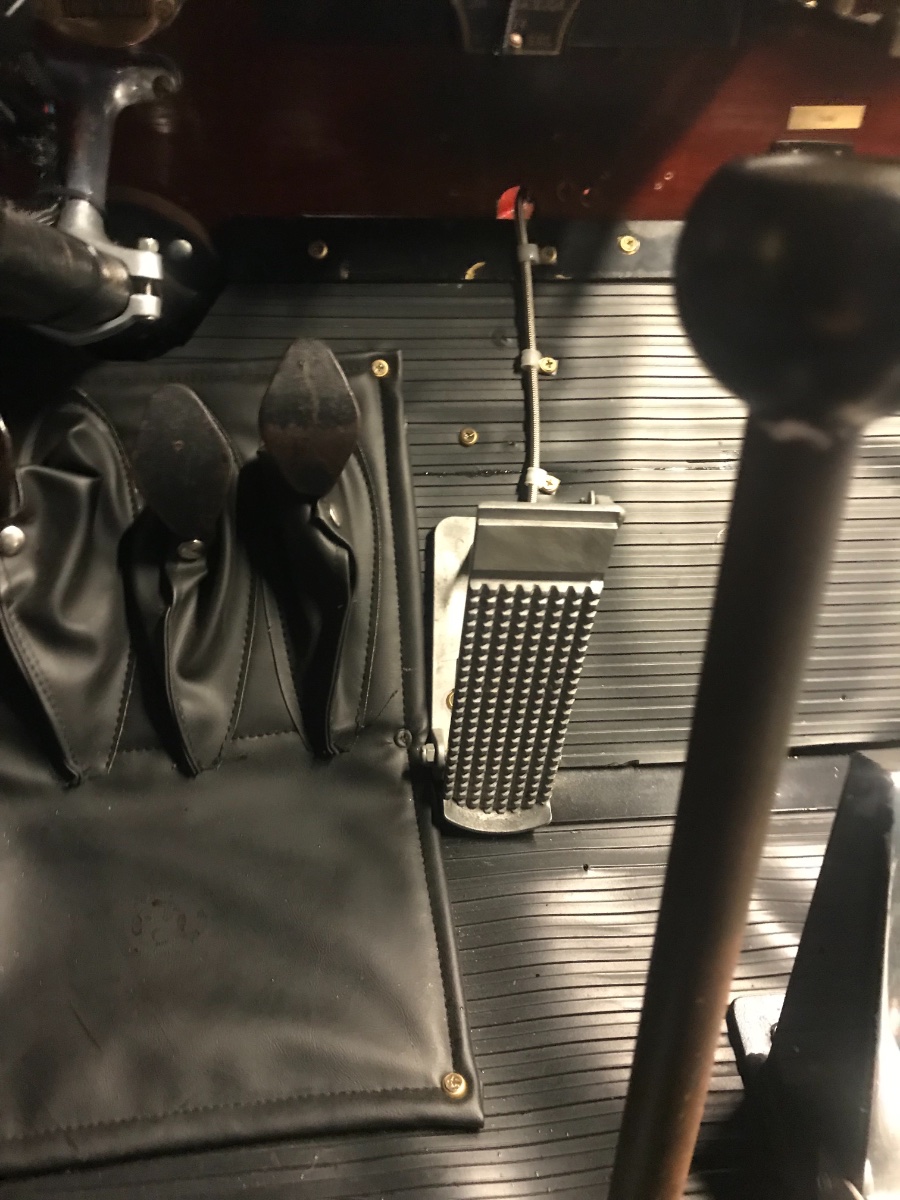

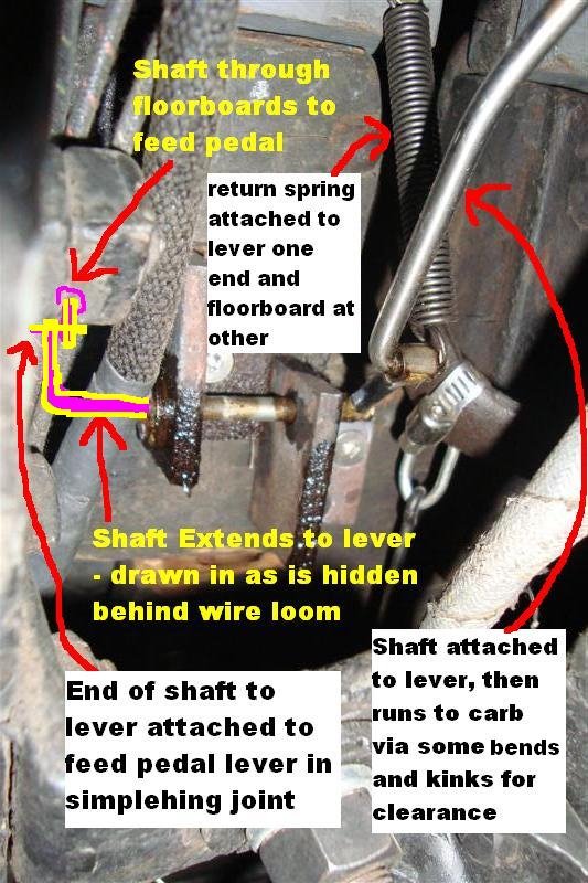

Mine may not be the prettiest, but it works allowing 'either/or' operation. You can use the footfeed or the hand throttle.
It is pretty much 100% home made (we just bought the pedal 'button'):

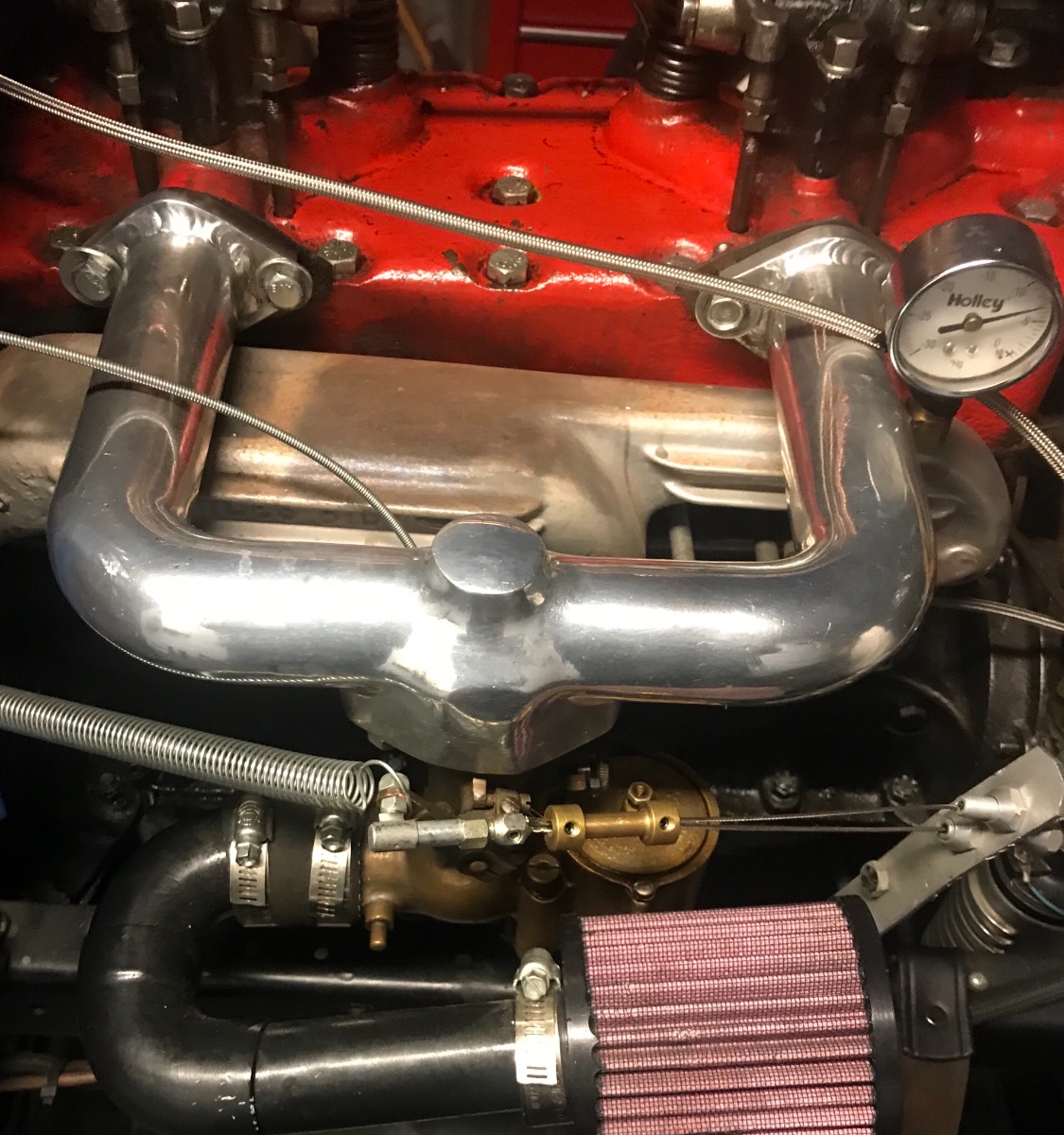

With the setup I’m presently using on my speedster : RAJO, warford,Dual exhaust manifold, Model A intake manifold, stromberg M-1 carburetor. I realized that linkage wasn’t going to work. I purchased the foot feed/gas pedal and throttle cables from Speedway Motors. I’m still able to use the original hand throttle along with the foot feed which comes in handy on my daily drives around San Diego ( weather pending)
