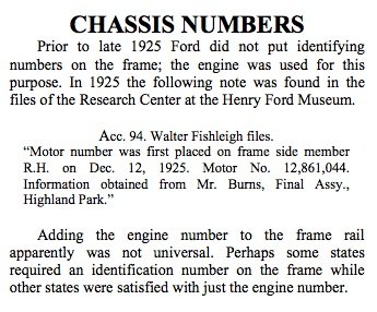

MTFCA Encyclopedia, go frame(chassis); frame numbers.
First was done on 12th oh December 1925 number was 12,861,044
Andre
Belgium

The officer is mistaken. Before the date Andre listed, 12th of December, 1925 (number 12,861,044) there was no Model T chassis number. The engine serial number was used for identification to register a car. If the officer wants internet confirmation, show him this excerpt from the Model T Encyclopedia.

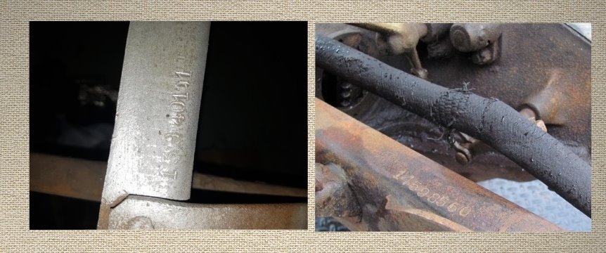

One reason you haven't found the engine number stamped on your frame could be that the car was made before December 12. The 1926 model year begins with August. If the car was made December 12 or later, look on the left frame rail. Occasionally the number was stamped on that side.

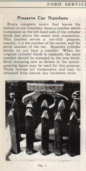

And those chassis numbers only on the Improved Car (1926 model year) are just replication of the 'real' vehicle identification number, namely the engine motor / car serial number.
Ref. Ford Service Bulletin, April 1, 1919.
FYI, on the Improved Car, sometimes that replication number is found on the driver's top frame rail as alternate location from the more normal passenger side.

I once had the opportunity to inspect the frame number on a 1927 touring. The first two digits were 1 and 5, followed by 6 zeros. We were checking to see if the frame number and engine number matched.
(They did.)

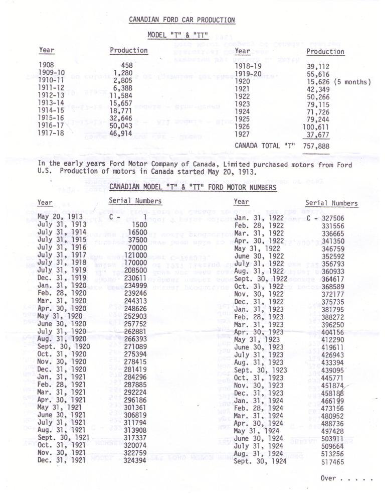

This 27 Roadster I have now has a Canadian registration number. Is there a data base to find info on the Canadian cars? Thanks

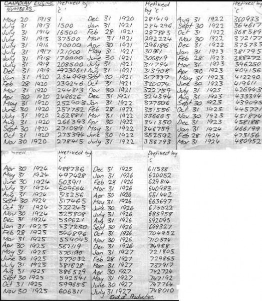

I had a similar problem with my Canadian 26 touring car. It was registered with a fictitious No MT9999. I just assuming that it was Model T 9999. The engine had been changed to a 1925. After talking to the boys on the forum, I looked on the frame , right hand side under the floor boards and there it was. So when going to register it here in Nevada, I was wanting the title to reflect the right number. Nevada DMV said that if Canada would sign off on it in writing, they would change it. I called Canadian DMV (if they call it that) and they said sure just bring it up so they could inspect it. #@&^**$#@%% I called ADOT DMV ( Arizona, we have a second house there) and told them my situation, they said bring it in and they would look at it. All went well, 20 minutes later I was walking out with title and registration in hand reflecting the proper numbers.
It deffinately makes a difference where you are and who you talk to.
- Posts: 4090
Re: Model T Chassis or Frame Number
Here is a chart that was placed on the Forum a few years ago with Canadian engine number sequence.
and total car/truck production
Thanks Dan, You are probably one of the guys that helped me.
