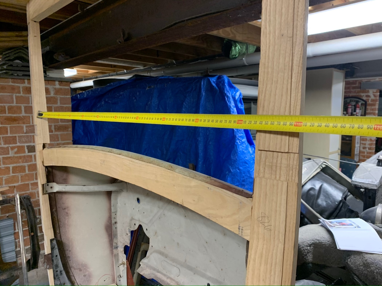

Hi All
I am hoping somebody can please measure the internal distance between the two a pillar posts at the windscreen frame level. As per picture
Thank you
Andrew

Post by TMiller6 » Sun May 24, 2020 9:46 am
I measured 40.38”. (102.5 cm) at that point on mine. It has Cubel replacement wood and is a ‘26. If that seems large, Remember there are two steel filler pieces that go between the frame and the posts.
Tom Miller

Thanks Thomas
I think I will just have to work with fitting the windscreen frame to it
Cheers
