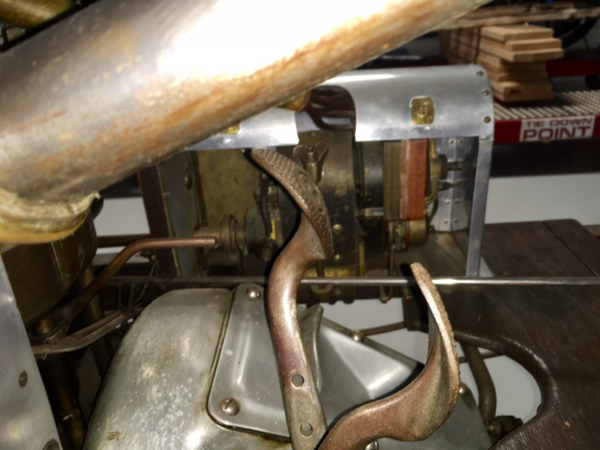

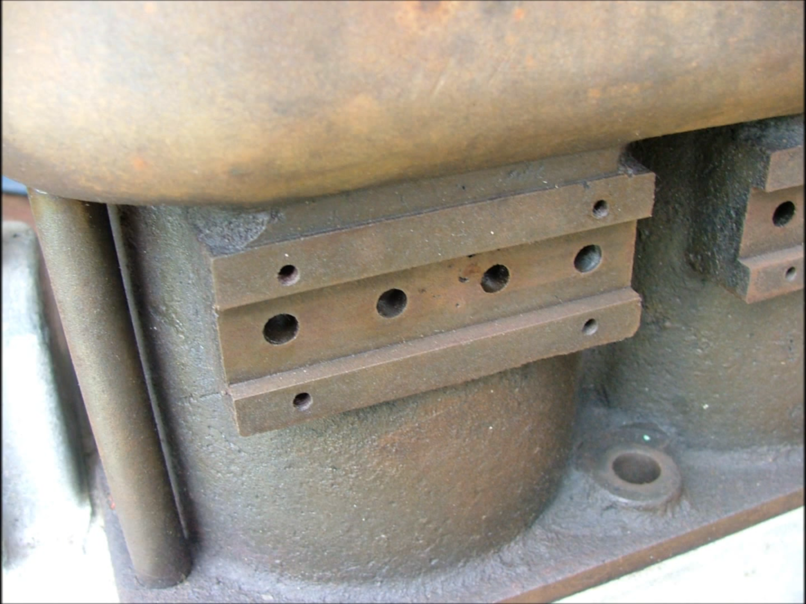

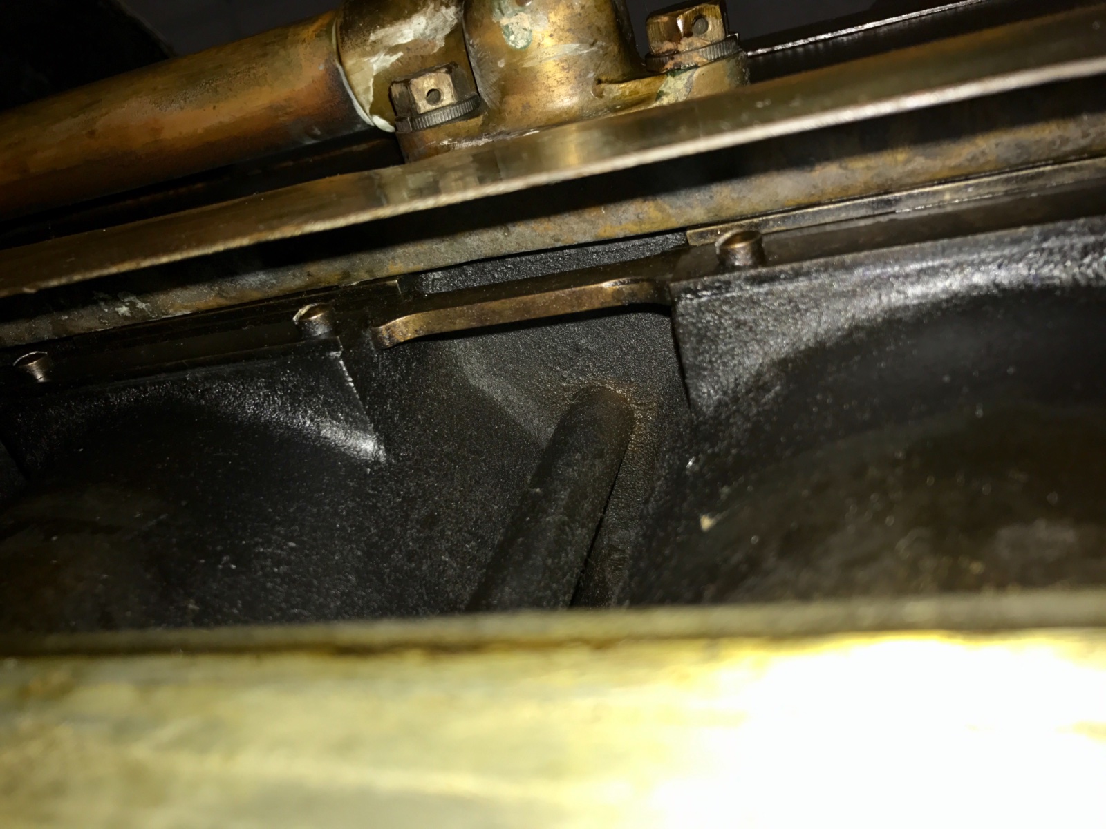

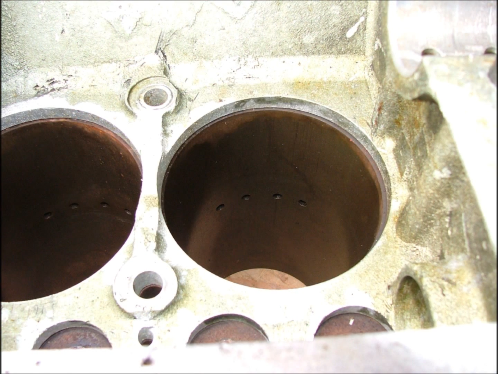

Has anyone seen any motors with similar holes in the cylinder wall? The Ford Special race at The Henry Ford, as well as our motor, have holes in the side of the cylinder wall, on the non exhaust side. THF racer motor has heavy steel rails, and a sliding slide with four corresponding holes:

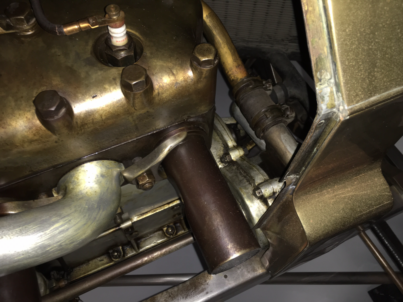

There is a deflector shield over the slide and holes:

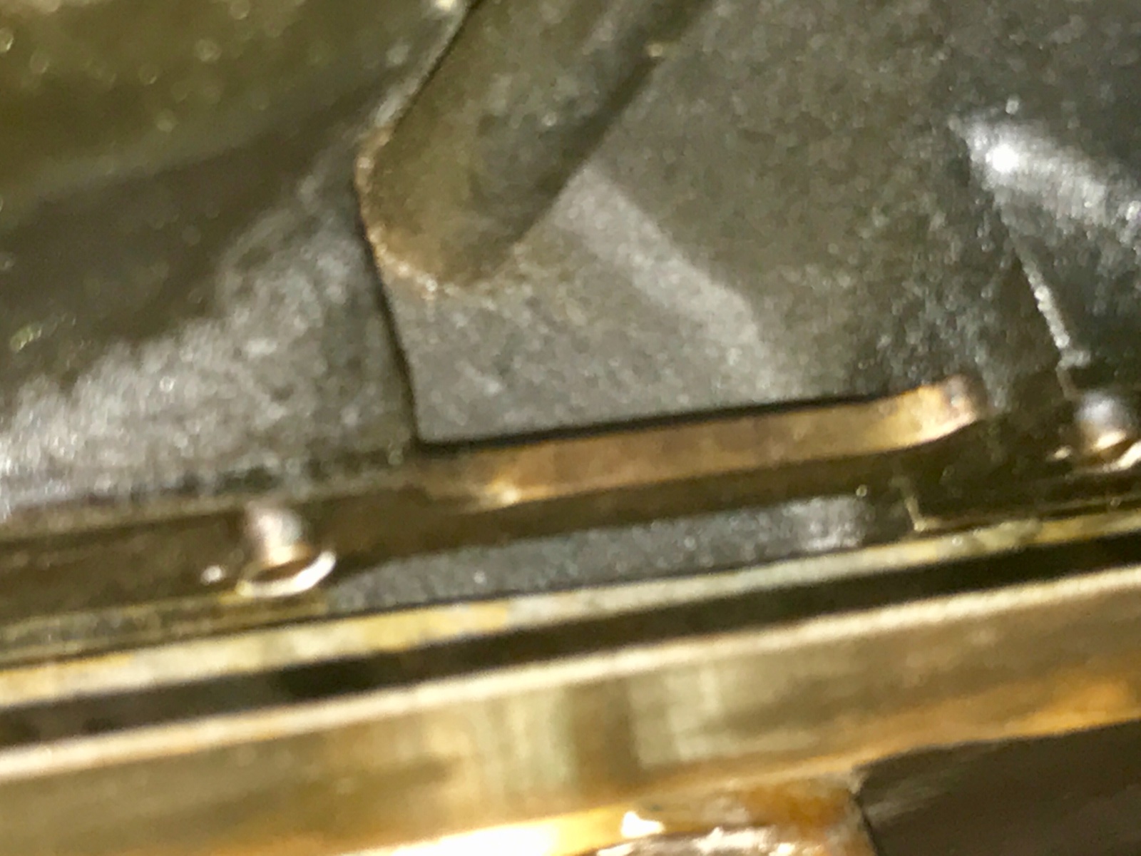

It looks as if the slide was controlled by pushing (by hand or foot) this rod, that then pivots and moves the slide, either to open or close the four holes by matching up with the holes in the slide:
It looks to me like this was a one time thing. There is no spring, and if you are operating this lever by foot, there would be no simple way to bring it back.

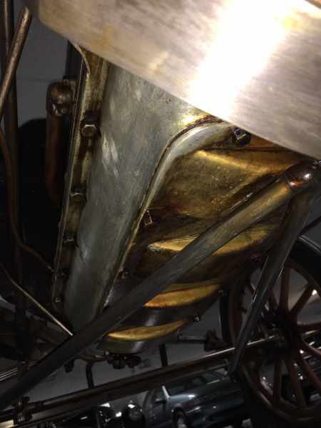

Below is the slide as it appears between the deflector and where the pivot rod meets it (firewall):
I have a Ford drawing of the oil filler cap, which is similar to a T, except it isn't a breather cap. It's solid. That tells me there is no other breather on this car, except possible these holes in the cylinder wall.

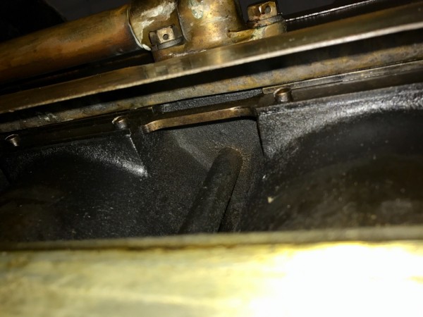

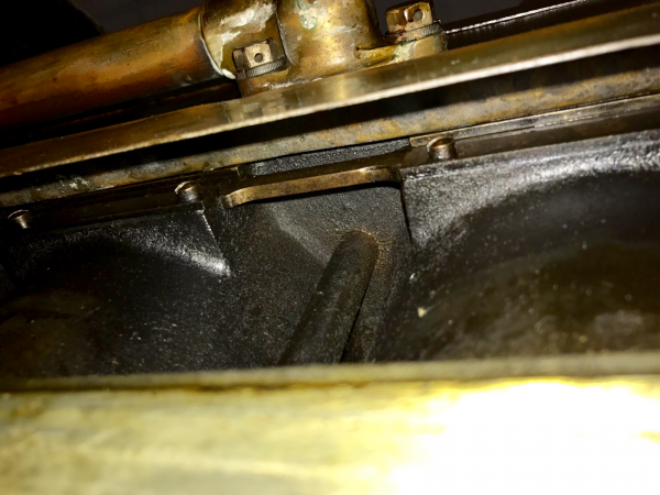

Continued:
These are views of the slide from the bottom of the motor at THF. There is carbon around the area, indicating to me the slide was open, at least some of the time while the car was running:

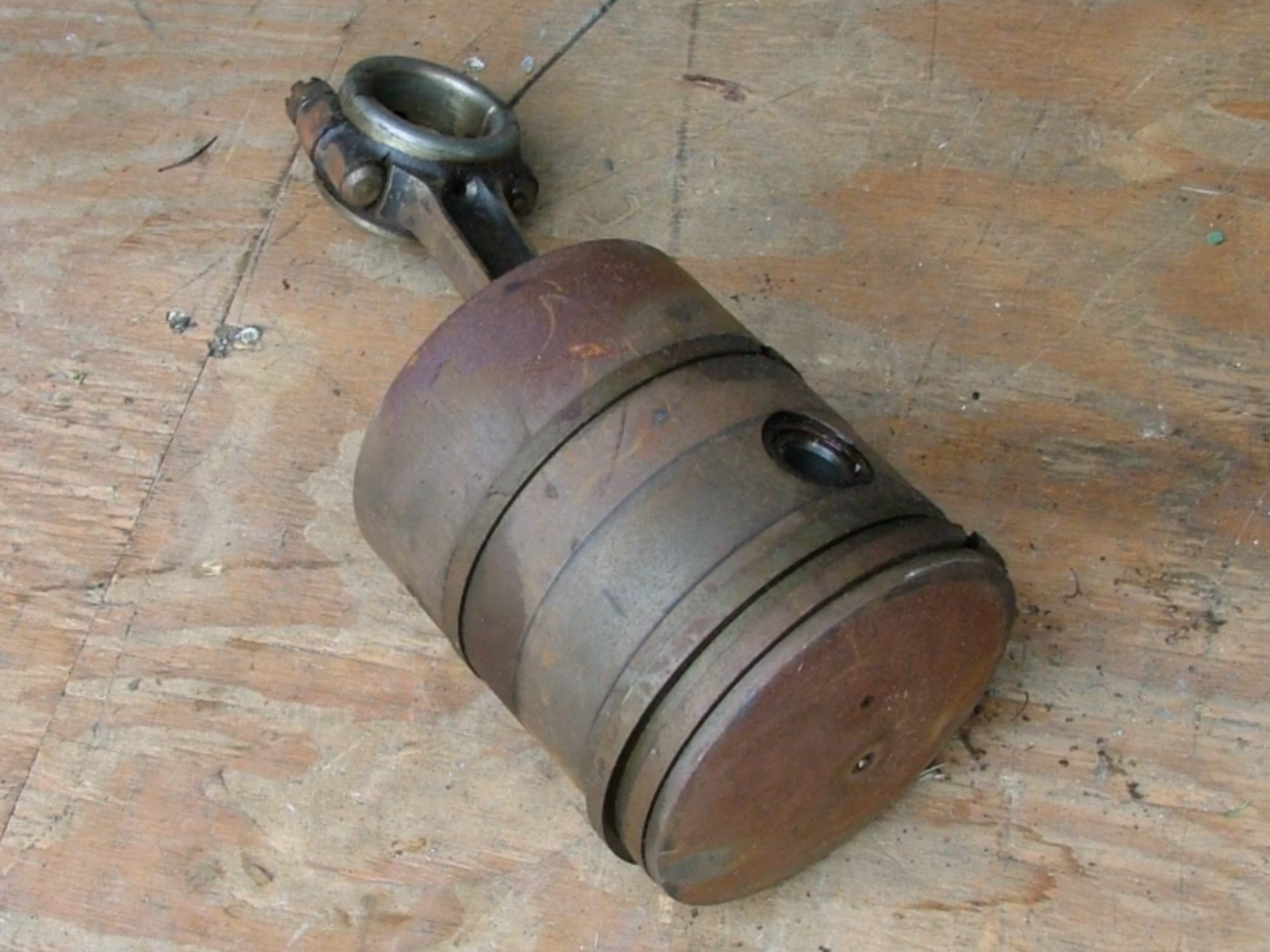

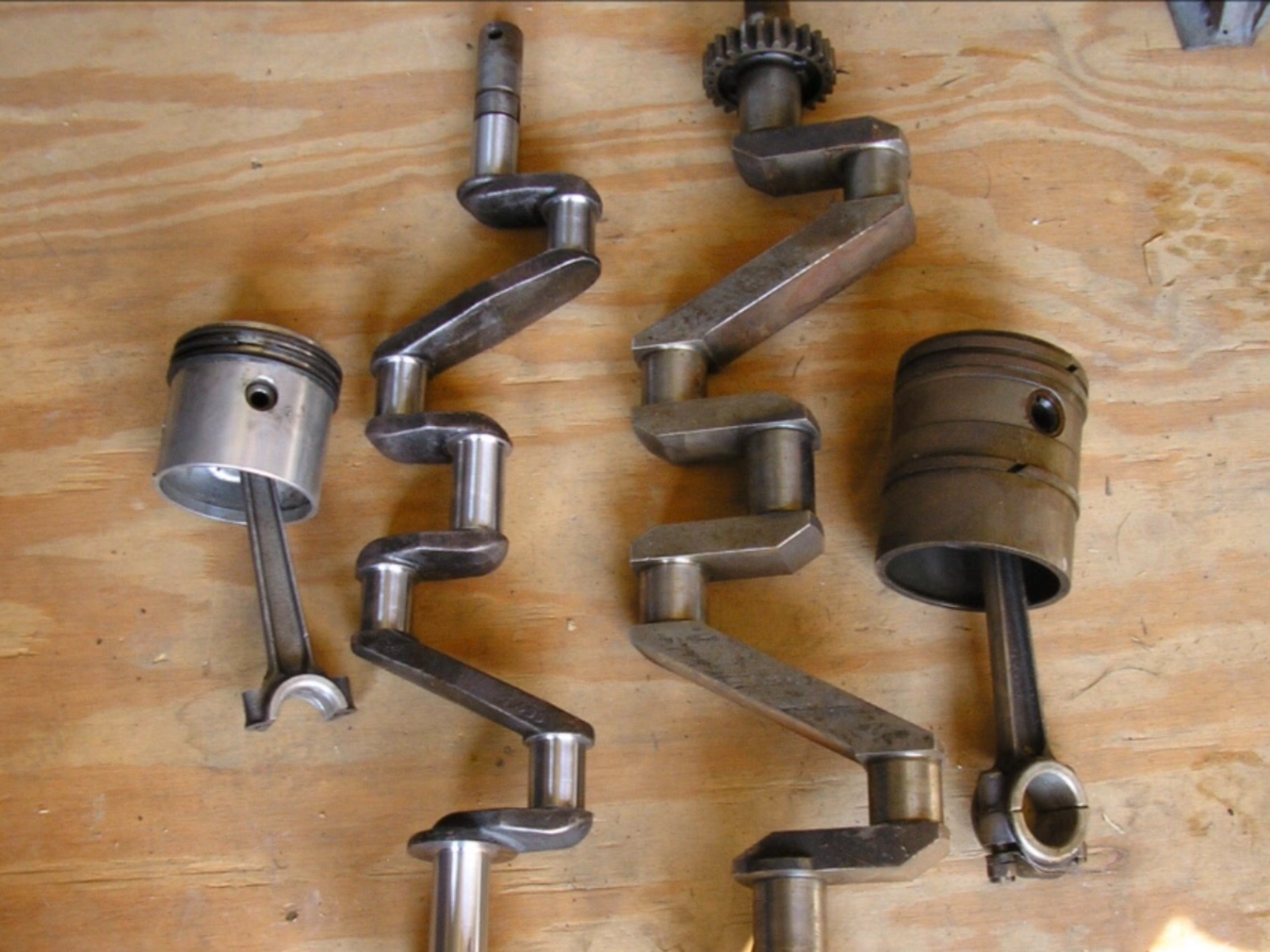

Below is an original piston. It seems to me the holes probably are always below the top two rings, and below the bottom ring:
If these are simply breather holes, why the slide? When would a person want the holes closed? Would a person start the engine with the holes closed, then open when increasing rpm? The mains on these motors are pressurized, so I assume they were a higher rpm motor than a T. Lastly, I've found no Ford patents for this system. Ford was good about procuring patents whenever they built something different. Was this used on other motors? Is this at all similar to the ports in 2 cycle motors?

Looks to me to be a de-compressor for crank starting, once fired up kick it shut.
Posts: 6804
Re: What are these holes in the cylinder wall of a Ford Special motor?
Post by Scott_Conger » Mon Feb 11, 2019 5:20 pm
I would tend to agree with Kerry. That's what I thought before I got to his post. Odd that there are so many holes and only cuts off one ring out of the compression stroke. I initially thought it would be an oiler feature prior to start up but I cannot contrive a convincing argument for that.

Hmmmm, a compression release could be a logical explanation. I have had 4 stroke motorcycles with large bores, high compression and no electric start. You simply could not kick start one of these without the compression release. That said it would need to seal completely or you would have compression loss. On the motorcycles the compression release valve is held closed by compression because the valve projects inside the combustion chamber. This is a very interesting topic.

Thanks guys. Would there be much compression loss by the third ring? How does this motor breath of not through these holes?

It could be similar to the same idea used in air compressors. As in air compressors there is a momentary release of compression upon starting to get the compressor up to speed without having to start under a load.
Opening up the holes would help in turning the engine over for easier cranking then closing them up when the engine is running.

Compression increases when it gets behind the rings, maybe taking the 3rd out of the equation is enough to able an easier start?
as for a crankcase breather, mmm, blocking the breathing off completely would push oil out of every place it could, front and back of the crank seals if it has any? up the bores valves, you name it, it would be smokey the bear when running! :D

I'm thinking,...either additional scavenging of exhaust at high rpm, as the four holes look as though they are low enough to be just barely cleared by the top piston ring at bottom of stroke, or, maybe this engine was designed to have "wet" cylinder liners installed, and the four holes per cylinder are to allow for additional coolent to cool the "wet" liners,.....???

I don't think I have much to offer on this. I have thought about it a fair amount since those holes were first shown on the old forum a year or two ago. For the life of me, I can't think of a really good reason for this. The only thing that comes to mind is that they were still in the early years of figuring out knowledge that we take for granted. It may have been some theoretically proposed idea tried and found pointless then forgotten.
If those holes are in fact always below the top two rings? They would have virtually no effect on compression or intake.
For this next part, I will throw around some VERY rough numbers. Consider, a reasonably well fitting piston, will provide about 80 percent of compression and/or intake/power etc, even with NO rings installed. This at running speeds, which is why compression testing drops off much faster at starter speeds. The significantly slower motion allows the leakage more TIME to leak down and give low readings. An engine without ANY rings installed can actually run reasonably well if brought up to a near running speed to start it.
With only one ring installed (per cylinder), any one of the three, provided there were no other compression losses, extreme wear on the cylinders, bad valves, head gasket etc, you could probably even crank start the engine. Any ONE ring on each piston would bring the running compression up to probably 90 percent of normal for a broken-in fresh engine. Although the ring nearest the wrist pin would likely guide the piston most smoothly and run longer before it broke something.
A second ring, any position, would bring running compression up to almost the full normal amount. The holes between the upper two and lower one ring would have almost no effect on the engine's compression.
I don't know if it was Murray Fahnestock or not, but years ago, I read articles written back in the day that many racing engines were run with only one or two rings installed. They did this, and recommended this, because at racing speeds, there was so little effect on the compression, but they theorized the drag on the cylinders was reduced enough to give a few more rpm and a bit more horsepower (that belief is disputed to this day, and I have never read a definitive study either way, lots of opinions, but few applicable facts).
If the holes are in fact below the top two rings at all times, but above the bottom ring only when the piston is in the lower part of its stroke, and below the bottom ring when the piston is in its upper part of its stroke? It would vent the crankcase somewhat. The holes appear to be fairly small, so they would limit the venting somewhat even when opened. The whole thing COULD be an attempt to control the venting, maybe a controlled "total loss" oiling system if there is no other venting of the crankcase. Vertical position would determine the duration of venting, and whether there is any crossover between the two pair of cylinders doing the venting.
The holes being below the top two rings, it cannot in any way be a compression relief for starting. Even venting the crankcase would make virtually no difference there.
I do suspect it was an idea tried, found not really beneficial, and not used much. Soon forgotten. I still haven't figured out exactly WHAT they were trying to accomplish.
I do suspect, that whatever they were trying to do, it probably needed more than a simple one-way slide foot control. whether a friction-hold hand control? Or levers that push and pull? Or springs somewhere? There had to be a bit more to it. I may be that there just isn't enough left of it to figure exactly what it did have, or do.
You might consider replicating some missing pieces from the other car at the HF just for appearances. Run it either closed with the crankcase vented, or open for venting, as long as there is not a compelling reason to leave the crankcase pressurized like many total loss oiling systems did need to be. You say the mains were pressure fed? How was the oil applied? Pressurized? Pumped? That could be important.
Other than that? I don't really know what else to do unless you do find something really definitive about just what this was.

I would say that it definitely is exhaust or intake ports. Two stroke motors have ports similar. My best guess is for supercharging.

So long as those holes are continually covered by pistion and are kept contained within the middle and lowest ring, I don't see how it is for either intake nor exhaust. In any event if it was exhaust, the edges of the holes would be burnt if the engine had any time on this last build. My belief in it being some sort of compression relief is in the expectation that by opening the slide, you are effectively removing one ring from the 3 which would relieve compression some amount, though I would not suppose to suggest by how much.
All opinion and conjecture, of course.

Can't see it being a inlet or exhaust port of any sort like a 2 stroke, the piston doen't look like the travel will go low enough to exspose the combustion chamber to the holes.

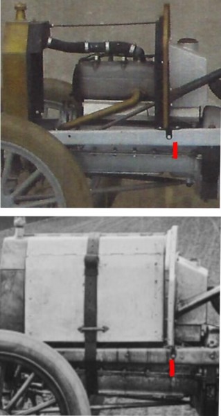

Rob

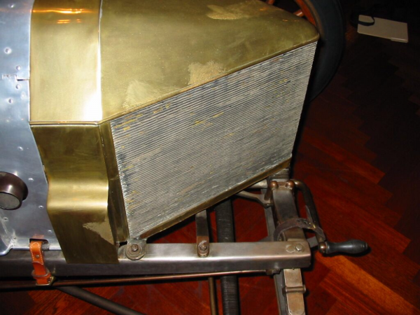

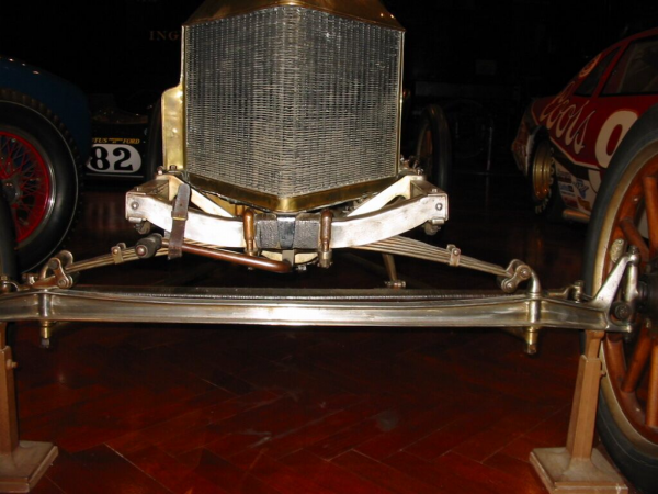

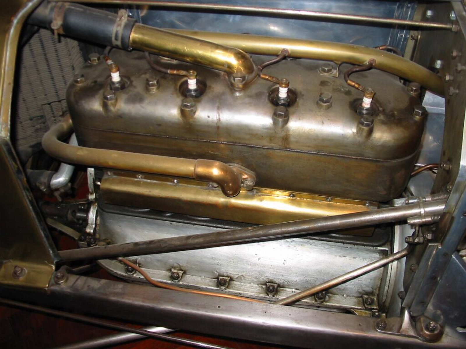

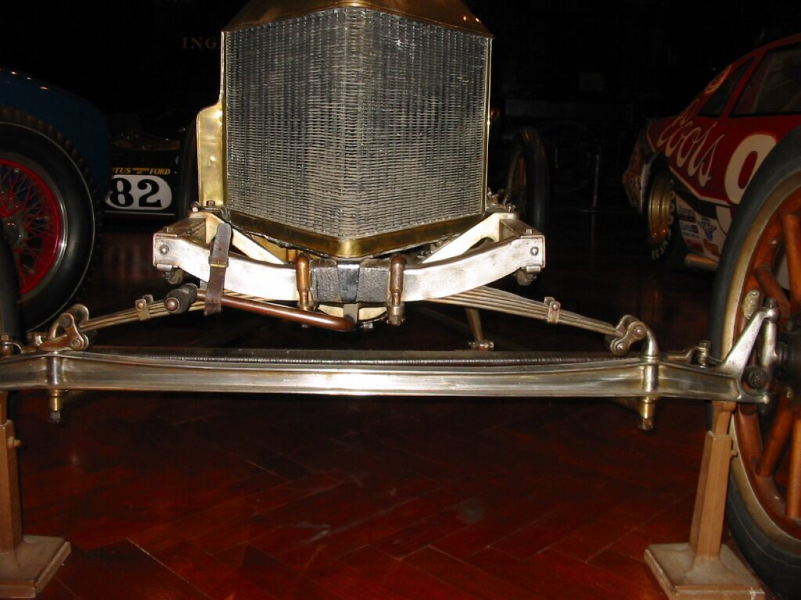

Looking at the Ford museum racer picture, seems the brass tube plumbing from the cover goes up front to the oil cap.
So might just be a mist oiling system to keep the cylinders lubed at high speeds. The holes are small and you noted evidence of carbon (oil burn).
The complete cover can then close off those cylinder holes if driver thinks sufficient smoke from the exhaust tells him to.
Kerry
Posts: 1464
Last Name: van Ekeren
Post by Kerry » Tue Feb 12, 2019 1:23 am
Dan, I was thinking that was a water pipe, might need some clarification on that, Rob?

Rob, My take is that the four holes in the cylinder bore bleed off the blowby that has past the upper piston rings on the down power stroke. That exhaust gas would be near oil free (just like exhaust gas) and would not make a mess. You would then not need a crankcase breather. Regards....Neil M.

Thanks guys. I should have clarified, the plumbing that almost looks like it takes gas/mist from the deflector is actually the water pipe and inlet into the water jackets (not related). I'm not sure, but I believe the holes are situated so the top rings nor bottom ring pass below or above them (holes). Here is a video of the late Vic Zannis running the motor for the first time, about four years ago. He wasn't sure what the holes were for either, and blocked them off.
https://youtu.be/-oSrOZ4Zfo0

Rob is it possibe to find out exactly where the piston is in relation to the holes? I'm questionong their use if they are not totally un covered at some point.
Rob
Posts: 1595
First Name: Rob
Last Name: Heyen
Location: Eastern Nebraska
Post by Rob » Tue Feb 12, 2019 6:52 am
I'll call Peter Fawcett this morning and see if they can tell how high and low the piston (and rings) pass. The stroke is 5 inches, so I'm thinking the piston must pass beyond at least one of the three sets of rings?

Posts: 4090
Post by DanTreace » Tue Feb 12, 2019 7:40 pm
Rob
One more thought, found this in The Automobile, 1910 in article on aeroplane engines!
Maybe the Ford Special used these holes to help reduce temp. in the cylinders, claims made that more power is made at higher speeds.

If so, then there's still an issue or question of crank case pressure when completely shut off. :?: if no sign of a venter of some sort, it just can't be left to build up, it will pop a cork some place.
Rob

Rob, good find by Dan, it seems logical IF the ports are cleared by the top of the piston on the down stroke.
From the pictures i can't determine if that is the case.
Another line of thought came to me last night, from working on early cars a lot my experience is they tend to like a lot of gasoline when cold and combined with cast iron pistons, rings and large bores, that results in considerable blowby when cold, which leads to dilution of the oil.
Could it be that the ports are there to get rid of (most of) the blowby when the engine is warming up, and kick it shut as soon as it is at working temperatures ? that would explain there is no return spring on the system, of course it would only work if the holes are positioned to always stay clear (above) the lower piston ring....
Really curious about how it runs !

As far as the piston not opening the ports, It may have been designed with different pistons and changed after it didn't do as expected.

Well guys, Peter unblocked the holes, and it made cranking quite a bit easier (and it was a load before). He said the piston top does drop below the holes on the downstroke and the piston skirt goes just above it on the upstroke. What I don't know is if these pistons are as deep, long as the originals. So we know they help with cranking. Evidently Ford designers had enough compression built in to need to release the compression. I guess I know the holes are on the two big racer motors, but don't know about the other three or four smaller displacement racers. I also don't know if there would ever be an reason to open the ports while running, but I suspect you would close them ASAP to avoid an oil bath.
Thanks for you help and ideas,

Rob that clears at least some of the mystery, so it does both, help with scavenging and relieving cranck case pressure.
In a way working as some kind of decompression device, at least when the slide is open. all with the pistons you have in it now.
The only way to tell if it was configured like this from the start is if you manage to dig up the original drawings.

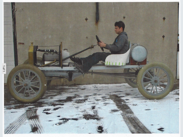

Wayne, I forgot to answer your question. That's Peter's son in the seat. They operate a third generation restoration shop outside Toronto.
We were exchanging pics trying to determine why the motor wasn't situated like the original photo. We determined the Ford Special had a longer hood to help hide the motor by placing the firewall two inches farther back on the chassis. This split photo shows how the last pan bolt is directly under the firewall in the original Kulick pic, while it's two inches forward on the re-created chassis. Problem solved (and now being corrected with a Torpedo hood and moving the firewall rearward:

I think all the suggestions were right. This youtube video of Ted Davis' original 1911 Franklin (Leno's Garage segment) racer. As Jay and Ted explain, Franklin used an auxiliary exhaust port at the bottom of each cylinder to evacuate up to 80% of exhaust. The racer has two large main exhaust pipes along with six smaller pipes coming from the bottom of each cylinder. I don't know if they had some type of automatic or mechanical valve system, or were just open ported like the Ford racer.
https://youtu.be/5f_vUbzh5l8
From what I've read, the advantages of ports just above the piston top at the bottom of the stroke were twofold, providing compression release when cranking, and reducing temps while driving at high rpm.
Maybe the way to use this is open on start, closed at idle and normal running, then open at speed?

Post by Rob » Fri Feb 15, 2019 7:44 am
Howard, I noticed that the radius rod is under the axle on the last racer. When I've looked at pics before, it appears that was the only one with the RR underneath. I recall seeing a story that Henry Ford, after an accident with a T, was told by one of his close employees about the benefit of securing the RR under the axle, but that it still took years and many Ts before the change was made.
Wayne, I'll try to get a few basic measurements from Peter on the dimensions of the motor. A few T to racer motor part comparisons:

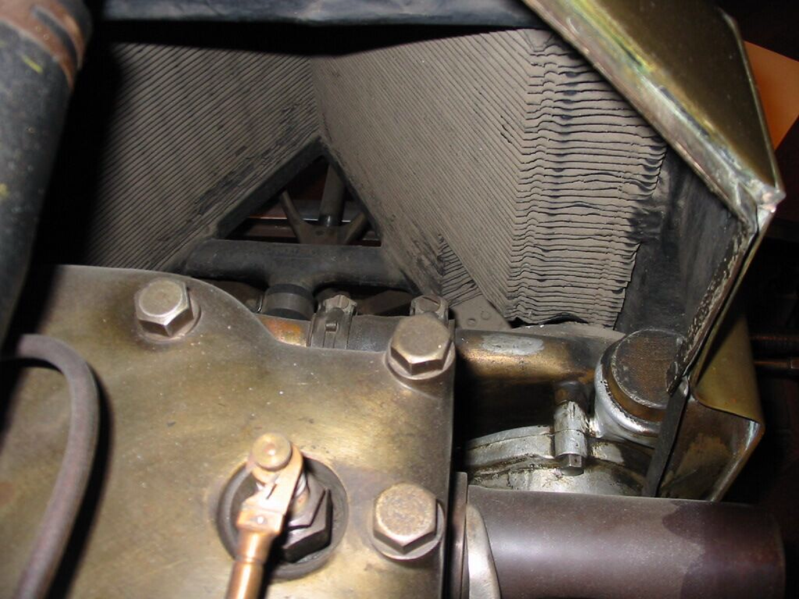

A few pics of the 410 cu. in. racer V nose radiator. Notice the solid oil filler cap, and how the radaitor had to have a "bulge" to allow room for the filler cap and cam/gear drive cover:

Presuming the slides area have some type of shield/deflector, when the pistons go below the port on the intake stroke, the air it pulls back in will be somewhat exhaust rich, not "fresh" air completely. This would make the system also a primitive Exhaust Gas Recirculation (EGR) system, similar to the early designs introduced in the 1970's. The purpose of EGR is to introduce a small amount of exhaust into the intake system to slow the flame propagation within the cylinder and prevent spark knock (pinging) so that more advanced timing can be used with lower octane fuels. So, opening those slides would also allow more advanced timing, and more power as a result. Introducing the somewhat cooler air directly to the top of the piston as it starts the compression stroke would also help control detonation as well. So, you are not only helping get rid of exhaust, you are helping prevent spark knock, and allowing more advanced timing for more power. Makes you wonder if the engineers understood the EGR principal or if it was just an unintended side bonus?
Rob
Posts: 1595
First Name: Rob
Last Name: Heyen
Post by Rob » Sat Feb 16, 2019 10:13 am
This is a photo taken from underneath the Ford Special at The Henry Ford. It was obvious from carbon around the ports and shield that the ports were run in the open position a portion of the time. It's amazing to think this is the same seat Frank Kulick occupied when he beat the 200 hp blitzen Benz at the Michigan State Fairgrounds in the summer of 1911:
Shield, just below the water inlet:
Lowering the mile track record to 50 seconds from a standing start. In 1907 Frank Kulick went through the fence and was severely injured attempting to break the world mile record of 52.5 seconds, from a moving start with the six cylinder racer:
