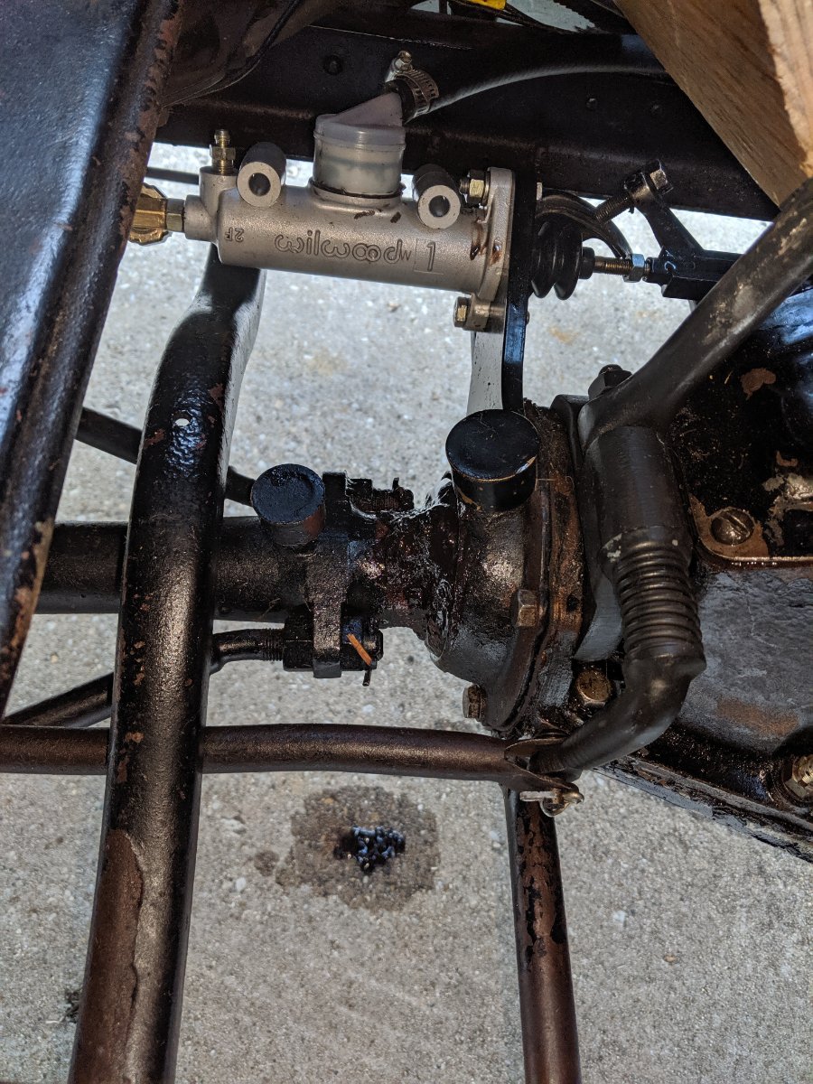

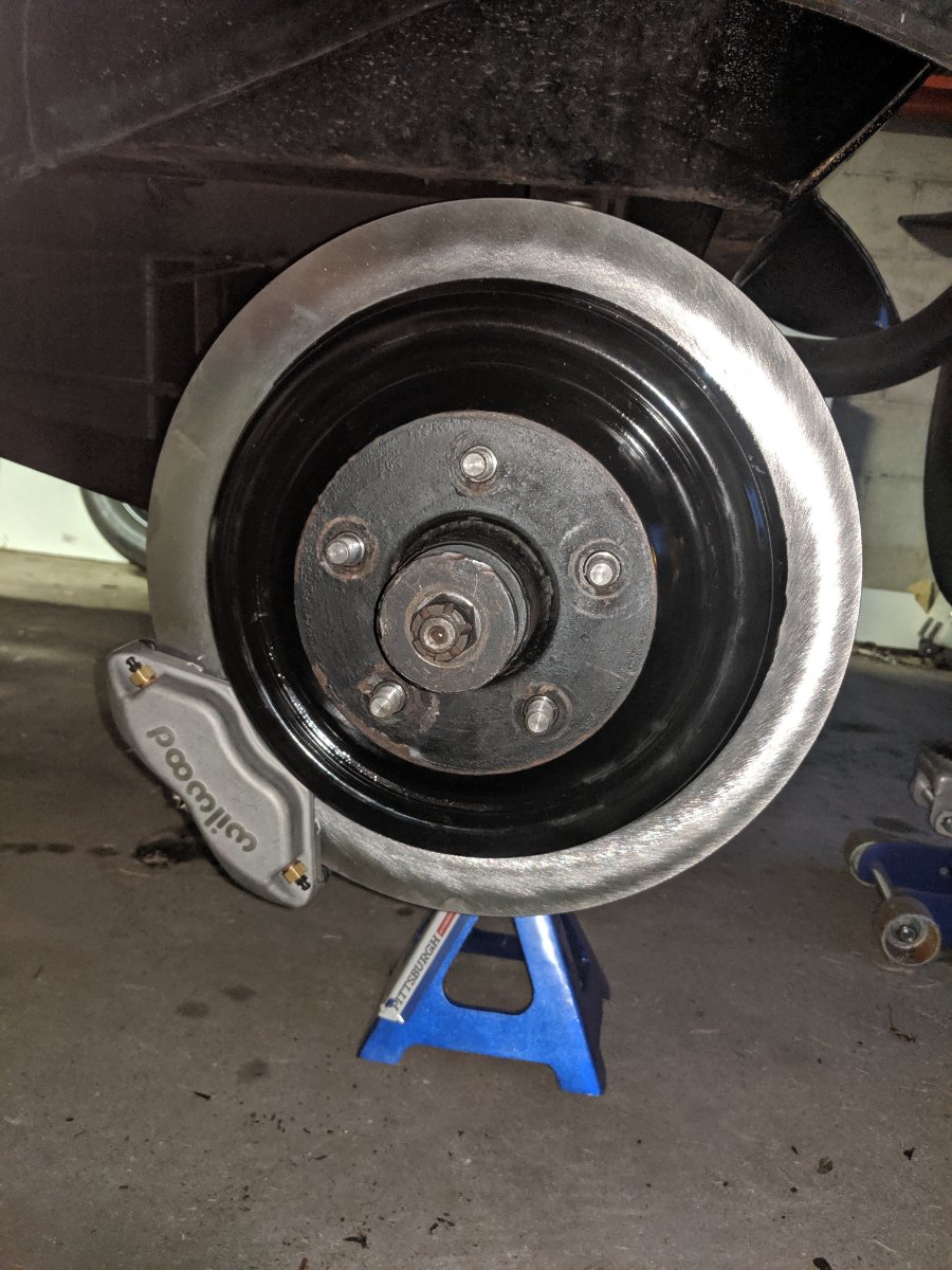

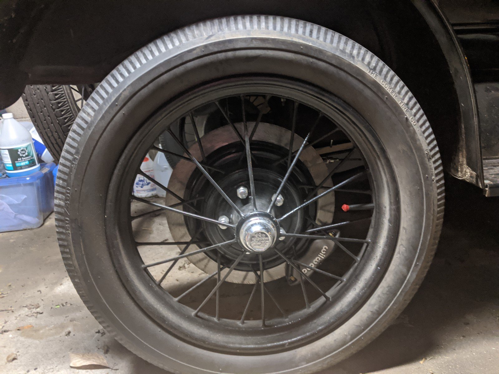

I installed the Sure-Stop hydraulic disc brakes from Texas T Parts (other distributors sell them as well) last summer and I couldn't be happier.
My 23ish Touring has a Ruckstell but only had the transmission brake so I had to do something. The price for the Rocky Mtn Brakes and the hydraulic brakes were comparable.
I live in Joliet, Illinois which has a number of drawbridges and associated hills, and often a LOT of traffic. Those things made me choose the hydraulic brakes; I sometimes have to stop on a pretty steep incline and I didn't want the worry of not being able to stop on a back roll
I have wire wheels so the discs are slightly less noticeable than with wood wheels. In fact have to point out the disc brakes every time a non-T person has admired the car. They just don't seem to notice.
I understand the inclination to maintain the car as period correct as possible, I just don't see the point of settling for a less reliable braking system on anything other than a brass era trailer queen or the like. I'm not taking that unnecessary risk to keep my $7,500 23 Touring period correct.
Damn thing already has a distributor anyhow.
