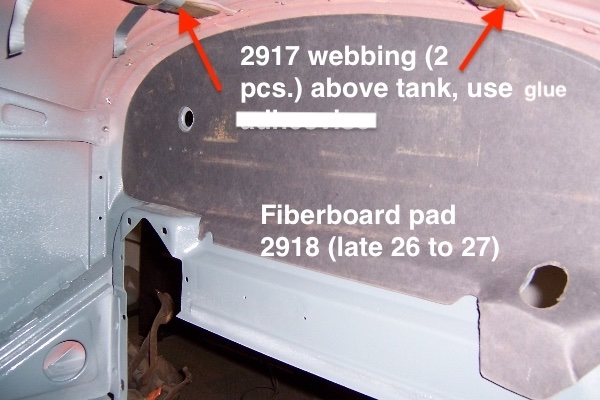

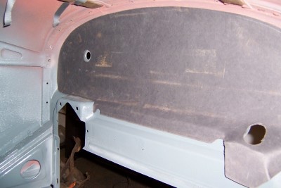

That molded fiberboard gas tank insulator for the '27 cars is a very nice reproduction, fits fine. The earlier Improved Car just used two strips of webbing that were riveted at 4 places to the cowl. You can tell if you car is later, as those tiny 4 holes will be missing from the upper face of the cowl.

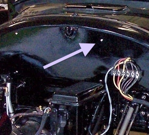

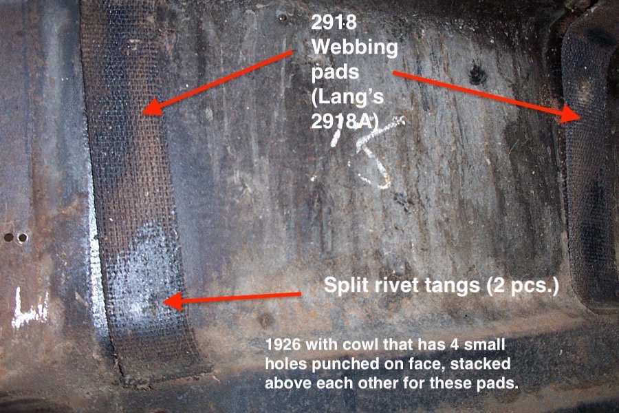

These should help you, pieces for all but Fordor:
All '26-'27 used webbing pads above the tank.
Only some '26 used webbing pads behind the tank. You can tell by holes punched in the cowl face for these pair of pads.

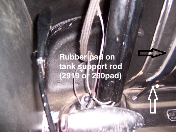

All used the rubber insulator strips on the support rods that hold the tank in place.

Looks like I have the holes, and rivets are still there
So I can now say I have a 26 - not a 26/27? :D
