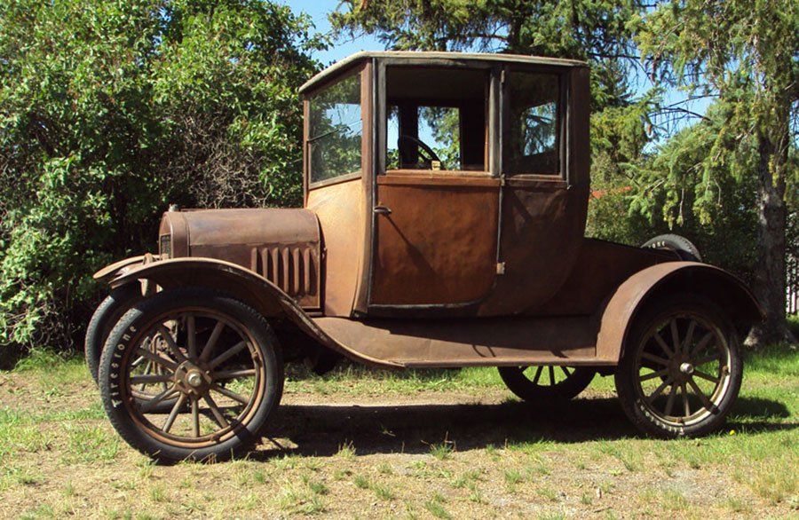

I'm sure you want something faster than this. I daubed a little paint on and sprinkled my new coupe door with water and added salt. Patina is usually uneven rather than a solid color like paint is. New rust is brighter than old rust so it didn't match but that may not matter that much.

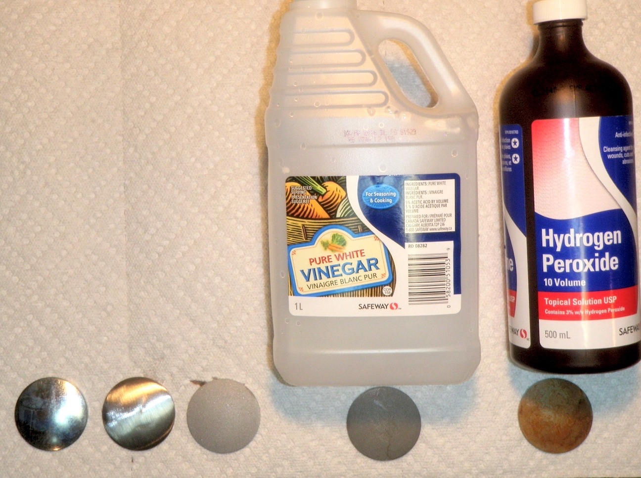

Procedure to patinate plated core plugs for a rebuilt-but-doesn't-look-it engine...
0. As purchased
1. Sanding belt
2. Sandblast
3. Vinegar wash
4. Peroxide wash
Steps 1 and 2 were necessitated by the pre-existing galvanizing. Step 4 took just a few seconds.
0. As purchased
1. Sanding belt
2. Sandblast
3. Vinegar wash
4. Peroxide wash

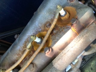

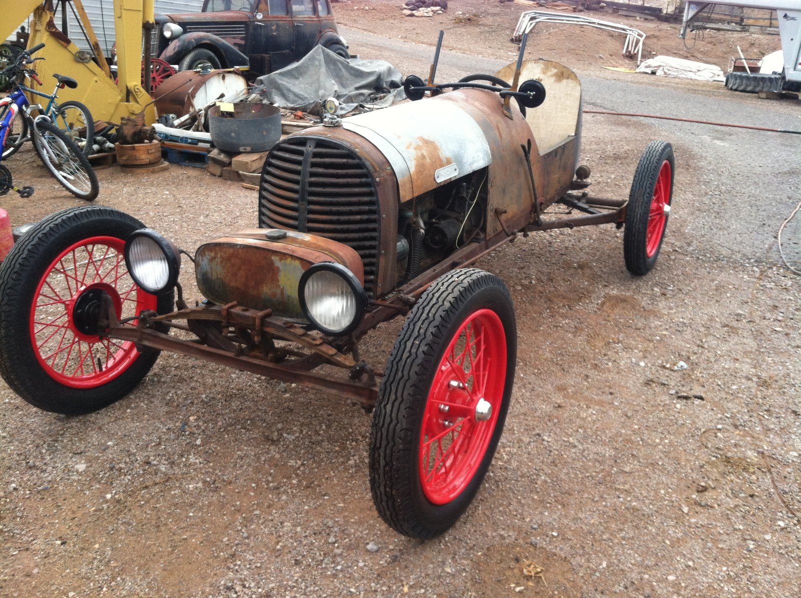

Natural “patination” in progress here. Heavy rains the past couple of days, apparently the hood hinge leaks like a sieve ! No doubt the spark plug wells were full of water when I cranked ‘er up this morning - I never thought about it. I’m a little surprised the plugs weren’t shorted out by all that water. Six miles later everything is nice and dry. New rust is the prettiest shade of orange !
- Attachments
- 70A2BCCD-82E5-4CA3-8112-D5570A06224E.jpeg (29.93 KiB) Viewed 5589 times
"Get a horse !"
