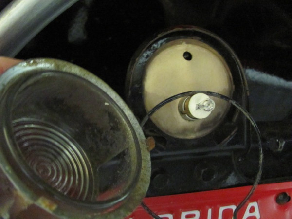

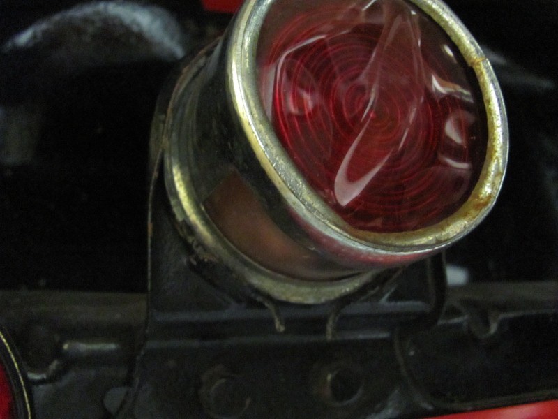

The halogen bulb won't hurt the cardboard in a '24-'27 tail lamp.
But after a longer nite travel, sure did warp the plastic lens over the glass tea cup

- Posts: 4045
Re: Halogen Tail Lites
Mark, yes single contact ,think it was Langs # 6H-20 , 6v 20 watt. No markings as the halogen is potted in ceramic, and I thru away the package.
My guess is its one of the 120 lumen type, or approx. 12 candle power?
Lang's doesn't list C.P. It was a bunch brighter than the typical incandescent #63 tail lamp bulbs.
