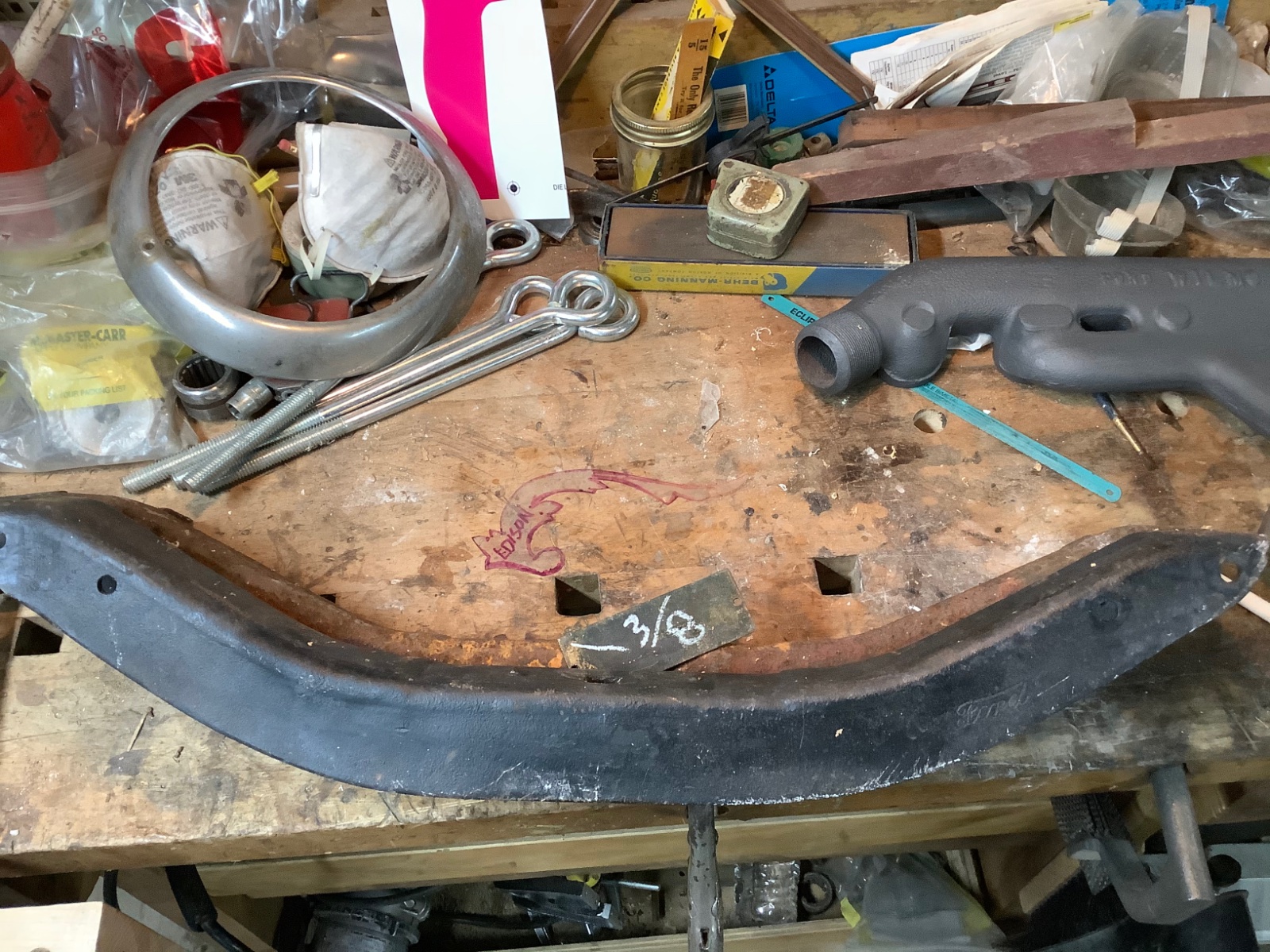

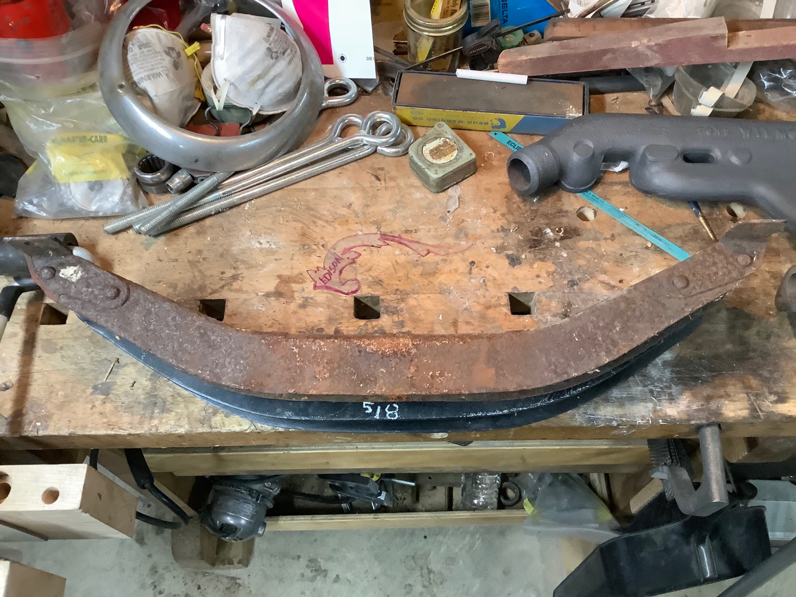

Another thread is discussing a front valance, so maybe someone can tell me what this crossmember is for. I’m pretty sure the rusty one is TT truck. As you can see, the black one is about 3/8” lower at the engine mounting point. It has a large ford script, so later, but car or truck,or.....

I did a forum search here are some highlights which you may have already found
https://mtfca.com/phpBB3/viewtopic.php? ... ers#p78848
From the encyclopedia:
Beginning about March 19, 1919, the “Ford” logo began to be imprinted on the front cross member.
Beginning in June 1920 the front cross-member was made of heavier steel.
The front cross member on the '26 and '27 Ts are different from the '25 and earlier frames. They are made to accommodate the '26-'27 front fender irons.
https://mtfca.com/phpBB3/viewtopic.php? ... ber#p99388

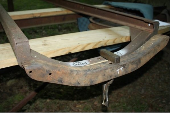

Talks about the radiator apron differences with picture of TT compared to a T
