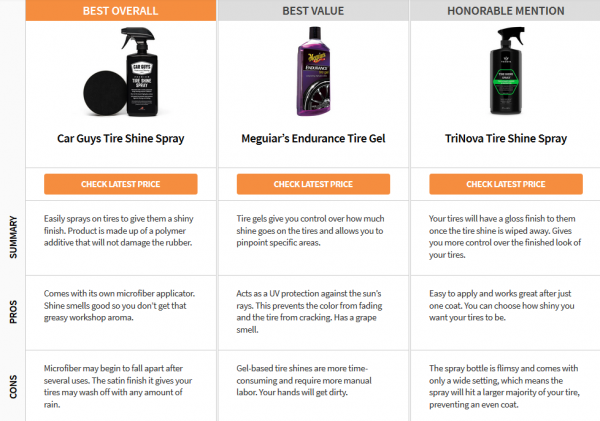

Great question - My immediate thought was for UV protection - I have used several products but only one lasted. So I did a bit of research to see what I might buy. To plagiarize several websites. I'm sure that there are many good products available in this space

Found a review om 3 products. I'd buy Meguires based on the Pro's and Con's
