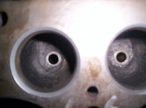

tore into the engine in my '23 center door yesterday and today, and was disappointed to find the condition of the seats, valves and guides.
The valves are already "second oversize", which is advertised as .342". In measuring the non-wearing areas above and below the guide contact area, my valves were .3400" to .3404".
the guides measured .3437" to .3448" in the centers, bellmouthing notwithstanding
I searched for a stem-to-guide clearance spec for Model T, and didn't find one, so using a generic .001" to .003" - all the guides are out of spec for .340" valves. They'd be juuust at the limits if the valves were truly .342"
I've read a bunch of old posts about using 1.50" head diameter / .341" stem diameter Chebby valves, so my question is :
anybody ever go to oversize stem Chebby valves ? If I use a .344" stem, I can ream the guides to .346" Should be good for a long time, and then at the next rebuild I'd have to do liners or full guides.

as a follow up - I spoke with Steve at Lang's today - new 1/32" over T valves are .340" stem diameter. It is the GUIDE that would be .342", not the valve.
