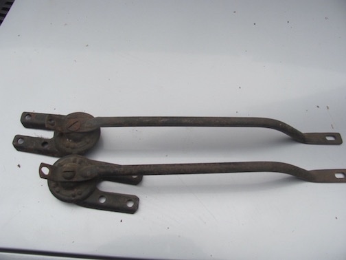

in classified, I list a pair of 1914 windshield supports and hinges.
- Attachments
- IMG_4853.jpg (34.76 KiB) Viewed 3931 times
