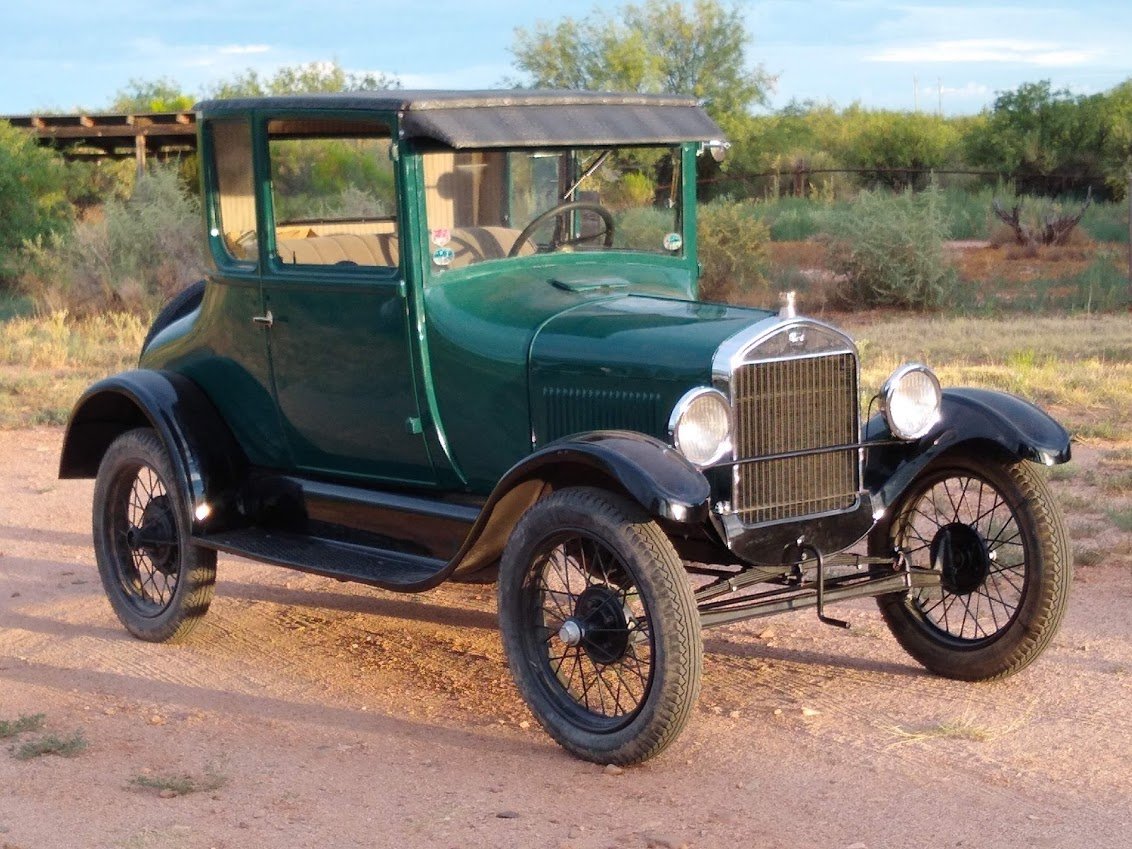

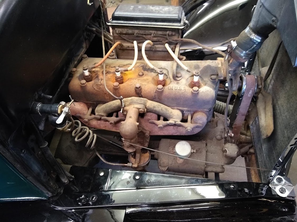

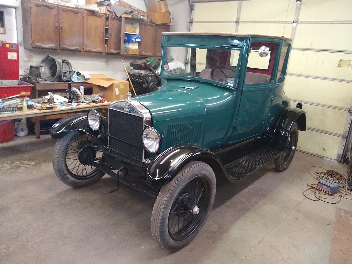

Hi, new here...this is a little intro so you all can have some entertainment, and hopefully give me some pointers.
I've been playing with 1928 and newer cars a long time. A week ago, I heard about an older fellow that was having to move away, and needed to sell his T. I ended up buying it. For the past week, I've been tinkering with it, and getting a lot of helpful info from old posts on this forum. Here is a picture of the car, taken yesterday.
As you can see, it's a decent looking car, but the only things on it that have been actually fixed lately, are fresh paint, new tires, radiator, and replated shell. The rest seems to mostly be 1970s amateur restoration, and enough minor repairs to just keep it going, sort of.
The list of things to fix is pretty long...including the cracked head, very loose steering, non working magento and starter, top, and inside trim. I was able to get it started and driving. I have 4 acres in the country here in southeast Arizona that I can drive around on.

Very nice! Add to your list the visor over the windshield. The head can be repaired with JB weld or similar product, it's not a pressure system and is done all the time. You would not even have to pull the head. Drill small stop holes at the ends of the crack, V it out a little and smear it on, let setup, drive. :D

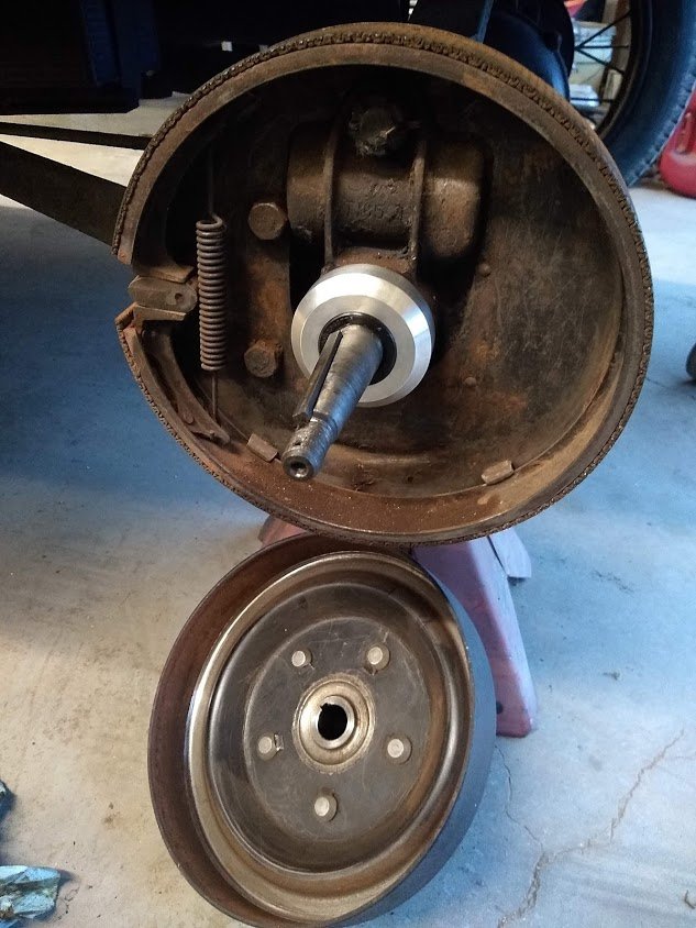

I went for a short drive on a public road today, speed limit 25, and the old car purred right along, mostly.
Later, I decided to see how the rear wheels and axle grease were doing, so I pulled the filler plug on the housing, and stuck my pinky in, and it seems to have something like 90 or 140 oil in it, almost an inch below the plug opening. Question: is 600 wt oil similar weight to 00 grease? I have some of the grease, but don't know where to find the 600 oil around here.
I pulled the rear wheels off, and was set to have to do some pulling to get the hubs off...but no, the nuts had cotter pins, but they were finger tight, and the drums slid right off. I sanded off the light rust that was covering about half the wear surface of the drums. The linings look like they are used, but still plenty of life left in them. looks like someone added rubber seals not too many miles ago. There is some end play in the axles, but not a whole bunch.
I did tighten the nuts when I put it back together, and plan to tighten them again.

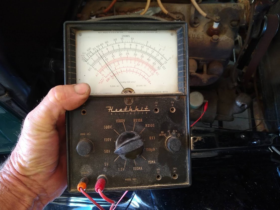

I also got out my dad's old Heathkit voltmeter, he built in the 50s, to check the generator output. Started it up, and it's making about 7 volts or so at brisk idle.
Then I decided I ought to see what the mag is up to, so I set the meter to AC and put it on the mag wire. What do you know, over 10 volts. Huh. So I tried switching from battery to mag, and it kept running! great...one less thing to fix.

That is a nice looking T that you have there. The magneto putting out 10 volts is low, but the following is how it should be checked. It should get better with an in car recharge.

I did the mag test, it lights up the bulb at idle, (I think around 10 volts) and gets pretty bright at high speed, (15 volts or a tad more). The crank does have end play, looks to be over .020", but I am not very good at judging how far things move, and didn't feel like getting out the indicator and taking stuff apart enough to attach it. Maybe in the coming weeks I will.
Near the end of the video you can see the crank pulley move back and forth.

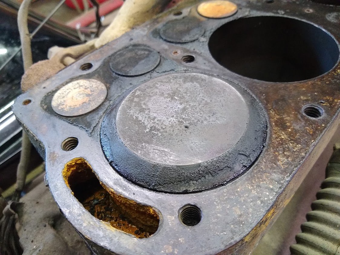

I decided it's time to do a compression test....results, no too good as you'd expect. I think the gauge is reading high, because it does not return to Zero all the way, but the numbers dry
40
35
35
30
and wet
45
40
40
35
So I think the valves are mostly sealing, but not real well, and the rings are not so good.

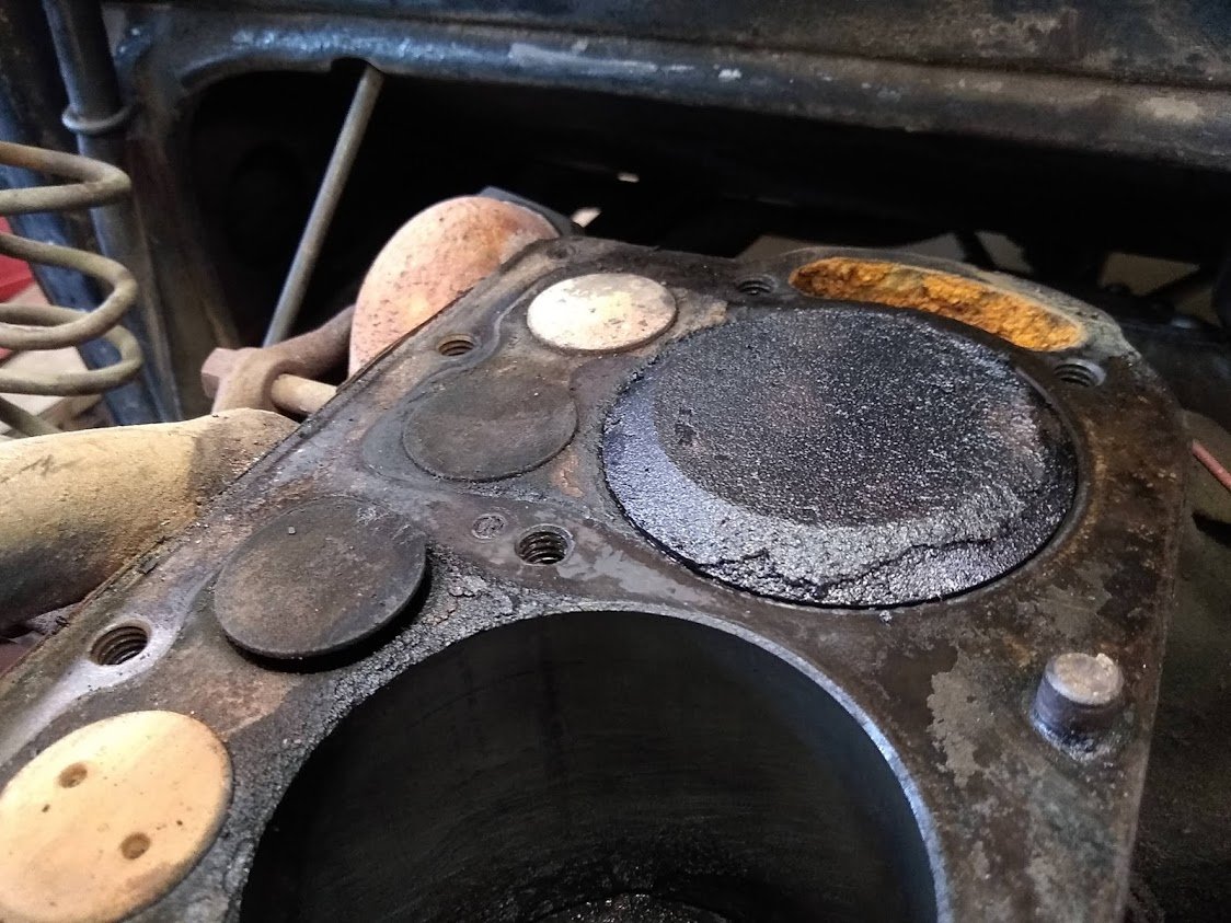

I decided to pull the head and take a look. Of course one of the bolts didn't want to turn as easily as the rest, and broke off a bit above the deck. The bores seem to be smooth and there is a slight ridge at the very top, I guess the rings sit up much higher on the T than they do on the modern engines I usually work on. Anyways, I got out the caliper and stuck it in a hole to see how much oversize it is...it read 3.750. Huh. I didn't know that was possible, almost a hundred years after it was made.
The bore gauge tells a fun story...#1 is mostly .010" oversize at most places, the rest range from 0.007 to 0.017, depending how high up, and at what rotation, I measure the bore. Pretty far out of whack.
No smoking, but there is quite a bit of carbon on the pistons. #1 had the least. I cleaned it looking for any stampings, not expecting to find any, but I didn't make it down to metal. I guess it's still an iron piston in there.
The valves have been worked on, at least one has been replaced. I haven't pull the side cover yet, to get the keepers out.

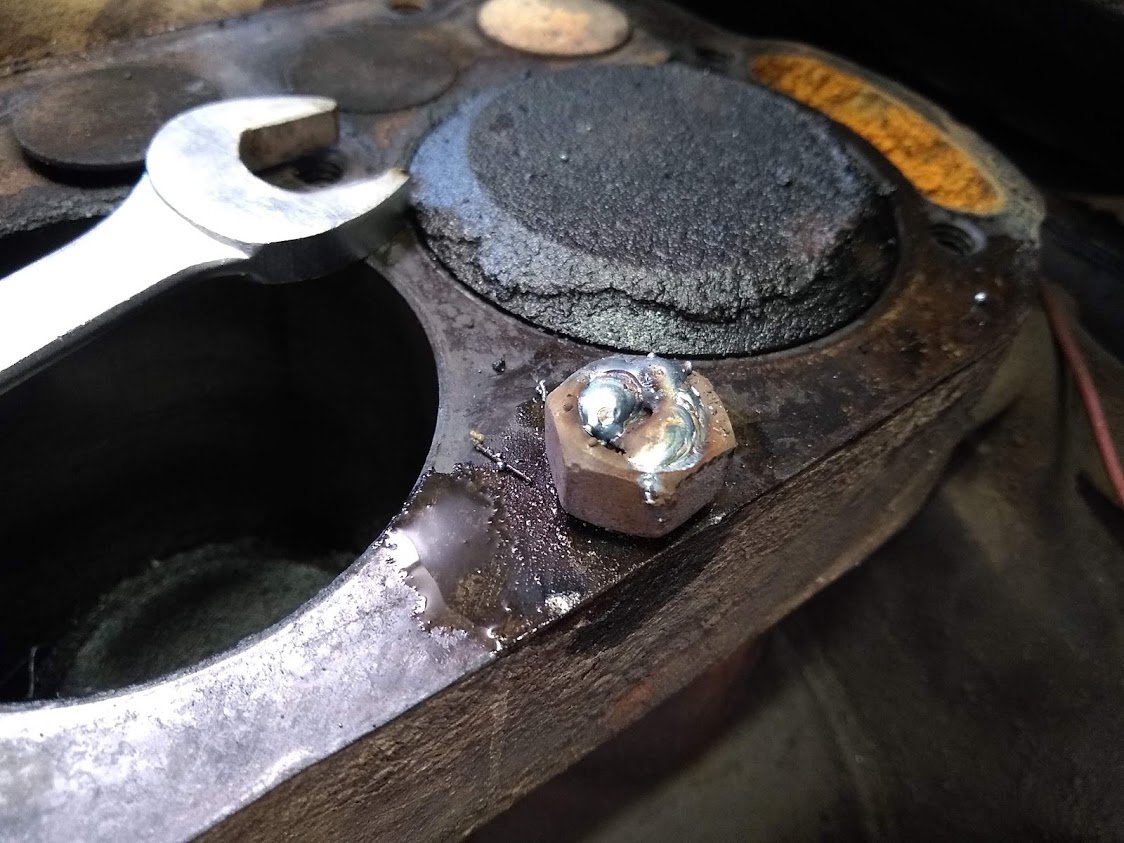

If you are lucky, you might be able to put a little heat on that broken bolt and then a bit of penetrating oil and let it set for a while. Then get a VERY tight grip with a good vice grip and try to remove the bolt. If not, you will need to drill it out. try to get your drill right in the center then with a very small chisel or punch, try to work the sides of the bolt into the center. Then it will come out. If you are lucky, the threads will still be useable. If not you might need to drill out and place a helicoil.

Thanks for the suggestions. Since it was above the deck, I decided to try the "weld a big nut to it" trick, and it worked just fine. First time I've ever done that....
Re: Got a 27 Coupe
Post by Norman Kling » Fri Jun 05, 2020 4:03 pm
That's great.

I've always wanted someone to try that, and then let me know how it works out. :lol: Looks good!

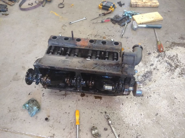

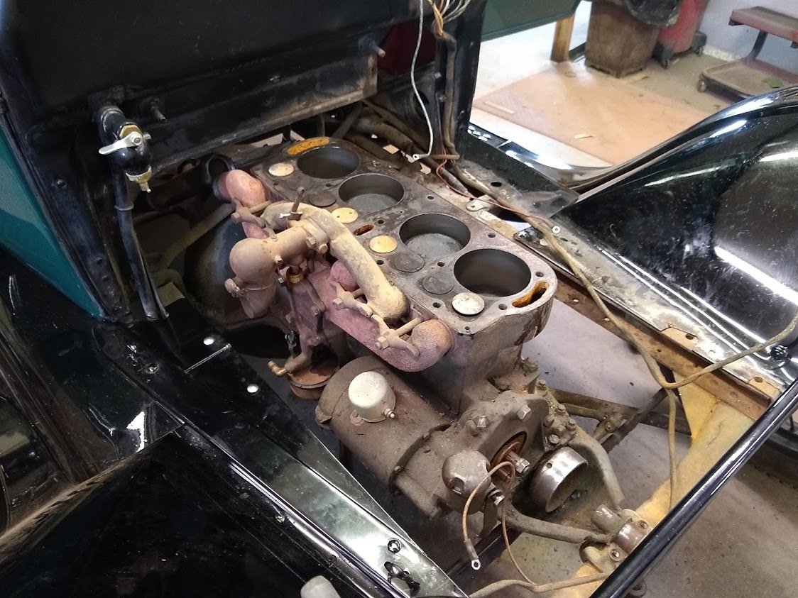

I decided it's time to pull the engine, and see what it needs to get it to run better. I've known all along that I needed to change the ring gear, so it had to come out anyways. Should be out in another hour or so, all I have left is the stuff "in back". I removed the manifolds after taking this picture.

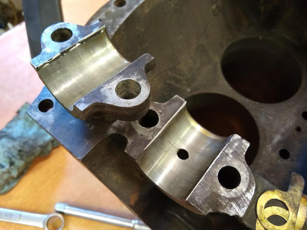

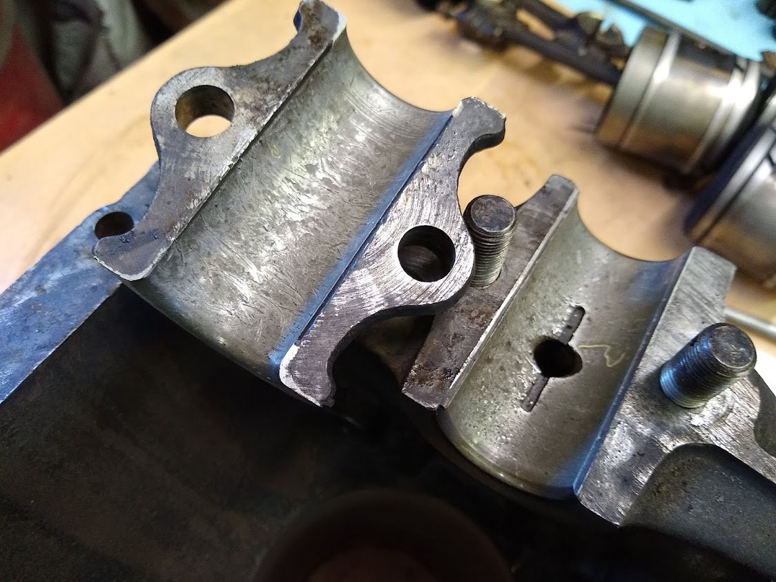

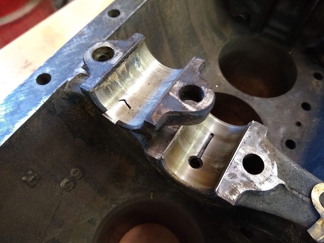

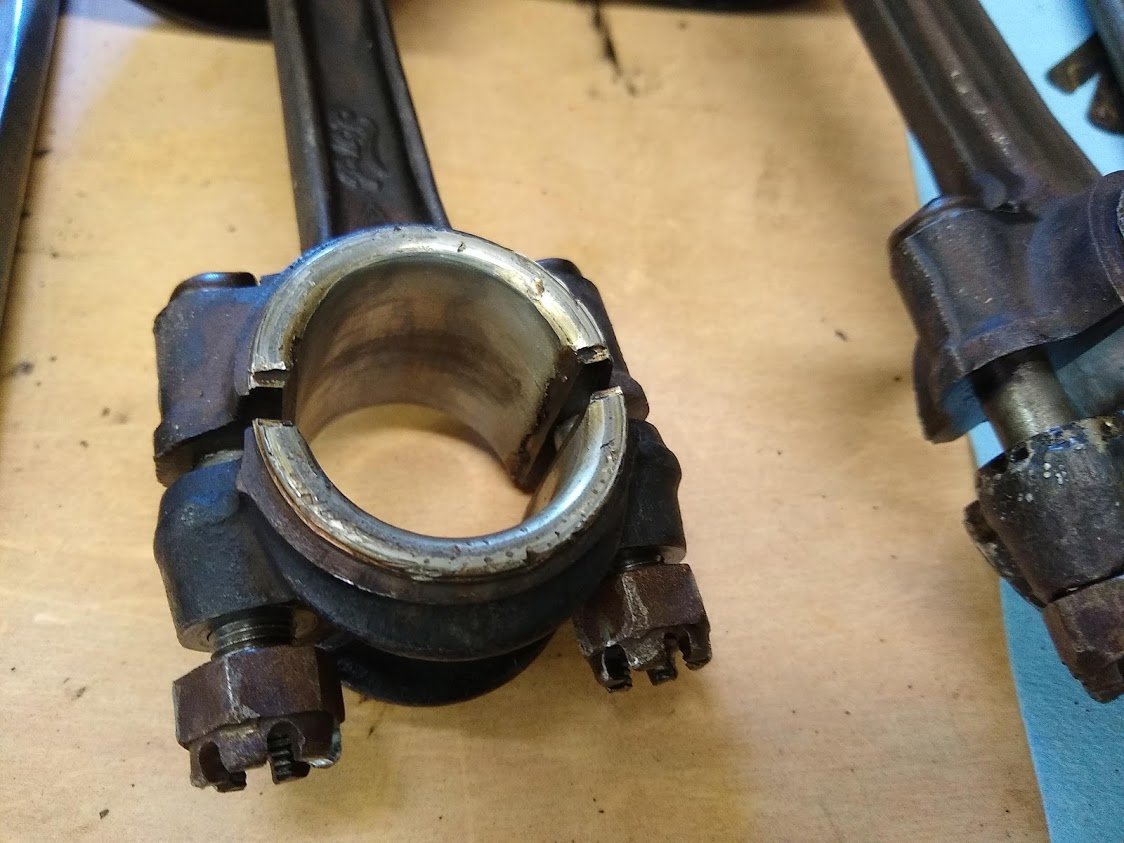

Got it out and partly apart. The magneto had been making contact, the cam gear has a lot of slop, oil line plugged up with what looks like the remains of ring gear teeth, etc. After taking the mag off, I measured crank end play, right at .040" All in all a nice engine.

Anyways...I got the engine all apart. It's not too pretty. The ring gear has been wearing away for a long time, apparently, and it looks like bits of it did a number on the rear main. I took out the approx 0.008" shims in it, and it still has a lot of slop. And the thrust surfaces on the crank have noticeable wear, there's a good sized ridge just outside where they contact the cap.

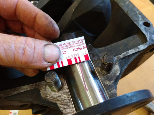

you know you're in trouble if red plastigage won't squeeze!
I wonder what a replacement cap would do for it? Although I know it needs the whole works...grind crank, new babbit in the block and rods, bore the block, new pistons, etc.
The valvetrain looks like it just has a lot of wear, but could be run a while longer with new timing gears, and replacing the one original valve with a new one, and touch up the seats.
Did I mention that it appears to have a crack in the block, bottom of the water jacket, back, driver side? perhaps two inches long. There was rust staining, and after scrubbing it with a wire brush a bit, I see a shiny line.

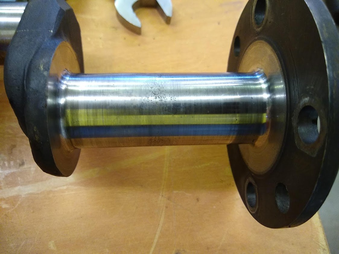

A few more pictures....
I measured the thrust wear on the rear main journal of the crank, it's about 0.010" wider at the worn area, than at the ridge. And it's pretty close to the nominal 3-5/32" size, most of the thrust wear is on the babbit on the block and cap. A bit more wear on the back than the front, it appears.
Also I measured bores with the pistons out, they're mostly 3.755 at the bottom, and have 0.005 to 0.012 taper, which includes the out of round. The out of round is mostly 0.005, with the axis sort of in line with the intake valves being larger.
John Codman
Posts: 1532
Last Name: Codman
Location: Naples, FL 34120
Re: Got a 27 Coupe
Post by John Codman » Sat Jun 06, 2020 5:32 pm
There were more then 15,000,000 cylinder heads built for Model Ts. I would find one that isn't cracked. I agree that JB Weld will work, but if I were buying any car that had a cracked head, number one on my priority list would be finding a non-cracked head.

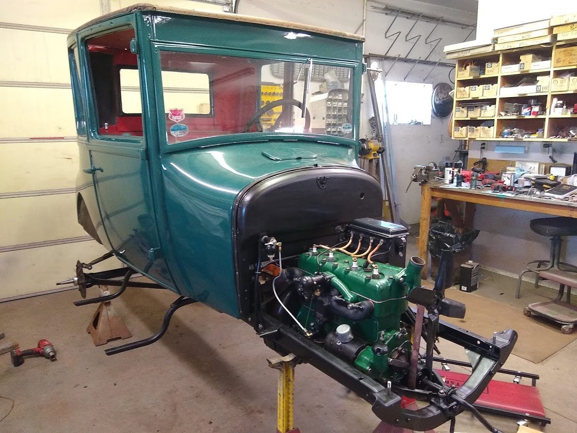

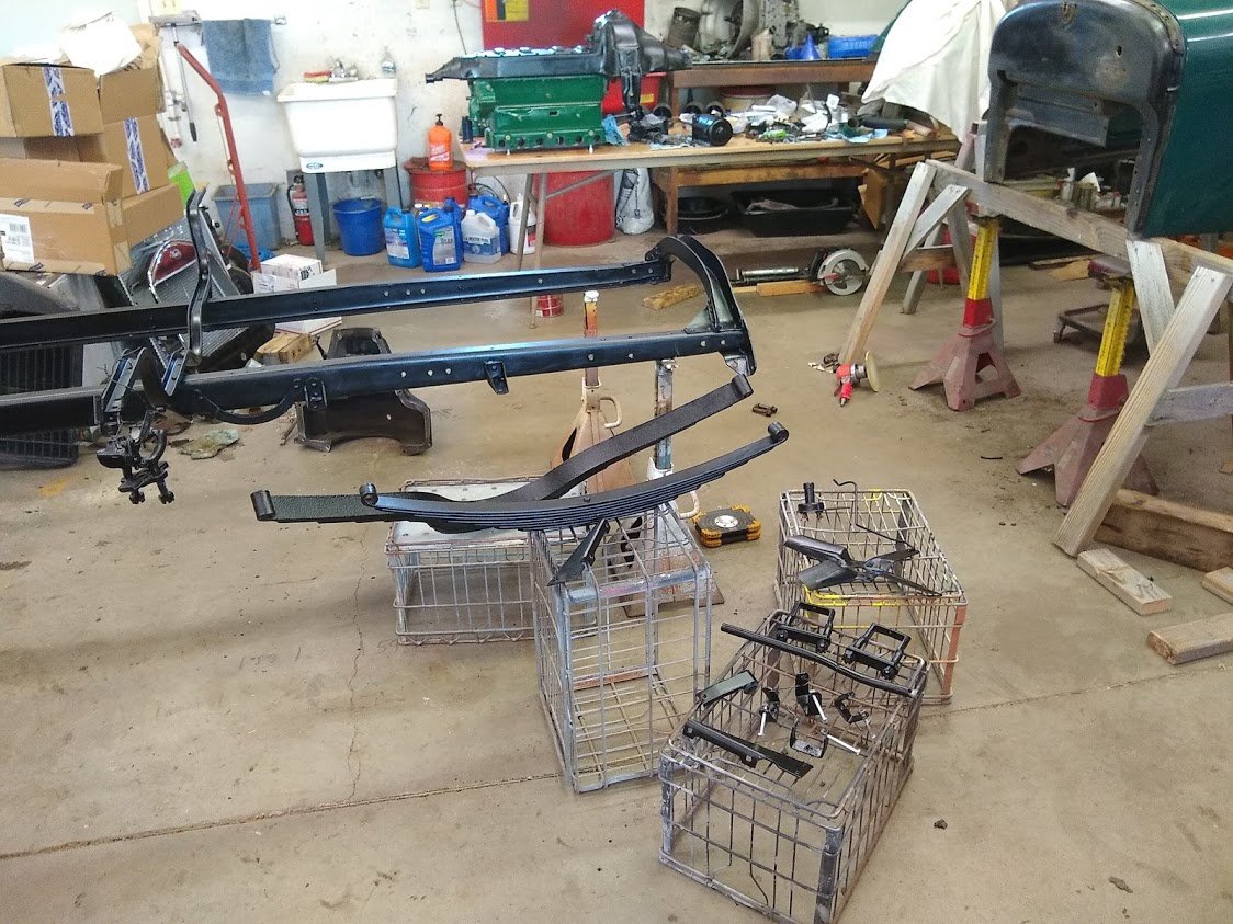

Anyways...as usual, things get carried away. But I'm making progress.
Posts: 6803
Re: Got a 27 Coupe
Post by Scott_Conger » Tue Jun 16, 2020 9:40 pm
You know, it's a lot of work to get down to the ring gear, but not THAT much work! ;)

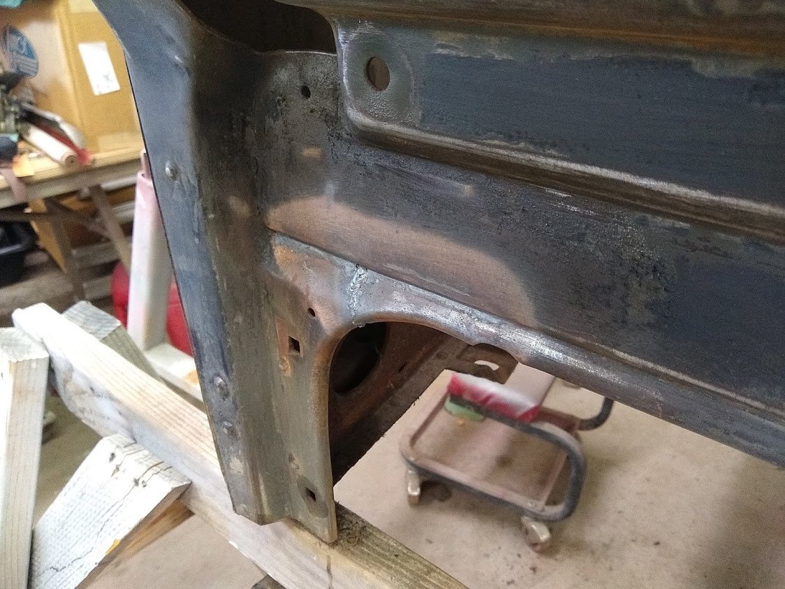

Post by Squirrel » Tue Jun 16, 2020 11:26 pm
The head had a big long wide crack. I got a replacement head. The block has a shorter, narrow crack that wasn't leaking, but I ground and JB Welded it anyways. It has another crack between the head bolt hole and the oblong water passage in the middle of the deck surface, too. I guess that one will get a bunch of aviation Permatex on the threads.
I decided to go ahead and make everything pretty, because it costs a lot less and takes less time than making it mechanically perfect. I'm just fixing the mechanicals enough to get maybe 5000 more miles (is that ten years?) out of it. I do plan to fix the play in the steering, shackles, etc. I do have a bit of experience with other not quite so old cars, getting them going again, so I have a pretty good idea of what really needs to be done now, and what can be put off for a while. Fortunately there are lots of old threads on this forum about almost every topic that I need to know about.
The thing about fixing the ring gear, is that you see where the missing magnet plate was, and where the plates that were still there were kissing half of the coil cores...then things in the engine get interesting.
Don't worry, I'll get it back on the road in a week or two, and see how it does.

You really don't want to put that crank in that block as is, and I know you know that.
I just finished something I'll never do again: I straightened a crankshaft (.010 back to .0005) which took nearly a week of tweeking and waiting for a day, etc. Then ascertained that the center main was beaten down a good .006". The caps didn't look as bad as yours but the babbit was thin, there were no shims in center and front, and had excess endshake at the mag.
New caps all around...had to send 1 rear main back because it was bored off center (?). After scraping and Timesavering (look it up, as I'm guessing this product is news to you...it works fabulously), I dropped the crank .006" to match the center main and all is good. The cam got an O/S timing gear.
I will never do that again, but it was something to do in a very cold shop through some of winter, finishing off measurements and buttoning up when temps hit high 60's.
NEVER AGAIN!
But short of a rebuild, that's what I see in your future.

The problem is that grinding the crank will cost several thousand dollars and take 6 months to a year. Not for the grinding, but for all the other stuff that might as well get done, while I'm doing that. Sorry, I'm not going there with this car, right now. I got a replacement #3 cap to fit pretty well. The bearing clearances are now about half what they were when I took it apart (#3 is now much less than half what it was). End play is right around .005, vs .040 before. Mag gap looks reasonable now, too. The crank spins freely, but not sloppily. The new undersize 4th bearing slid right into place, bolts go in with no side load. I think it's going to last well enough for my needs. I don't know what the future holds for this car, but I'm not going to worry too much about it. I do know that I should be able to get some driving pleasure from it, without having to worry too much about it coming apart.
Straightening the crank sounds like a fun time! This is a whole different world of tinkering that what I'm used to doing :)
Posts: 6803
Re: Got a 27 Coupe
Post by Scott_Conger » Sat Jun 20, 2020 9:20 pm
You're the one who keeps talking about grinding. I simply told you that you can rebed what you have, and put 3 good new caps on and be done with it.
You will be doing yourself a great disservice if you do not figure out how much the center main has sunk or raised depending on your point of view. When the 4th main wears, the droop of the transmission puts terrible pressure on the center main and can wear it inordinantly. That was the problem I had and it is very common. That's why I had to drop/raise front and rear by .006" to get everything all in alignment. Lots of scraping.

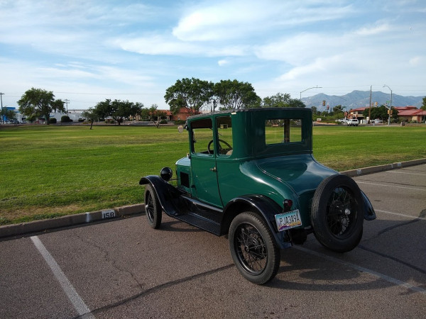

Thanks!

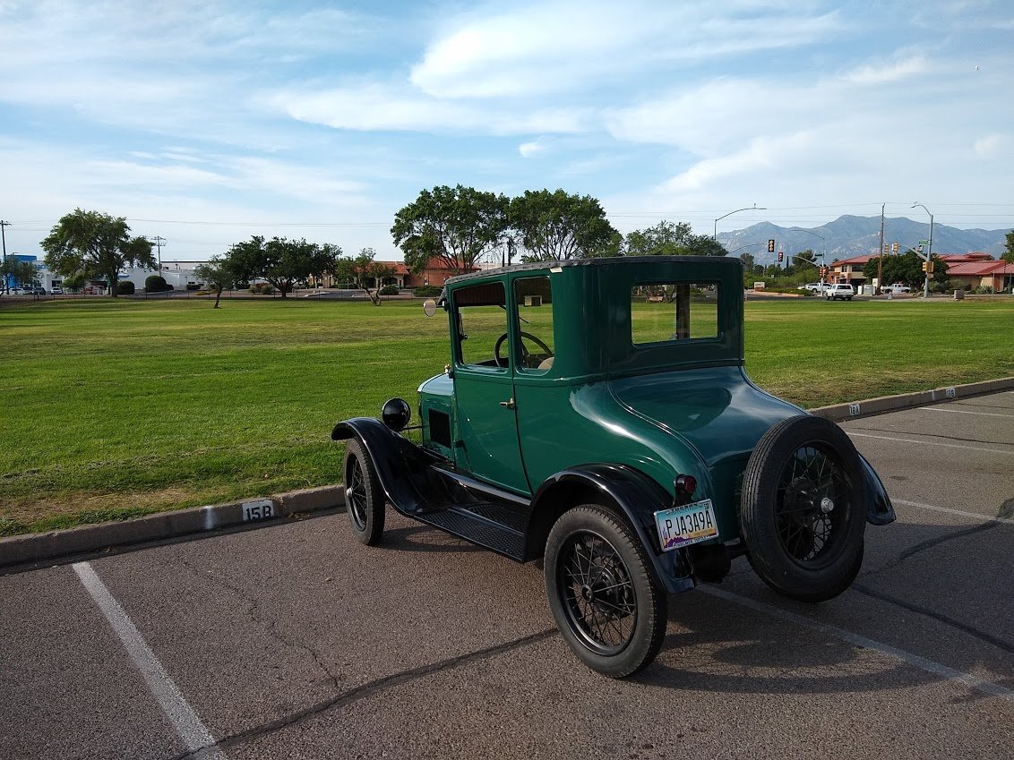

If you look at the last picture, you'll see something wrong that had me going for an hour or so....but I fixed it, and it started right up.
Anyways, I got the fenders on and the wheels back under it etc. Went for a drive this morning up and down the road I live on, it is peppier, quieter, and steers better. I checked some stuff, tightened the rear hub nuts again, and went out on a longer drive, to the gas station 5 miles away, and then a friend's house.
It mostly works. The windshield glass seems to be rattling in the frame, it makes a noise that sounds ominous, but quiets down when I press on the top of the glass, so I guess the noise is not in the engine. I plan to get some safety glass cut for it, and put in new setting tape, which should fix that problem.
It's over 100 degrees out, and the radiator was spewing some drops (the cap doesn't seal very well), and it overflowed when I stopped for gas. It did cool of pretty quickly. I guess it's working as it should, I expect I had the radiator a bit too full, I don't know what it's happy level is yet.
It also had a few instances of running a bit off, and popped a couple times. I still have to play with the mixture setting and figure out where it wants to be when...generally 1 turn open is working pretty well. The coils are all original, and I expect the condensers might be getting flaky, etc. I need to get some that have been rebuilt and tuned. The magneto seems to be working, although I haven't checked the voltage. I also need to play with the idle speed setting, it's a bit fast right now. And go through the band adjustment again. And tighten those rear hubs again.
But yeah, it was fun going for a drive. It's a whole new world.

Now THAT is how a Forum Thread should head toward conclusion: with a report on how things went!
That's just outstanding and impressive for the short time (in days) that it went from complete to stripped down to back on the road. Congratulations!
You will be most pleased with the result when you get the coils serviced and operating to their best. And yes, it is a whole new world...welcome to it. I used to be a fan of IMSA, and a dedicated Austin-Healey go-fast guy. Am having more fun going slow than I ever did going fast (though I still have the Healey!)

Now that it's running again, I have to decide what to spend money and time on next. The coils and a new exhaust system are about the last mechanical things I need to deal with. I'd like to work on the interior and top, but still deciding what path to take. I think I might just try to do the headliner and side panels myself, and see how it works. The seat is OK for now, although it's a funky 20? year old velour. If I do the rest in something that doesn't cost much, and sort of matches, then the car will have the overall "almost restored well" look I'd be comfortable with. I also need to do the top covering, and either replace all the top wood, or just make new bows, and hope the rest will hold tacks well enough that the top won't fly off. I got a chunk of poplar to make bows from, since I live a ways away from a good wood store that would have ash.
Also, the ammeter showed between 10 and 20 amps charging most of the time. I read up on the third brush, and took the band off, and looked. The nut was loose, and the brush was all the way over towards the engine. I moved it back to where it looks like it had been for a long time (the insulator leaves evidence), and will start it up and see how it does. I don't have the light wiring in right now, so I can't check it out completely.

Yeah, you need to knock that amp output down to around 4-5A to save the generator and battery. We drive much faster and further than what that kind of output was designed for. It will kick the pants out of a battery at 20MPH for 30 minutes, but fry itself and the battery eventually at 30MPH for 3 hours. It doesn't take much to boost back up after starting and any net draw with lights on will take hours and hours to show up as a pooped battery at 5A charge rate.
Look up http://www.mtfca.com/discus/messages/17 ... 1304466007 and take Ron Patterson's advice printed there. Usually just changing the 3rd brush does the trick, but if it doesn't, then someone mis-set the "Neutral" point in the generator and you'll have to do a little more work. If you end up at that point, just CRACK loose the 4 screws on the generator or the entire brush block assembly will end up dangling and you'll be dismantiling it to put everything back correctly.

Your car is looking good. Good to see you’ve got it going. Yes setting the carb is not exact for all T’s. Somewhere around one turn or so is about as good as you can say it! Mine are no more than 1 1/4 turn most of the time. Each T is different.
Don’t know if you’ve gone through the coil box but if you haven’t they can be a T part that can fool you if they “look” good. I finally bought a set of rebuilt coils for my 19 Runabout and it did help but it was the coil box I finally bought a kit for and took care of the occasional sputter. The original bolts in the box have a copper coat or plateing that eventually corrodes over time. The continuity in a coil box has to be really good for T electrical performance in my mind. I found that out in my 19. A coil box repair kit is fairly inexpensive and it does improve things. Sure can’t hurt.

Thanks. The coil box contacts are in good condition, I doubt they're causing problems, but I'll keep it in mind when I get coils redone, if it still has issues.
Adjusting the generator is fun....I guess it works best to have it on a bench with the right test equipment.

Once you read Ron's response to your type of problem, I think you might rethink that line of reasoning (at least with respect to adjustment). If you're just interested in seeing what's what, might as well rebuild it while it's out. It's either working or it ain't and to figure that out, it doesn't need to be on the bench.
One hint: many T ammeters, and your version of ammeter is notorious for being inaccurate, particularly for low readings. When you get around to testing things, turn the lights on without running the car. There will be a strong discharge. You can then compare that to the running discharge with lights on and the delta is of course your charge rate. Getting it properly/safely low enough may make the charge rate on the ammeter so far down in the mud that all or much sensitivity is masked by inaccuracies. Low charging rates can appear from slightly discharge to slightly charge, or vibrating across ZERO and give an entirely false understanding of what you really have when it's set for low output.

Working on the generator in the car is a pain, is all I meant. I know it has to be adjusted to work in the car, but it seems to me that setting up the timing of the main brush holder might be easier on the bench, if you have proper equipment to do it. Those four little screws are not very accessible with a Vaporizer, and having an assistant that will help with this stuff is challenging.
I've read that these cheap ammeters are not very accurate. I did go for another drive after monkeying with it some more, and it's showing about 5 amp charge when driving now, so it is probably going to be ok for a while. I also know that the setting won't ever be perfect, and what it needs to be set at depends a lot on the use of the car. I just don't want to cook the battery, and it looked like it was headed that way before I tinkered with it. Like so many other things, I have to get in there and see how it works, play with it, and then go back later a few more times to get it closer after I finally understand how it all works.

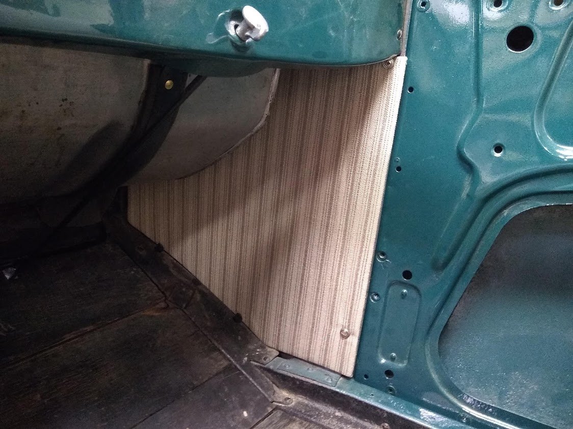

Post by Squirrel » Mon Jun 29, 2020 12:13 am

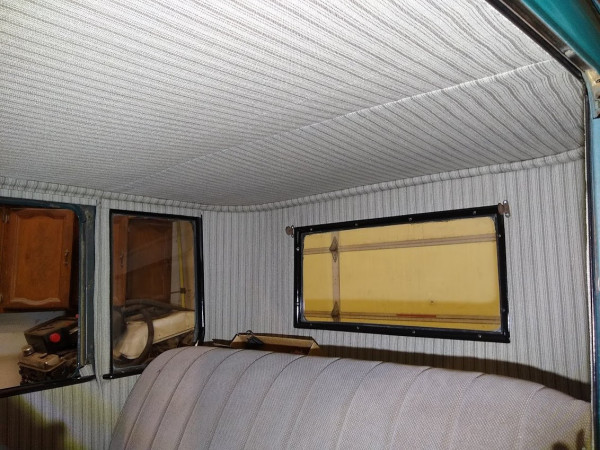

I started playing with trim....went to local fabric store, bought 8 yds of this neat stripe cloth, which colors match the existing 1980s(?) velour on the seat. I started on the hard to see pieces, so my goof ups won't be so noticeable.

Thanks! being retired, but young enough to still have some energy, I can get a lot done when I feel like it.
Trim progress....it takes a while, because I don't really know what I'm doing.

Post by Squirrel » Sat Jul 04, 2020 10:08 pm
I got the interior almost finished. I have to do door glass still, and a few other touches. I also put a roof on it, which also needs a couple finishing touches (welt and gutter).

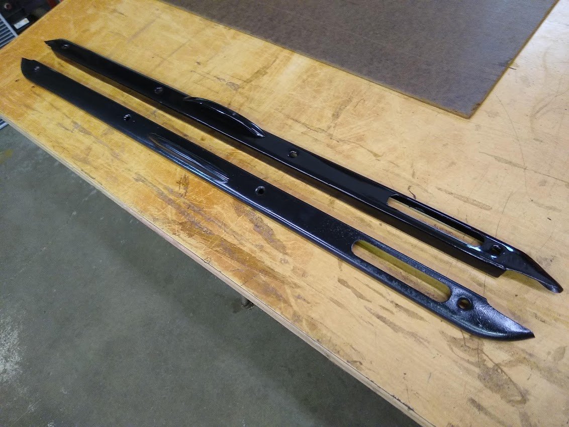

My car was missing the driver side garnish/door pull. They sell new ones, but only in pairs, and I didn't really feel like spending the bucks for twice what I needed. And no reply to my wanted ad, I guess used ones are hard to find also.
So I made one. It's not perfect, but it's pretty close.

Post by jab35 » Mon Jul 06, 2020 1:14 pm
That's really nice work on the molding, thanks for posting all your progress reports. jb

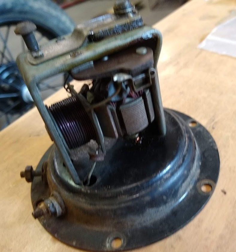

I took apart and cleaned up and painted the Klaxon horn. And made a bracket to mount it on the car, because I could.
It works.

Jim, would you show us a pic or two of your interior? Even tho not correct per say, I for one would like to see.
Very interesting thread. :)
Squirrel
Posts: 140
Joined: Sat May 30, 2020 9:54 pm
First Name: Jim
Last Name: Forbes
Location: Sierra Vista AZ
Re: Got a 27 Coupe
Post by Squirrel » Wed Jul 08, 2020 12:38 am
Sure. I didn't want to spend the time/money to get the right interior...and since the paint is wrong, etc, it doesn't really matter too much. Also, I wanted to see if I could do the trim job myself, and have it come out OK.
I still need to finish some things...I need to get some door glass cut, it was missing. Today I got all the parts to install it, and tested my template (it fits!) but still looking for a place that will cut it some time soon.
Here's one shot of the inside, doesn't show everything.

I decided to take a trip into town today, it's about 10 miles or so, as we live out on a country road. I made it, no issues with the car at all. But my driving is still developing...I did have one "late" stop at a traffic light. I need to get more used to them, and also practice my panic stopping technique.
PIcture at the local park.
Posts: 4688
Last Name: Kuehn
Location: Texas
Re: Got a 27 Coupe
Post by John kuehn » Fri Jul 10, 2020 1:32 pm
Hey Jim! You have to remember when driving a stock T that you drive as if you don’t have real brakes because you really don’t! Just kidding but that’s the way I drive mine and it does work. Its definitely is a re-learning experience when you’ve used to driving modern cars with positive brake action. Starting to slow down a good ways before you really have to stop is what you learn to do after a few of those learning expeirences!
And the 27 looks sharp even without the missing rear hubcap! :D

I pulled the engine before I decided to remove and paint the frame, etc. So I had already unbolted the body from the frame, and lifted it up a bit and rested it on some 4x4s above the frame rails. Then I set up some steel sawhorses on either side of the car, and put a steel tube between the body and frame, and raised the body up. I also put another sawhorse at the back of the body, to hold it up. When I put it back together, I put the frame in from the front, so I had to move the supports around. It was a couple months ago, and I forget the whole sequence...
If I were doing it again, I'd probably use that scaffold I have, to support one end of the body.
I did all this by myself, it would probably be easier with a few more people.
