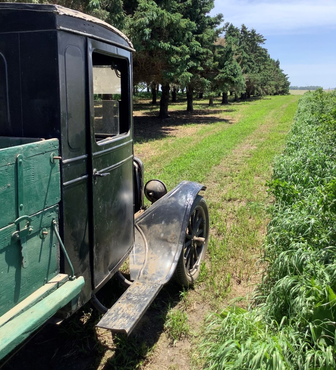

Driving again but--
My May job was rejuvenating the gas tank and TT was out of commission for a few weeks. Got it back together and my wife suggested a drive which am always happy to oblige. We had been working hard at cleaning up our grove. TT started off normal then after a few hundred yards the engine stopped like it was turned off. It started again but was running very rough with misfiring, and low power. I wasnt sure we'd get back to the shed without a pull but we did. I was thinking first plugged fuel line, or what does vapor lock act like, or poor flow in the carb. So I blew out the fuel line, rechecked the route of the fuel line past the exhaust, drained the sediment bulb and tried again. First hundred yards at slow speed were fine then misfiring and low power once again. About ready to look at the Kingston carburetor when I tried some Seafoam in the tank. Whatever was the TT's ailment, the seafoam was the solution. It probably took about as long for it to begin running smooth as it would take to get treated gas to the carb. So asking is this a bad gas issue or still doesn't hurt to look over the Kingston. It is on my list of things for the summer, but sometimes I look at if it isn't broke don't fix it. Other things need doing first. I guess I will try gas from a different place next time round. The first gas of the season was from a different place and the gas after the tank redo was from a second place, maybe one to avoid. I only ever run no ethanol unleaded but first time this kind of rough running.
