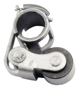

Looking thru some old timers I noticed the Anderson Timer has a smaller diameter circle for the contacts. What does the roller assembly look like that attached to the cam compared to other roller assemblies?

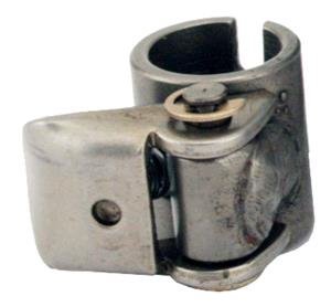

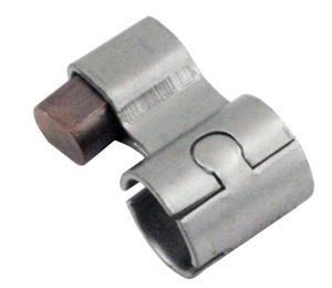

Anderson timers use a 'flapper' rather than a roller. The flapper swipes across the contact spot in the timer instead of 'rolling' or 'rubbing' around the edge as regular timers with rollers or brushes do.
It seems you either like them or you don't. I like them and have had good running experience (i.e. no problems, always work, last a long time).
Anderson flapper:
Roller:
Brush:
