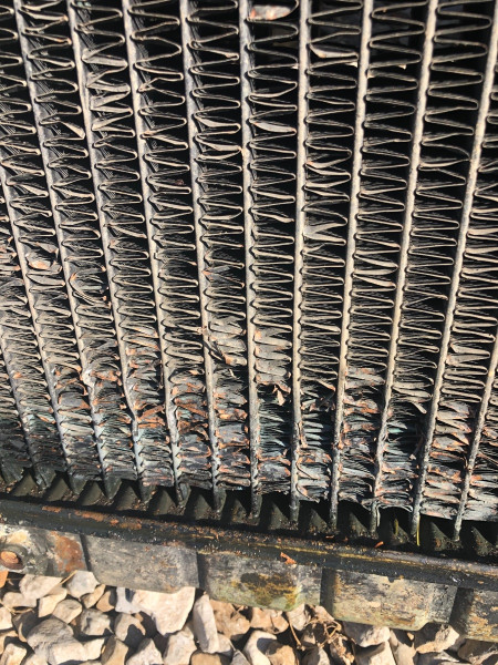

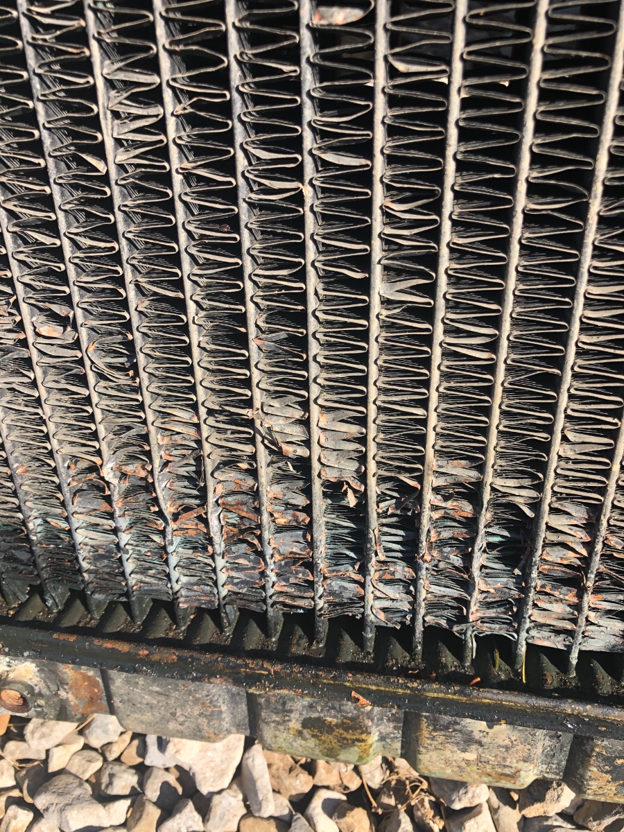

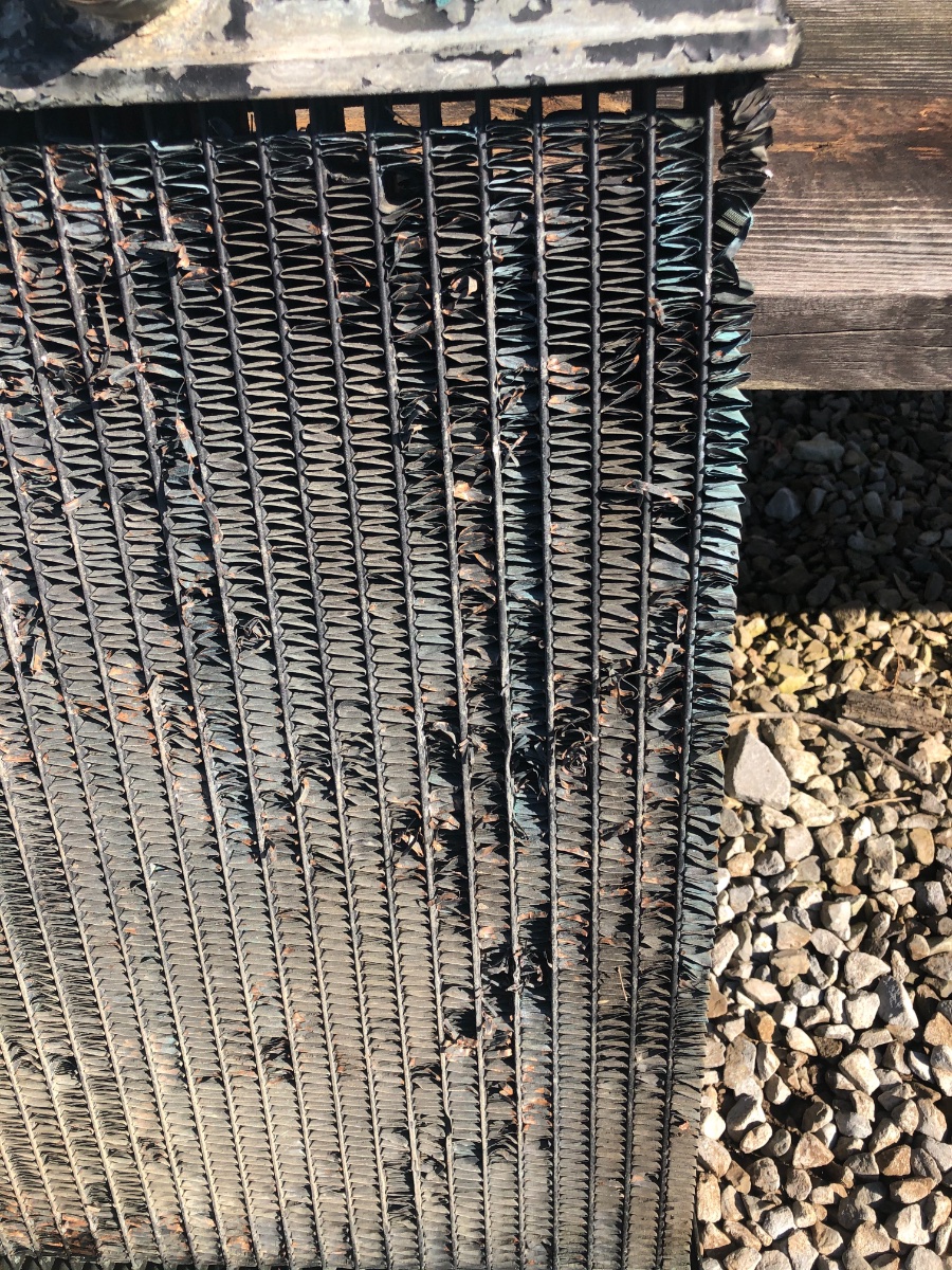

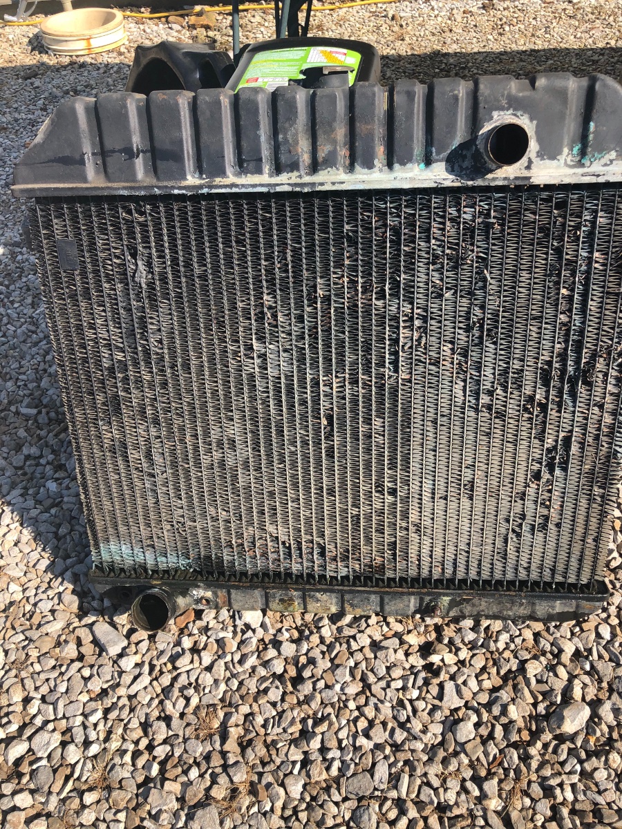

I was prepping my 1979 Ford 4 X 4 for shipping to the UK as our youngest is going to use it on their farm, hauling animals to shows, etc. This truck has been restored, parked in the barn, started on occasions, etc. After starting it up getting ready to move it, all hell breaks loose with antifreeze hitting the windshield. Antifreeze just going everywhere. After pulling the radiator, and looking real close, teeth marks everywhere on the flat core tubes and the filaments pulled out. This radiator was brand new when I restored this truck.
It appears either a rat, squirrel, or groundhog was eating on it.
I did some research...., BE CAREFUL OF THE PAINT YOU USE! This radiator was USA made and it was coated with an environmentally friendly paint, (soy vegetable oil base). As Paul Harvey would say, "Now you know the rest of the story".., "Good Day"! The ingredients being natural attracts critters. Use a good petroleum base if you can!

I've not heard of soybean based paint, but am not surprised! I hope the wiring is old enough to be petroleum based insulation, not the soybean based as it is now! I spent almost 14 hours repairing rodent chewed wiring at the rear of a 2015 Subaru Forrester. It had the right rear ABS sensor wiring cut twice, and the worst was a seven wire plug in to the evaporative emissions canister that had the wires chewed off flush! I had over six hours fixing the plug in, since it was not made to come apart! I finally got it all back together and cleared all six codes from the computer, and it is good again! Oddly, the evaporate codes shut down the hill holder, and stability controller!

Using boiled linseed oil can net the same results. The wood on my 25 pickup box was getting dried out so coated it with boiled linseed oil, the rats loved it, not very filling but must have tasted good.

I heard the same thing on mice eating newer cars wires with wiring coated in non-solvent enviro-friendly coatings. They love the flavor! Luckily, I don't own anything that new out of our 9 cars!

That's true, Mike. Hondas use soy based wiring coating and the rodents love it. I do quite a few repairs each year at my dealership.
