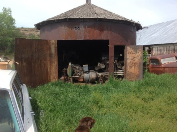

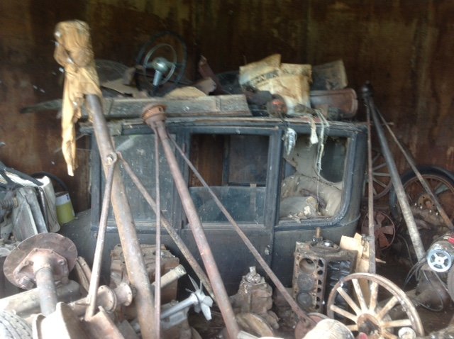

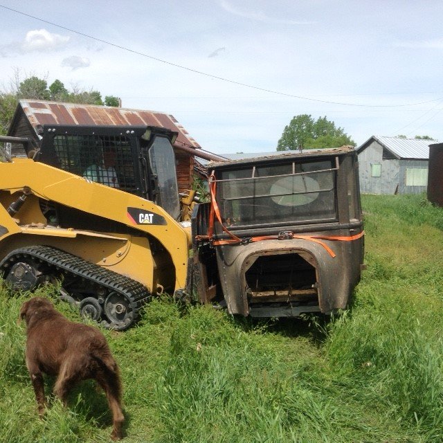

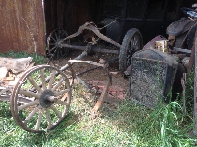

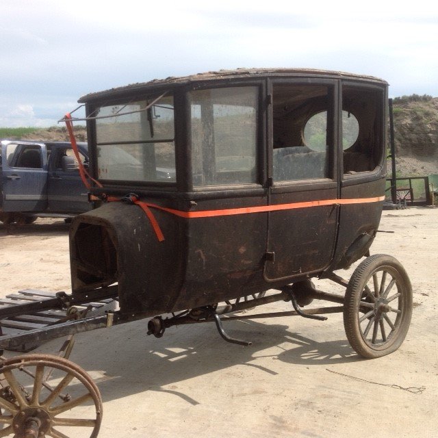

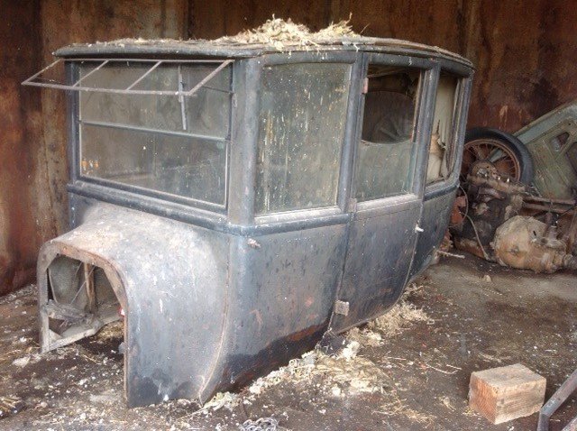

This is what I think of when someone says they have a barn find. There are two Model T's in building. It was a fun day last summer digging out both cars. It was the most mouse, bird and pack rat poop I have seen in years. Ton of parts, I number of which I still need to pick up. The car was disassembled in 1960 or 61. Most of the parts are there. It was several hours of moving stuff to get to the centerdoor.

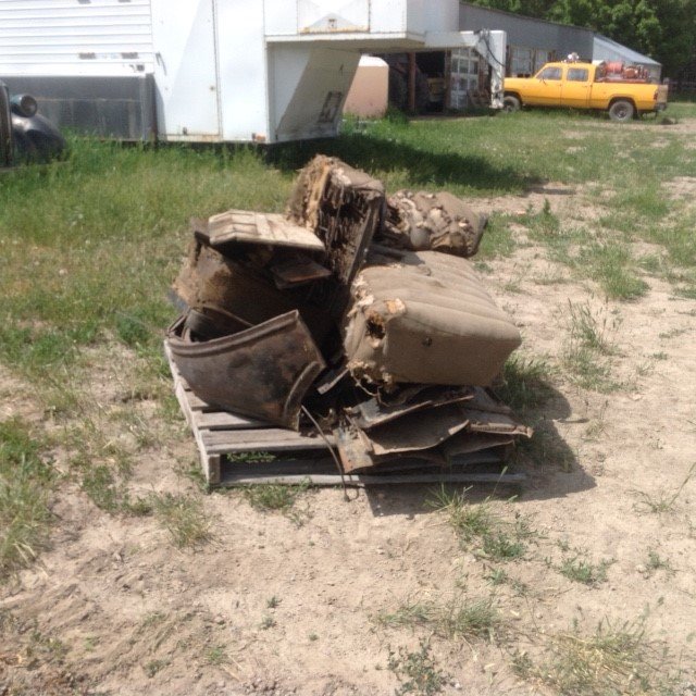

Now if you can just find a seat for it you'll have it running in a week, John!!
It's a cool car! Great Body!!

Great find. Looks like a 20-21 center door to me. Guess someone had intentions to restore it but never got to it. But he did save it!

That centerdoor has the hallmarks of original paint. I'd sure be tempted to do a sympathetic restoration on it.

Not a barn find. Looks more like a granary find.

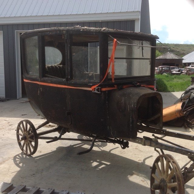

Don it is original paint and I am thinking about leaving it. The wood is pretty good.The passenger side door does not fit quit right and has bent hinge. Once it get's sorted out a little on what needs to be done I'll decide on which way I'm going with the paint. John, it's titled as a 19 but I think it's newer.
I'm retrieving the engine next week. It's been stored in the basement of the main ranch house since the car was taken apart. I think it has a 1923 serial number but can't remember. I would really like to find a complete seat but thanks to some great forum members I have at least found some pieces.

I was thinking the same thing Re the granary. Before moving it too much, I suggest bolting in a pan to hold the front radius rod and keep the front spring from twisting the cross member too much. Great find, they just keep coming out of the wood work (Ok granary)!R.V.Anderson wrote: ↑Wed Jun 03, 2020 10:35 amNot a barn find. Looks more like a granary find.![]()

Going by the photo of the body on the frame and wheels it has the pressed steel running board brackets which came out In 1921 and that’s why I thought it might be made in the 20’s.
But if the title says it’s a 1919 it may well be. The barn has lots of car parts so hopefully you sort everything out that’s for the car.
The body may clean up pretty good as is and being put back together with the original parts as much as possible and be made roadworthy again would be neat.

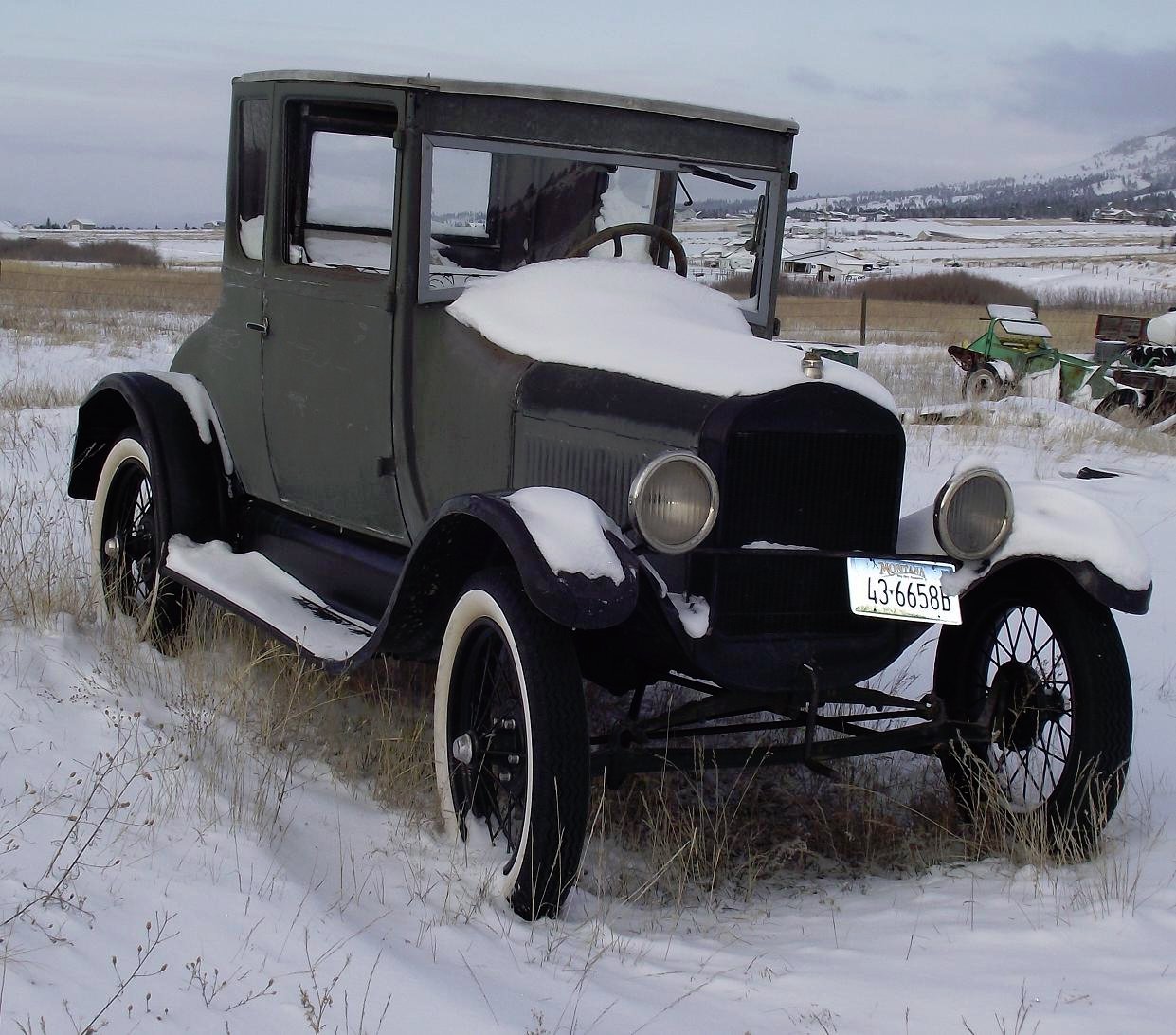

Mine is original paint and will stay that way. There are fewer and fewer of them left. This one will get a little wooden box in the back where the trunk lid is gone and the panel is bent.
I think John should do the same with the Center Door. It is a cool car!!

It's beautiful Stan.StanHowe wrote: ↑Thu Jun 04, 2020 2:00 amMine is original paint and will stay that way. There are fewer and fewer of them left. This one will get a little wooden box in the back where the trunk lid is gone and the panel is bent.

It has straps to raise the rear windows so it is not a 23. I'm going with 20-21 due to the steel covered window pillars as well as the T handled door handles.

It is also a wide bodied centerdoor. There were 3 companies making the bodies and one of them was 4" narrower than the other 2. This one is wide because it bulges in the middle of the body at the doors. Had a friend who restored a narrow one with a wide front seat. There was no way to get in the front passenger seat without climbing over. He found the proper narrow seat and the issue was resolved.
