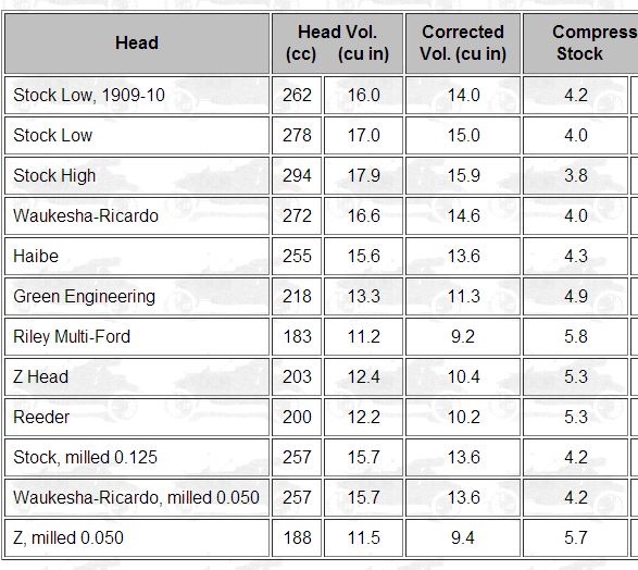

While they did not test the Prius head -- I don't think they had one readily available when they did the testing. But they do have some great information on the Z and other heads installed on the T. See the Model T Ford Club of Tulsa technical page at:
http://mtfctulsa.com/Tech/index.htm
and recommend you review their sections on :
Power, Torque and Model T Performance at: http://mtfctulsa.com/Tech/power_and_torque.htm
Dyno Data at:
http://mtfctulsa.com/Tech/DynoSummary.htm
Model T Accessory Heads at:
http://mtfctulsa.com/Tech/heads.htm
Other items are interesting also -- but those are related to your question.

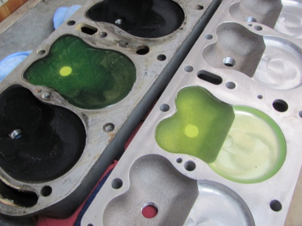

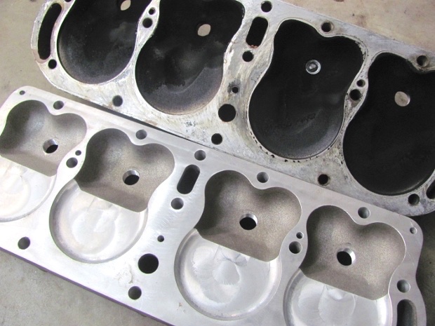

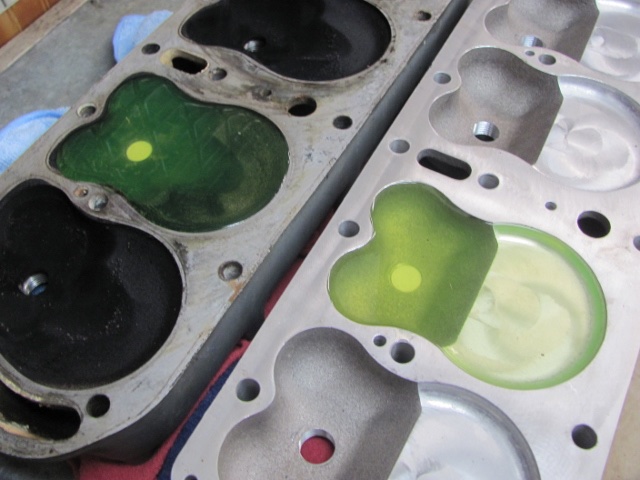

Similar experience, the Prus head performs best for me. Now my test is sorta garage like, but when measuring one chamber of each, the Z and the Prus, the Prus held less, so the chambers proved more compression possible.
Now the results of the Tulsa more scientific tests showed the Z head to be 203cc. But my test showed 250cc.
Anyway, was running this Z head on my '27 and thought it was giving good results, but when changed over to the Prus (no other engine changes), the T ran much smoother and got 3-4+ mph at cruise speed.
IMO, the Prus is CNC machined chambers and all match each other. The Z chambers are as cast. The Prus is also made of high grade alum, and then subject to vacuum impregnated sealer like they do all modern alum heads, i.e. less worries of corrosion on iron block.
Note Z at 203cc in a chamber
Prus head below, Z head above, see chamber differences in shape
Prus measured 210cc, Z measured 250cc in my garage tests.
