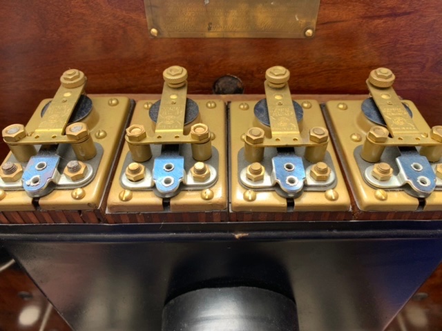

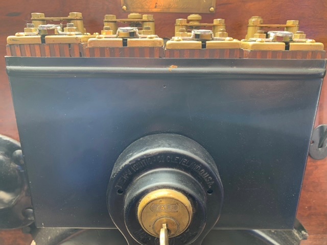

The coils were redone by Mize. The gas tank was removed and a gas tank restoration kit from Lang’s used to treat it. The tank has a new sediment bulb and a new flexible copper gas line was installed. Prior to installation the carb was soaked in chem dip carburetor cleaner and then some parts specifically cleaned like the ball bearing the float pushes up against.
I’ve attached pics of my coil box and coils.

1. Push your coils down all the way in the box. See how the left end coil is sitting so much taller in the the box than the rest?

Appears to be a loose nut on the 2nd coil from the left - maybe the photo angle ?
