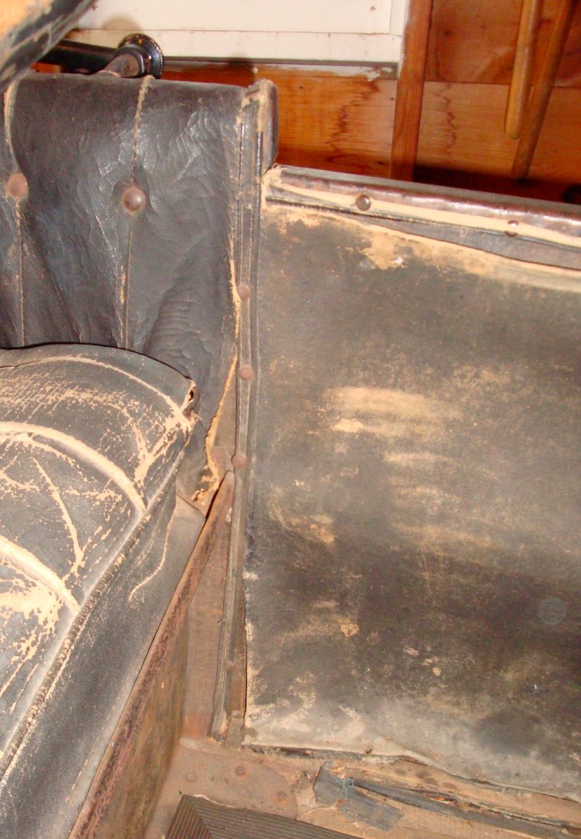

The panel forward of the passenger door has trim/binding around the entire perimeter, no different than the door.
The driver's side panel also has the same trim as above around it's entire perimeter. If you want to do it the same as the factory, the trim immediately forward of the seat riser is just a continuation of the driver's armrest trim.
Below is a photo of the 1917 Rip Van Winkle driver's side.

Re: 1917 Touring Interior Question
Here's the driver's side of my '17 roadster.
The binding for the armrest continues past the upholstery, all the way down to the bottom of the panel. In other words, it is one continuous piece of binding the covers both the armrest and rearward end of the panel. Click on the photo to enlarge.
