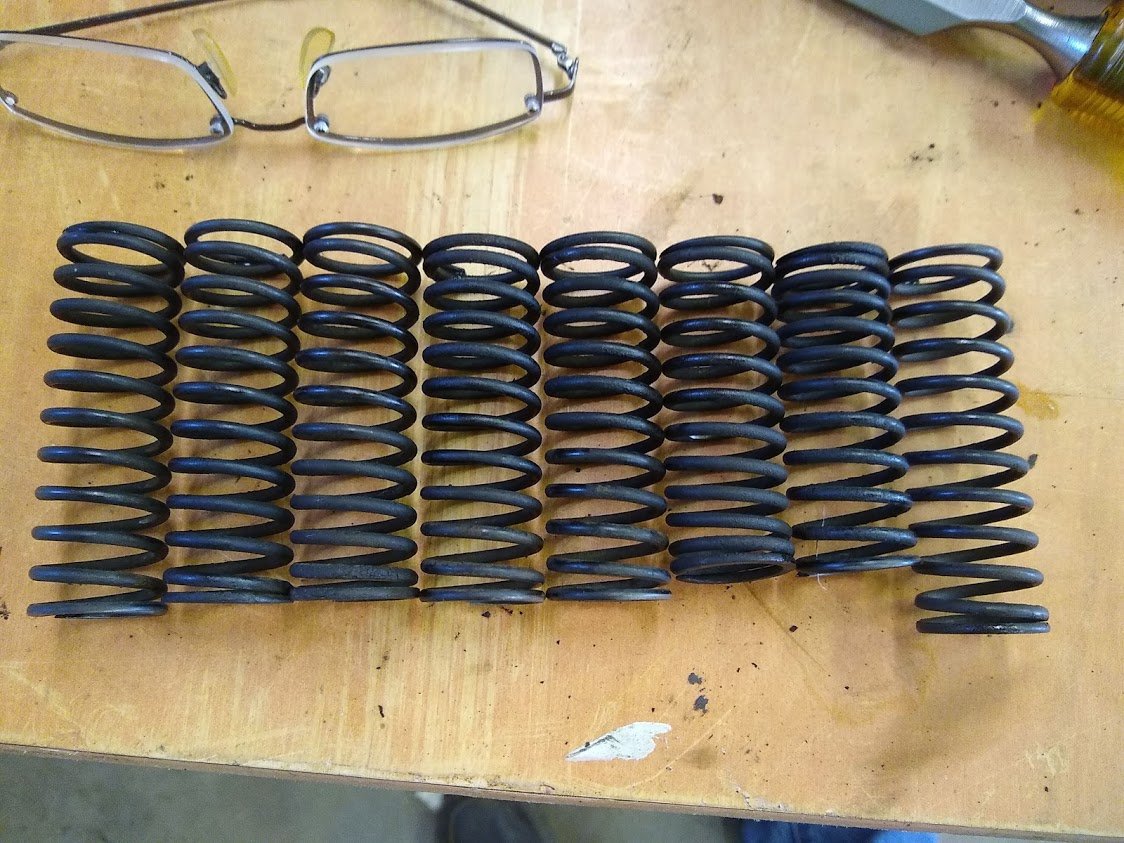

After taking apart the engine in my 27, I noticed the valve springs didn't all look the same. I lined them up, by length, but put the longest next to the shortest.
There's about half an inch difference, the longest is about three inches, shortest about two and a half.
Just for fun, I measured the installed height, looks like around two and one eighth. I set a combination square to that length, and used it to push the shortest and longest springs on a an old dial type bathroom scale. Short one...just under ten pounds. Longest...just under thirty pounds.
I wonder if this has anything to do with the car not wanting to go very fast? Although I found plenty of other things wrong with it, as well.

Even with the stretched one, you could still be in the ballpark pressure wise. You could check them, put one back in get height open and closed and check what they all are, OR just get a new set.

I'm getting a new set, of course.
I just thought it was interesting, how bad they can get....
I want to go faster than 25 or 30.

I ask, because at 25-30, you're pretty much at the torque/horsepower optimum range. Over 35 and you're well over braking ability, and past the point of bullet-proof reliability. T's driven at 25-30 will last pretty much forever, but when driven over 35 on a regular basis have a much shorter life between significant refreshes. Counterbalanced cranks, balanced rods/pistons, etc and you can up the reliability aspect 5-10MPH, but before I spent that kind of money for a few MPH, I'd just buy an "A" and have real brakes and be done with it.

I probably won't need to buy new valve springs, and several other parts I was thinking of getting.

I'm probably going to stick with the stock valvetrain for now. All of the valves but one are one piece, somehow a two piece with a well worn stem was still in there, I'll replace it with a new stock valve.
