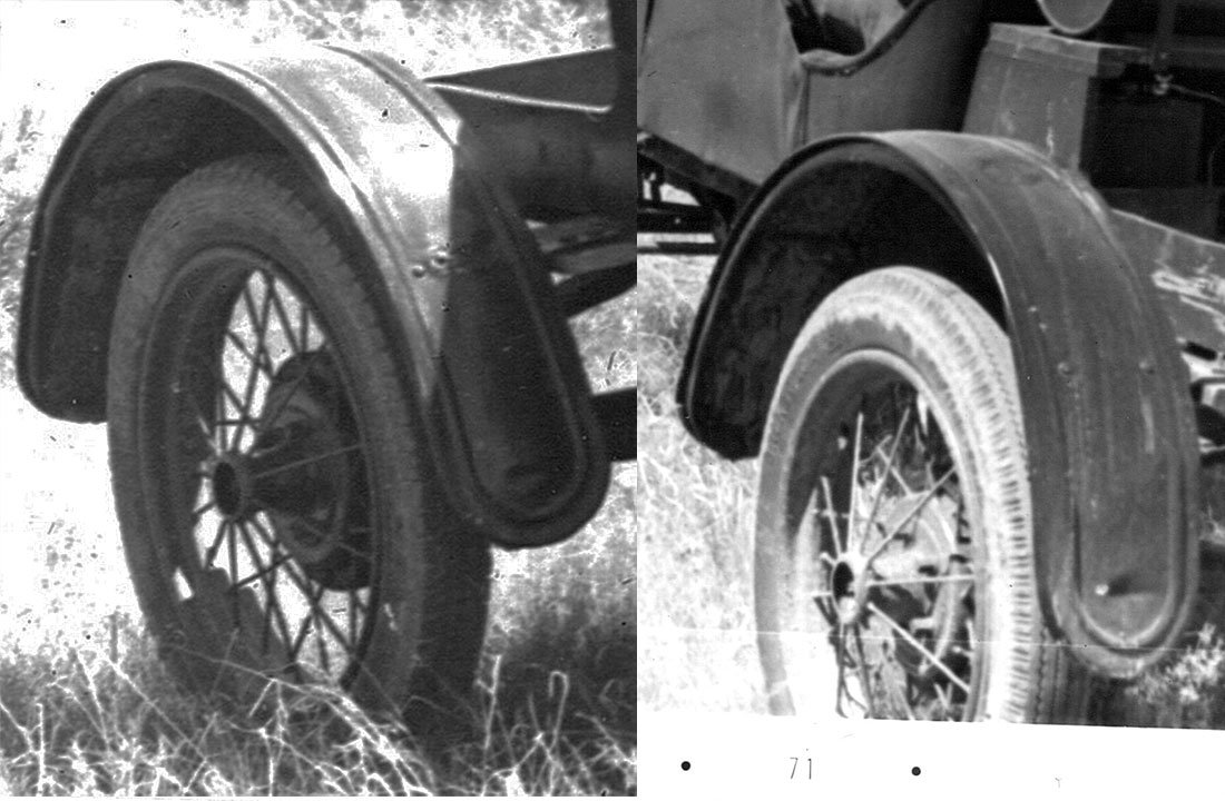

While there were style changes, the touring and roadster fenders were the same up to 1925. I would use the flat top rear fenders that would be correct for 1915. Then design the box so no changes would have to be made to the fenders except how they mount. My 25 was done that way.

Thank you both! Especially Mark for the photos! Sweet!

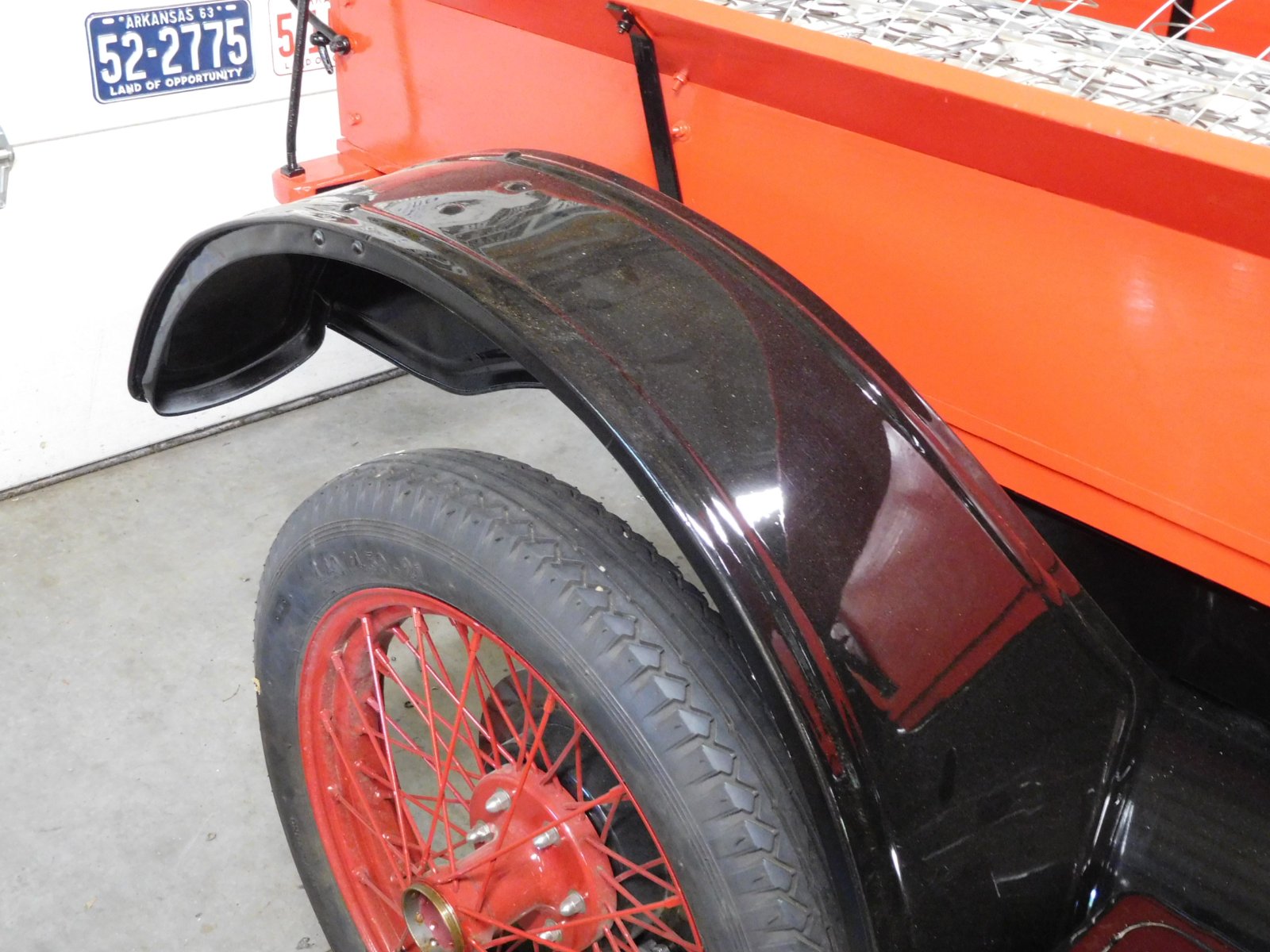

Here are some pics of a rear fender on the '16 RPU I'm building.
Note that the cross-section of the fender is flat across the center, whereas the 17-25's are crowned, as in Mark's pics. Otherwise they are the same overall shape, so either would work on your car. But if you're going to build a 15-16, the flat ones would be correct. The 15's have three rivets in the mounting brackets; 16's have four as shown in mine.

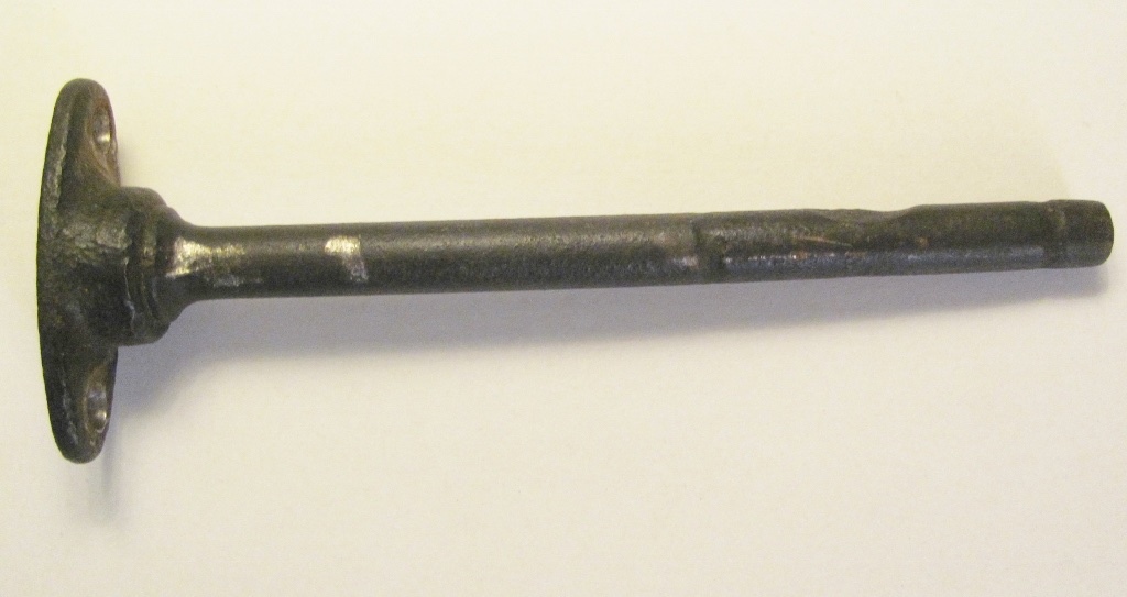

I found these in a dump and have used them on a trailer, a Speedster and a C-cab truck. I believe Rootlieb made them in 2 styles, one to attach to a running board and one like these. I doubt there are many originals around but if they are still being made they might work nicely.
P. S. I see Mac's advertises them. They come in lefts and rights.
https://www.macsautoparts.com/ford_mode ... truck.html
https://www.macsautoparts.com/ford_mode ... 25437.html
I haven't bought from Mac but here is what they look like.

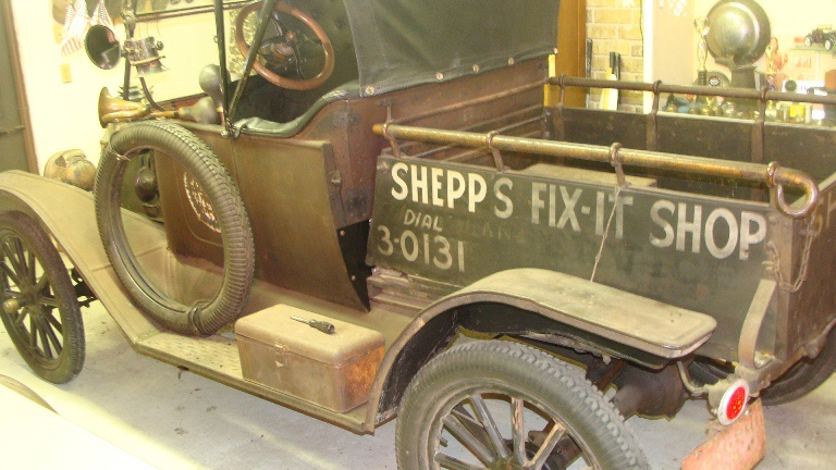

I agree with Dan. The Shep's pickup body wastes a lot of space and does not line up well with the body. there is no reason why the sides cannot be angled outwards to follow the line of the body. If those sides are made with substantial boards, a straight mounting rod can be used from the fender to the sideboard. It does not have to look like a box.
