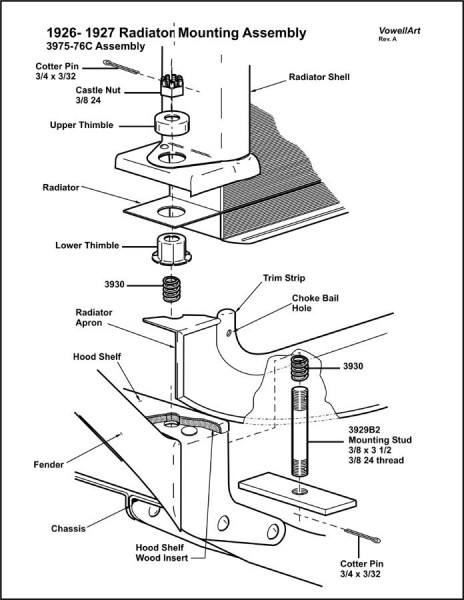

Restoring a depot hack and the PO just cobbled this thing together, so how it was does not mean the way it should be. I've got the front end sheet metal pieces:
radiator
front apron
two hood shelf/engine pan triangles
front fenders
Starting with the frame , going up, up, what would be the correct order of assembly?

Fenders first, then hood shelf, then lower radiator apron, then radiator.

And, if the correct hood hold down springs and washers are used, the hold downs may be installed in the hood shelves and blocks before installing the shelves on the car, which is somewhat simpler than compressing the springs after the shelves are installed. jb

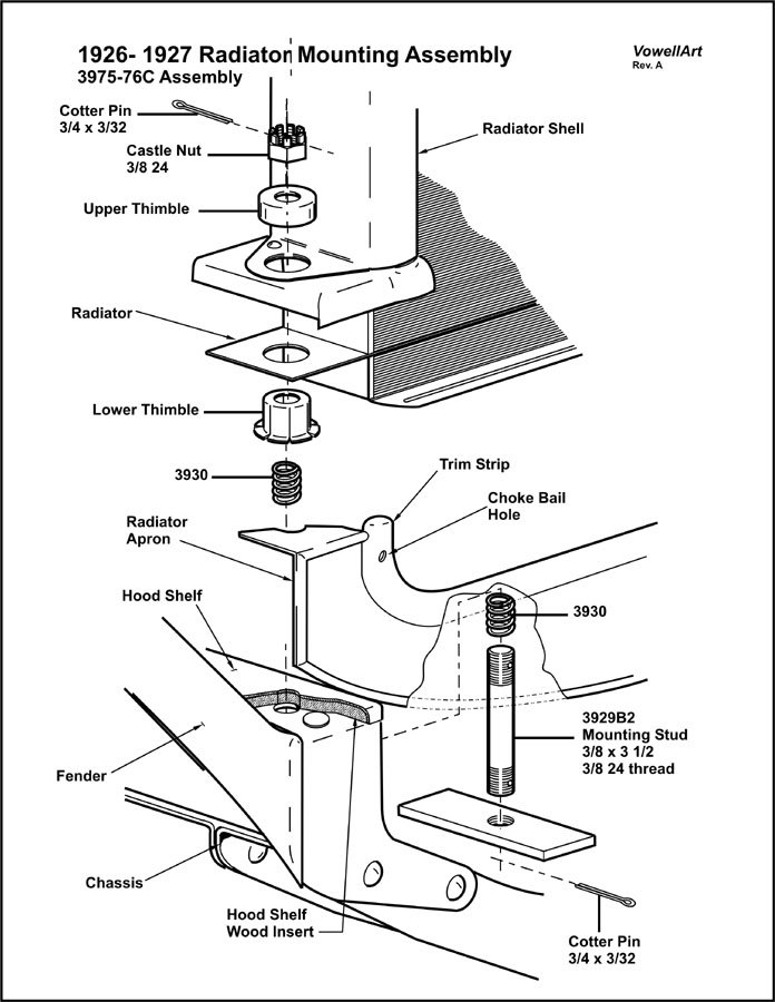

I just completed this assembly on my 1927 Roadster using the VowellArt diagram. It helped to precompress the bottom springs on the radiator studs by placing washers underneath the lower end of the mounting stud. 3 or 4 washers did the trick for me, though it takes some effort to get them in there. Those springs are awfully stiff.

To compress those radiator springs, I just took a wood wedge and tapped it in to to the trick. Once the installation was complete, they were easy to remove.
