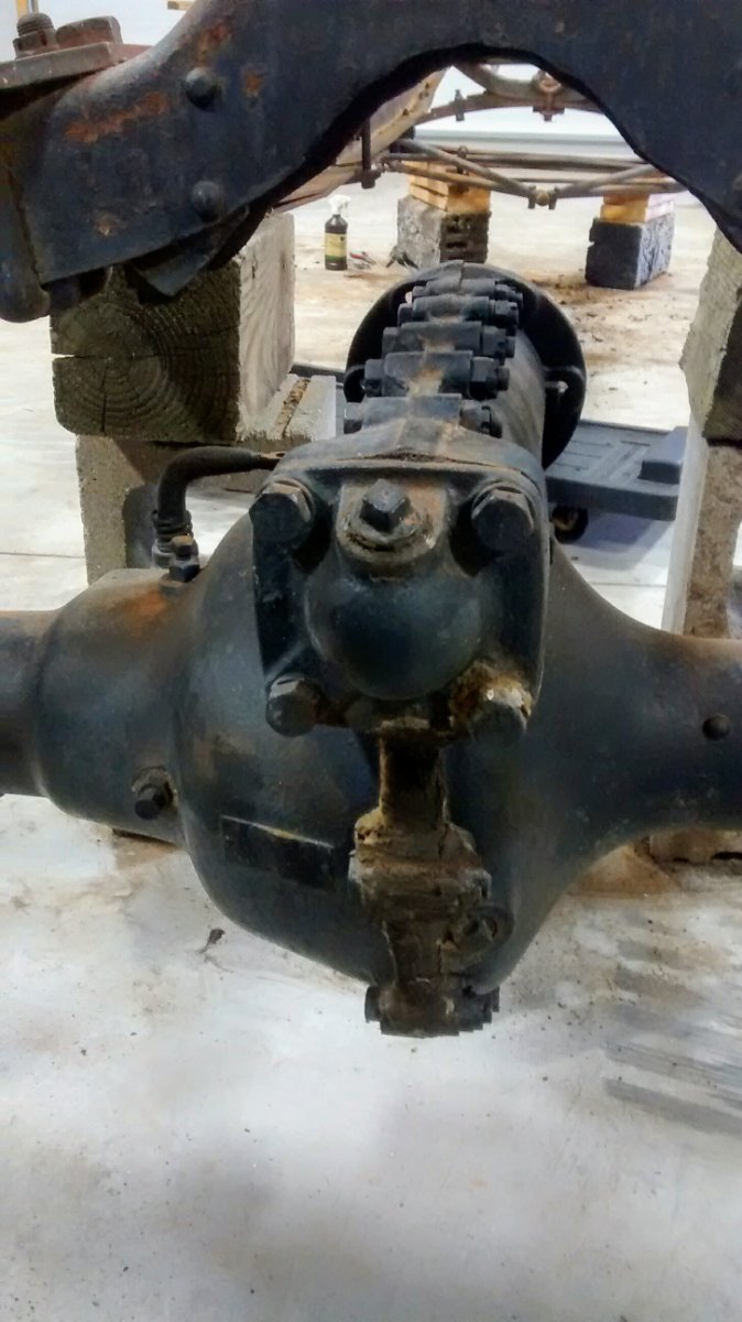

What is the plug on top of the end cap for? Do you put some oil in there also?

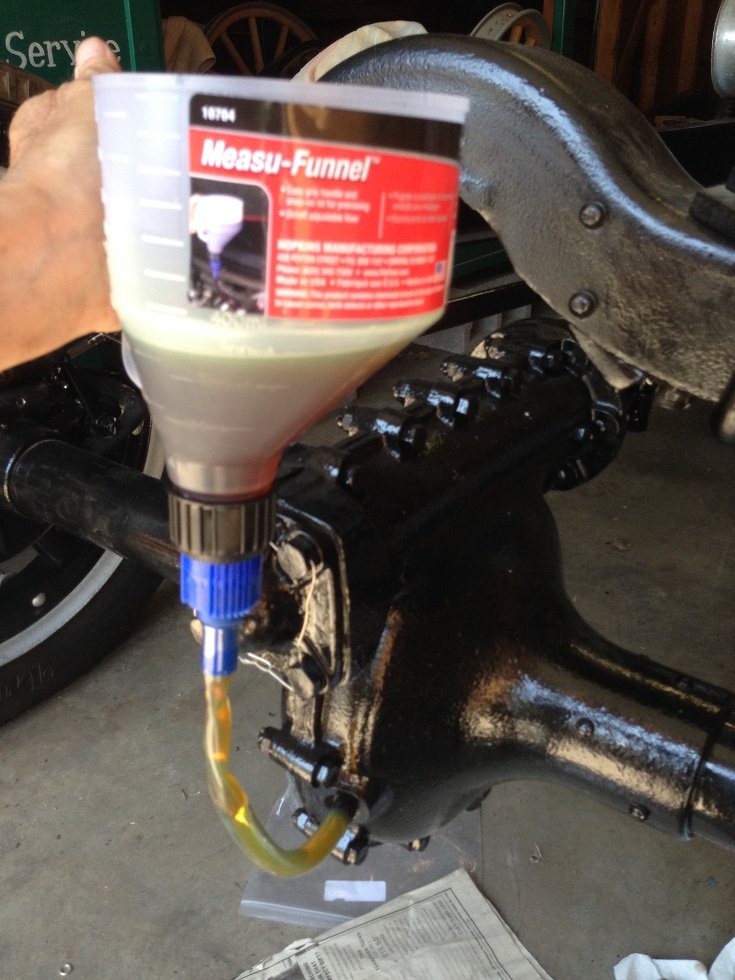

For filling the TT rear axle through the filler plug on the housing I used the procedure pictured below.
