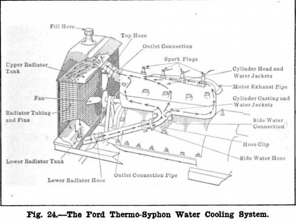

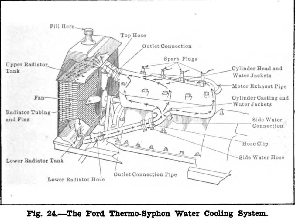

Re: Heating problem still
if the coolant is ga-lumping and coming out the overflow after turning off, it is too full
if the water is ga-lumping after turning off, but not coming out the overflow, it is normal
the coolant is still trying to absorb latent heat, is rising through the block and will naturally spill over into the radiator where it will cool and sink. Be thankful that your system is working efficiently. With a new radiatior and flushed block, the waterpump is making YOU feel good, not the engine...when not running, the impeller is an impediment to water flow during the post-run cool down period. That said, I am not anti-waterpump, as I have one on a car with an inefficient radiator and it has saved me the cost of a new radiator, so they have their place...conversely, I ALWAYS remove the pump immediately after purchasing a car and have found the vast majority of them did NOT need it, though this ONE car did and I am perfectly fine with that idea.
