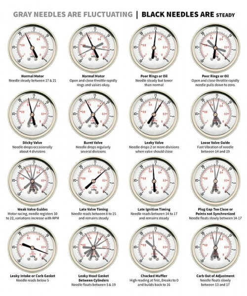

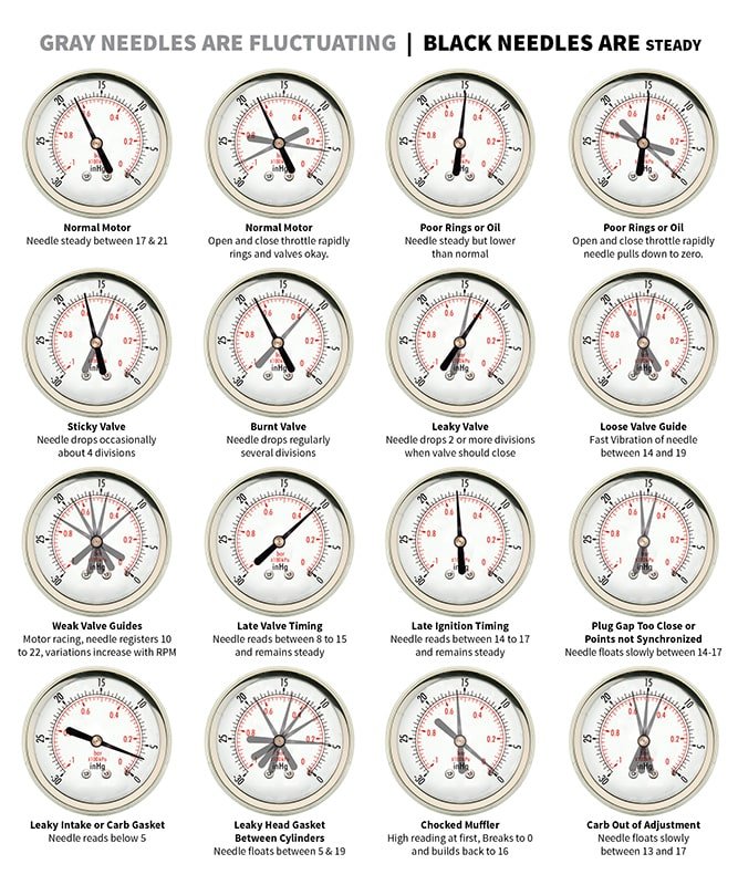

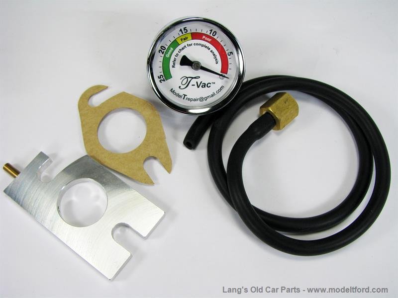

for leakdown on a model T I would think you'd want close to cranking compression for your pressure - 50 to 60 psi, no more. Then adjust to see what the leakage is. 20% should be the limit.
I've recently become a fan (again after many years of not using one) of vacuum gauge diagnosis. The vaccum gauge will show a leaky or stuck valve, though the leakdown will pinpoint which valve specifically

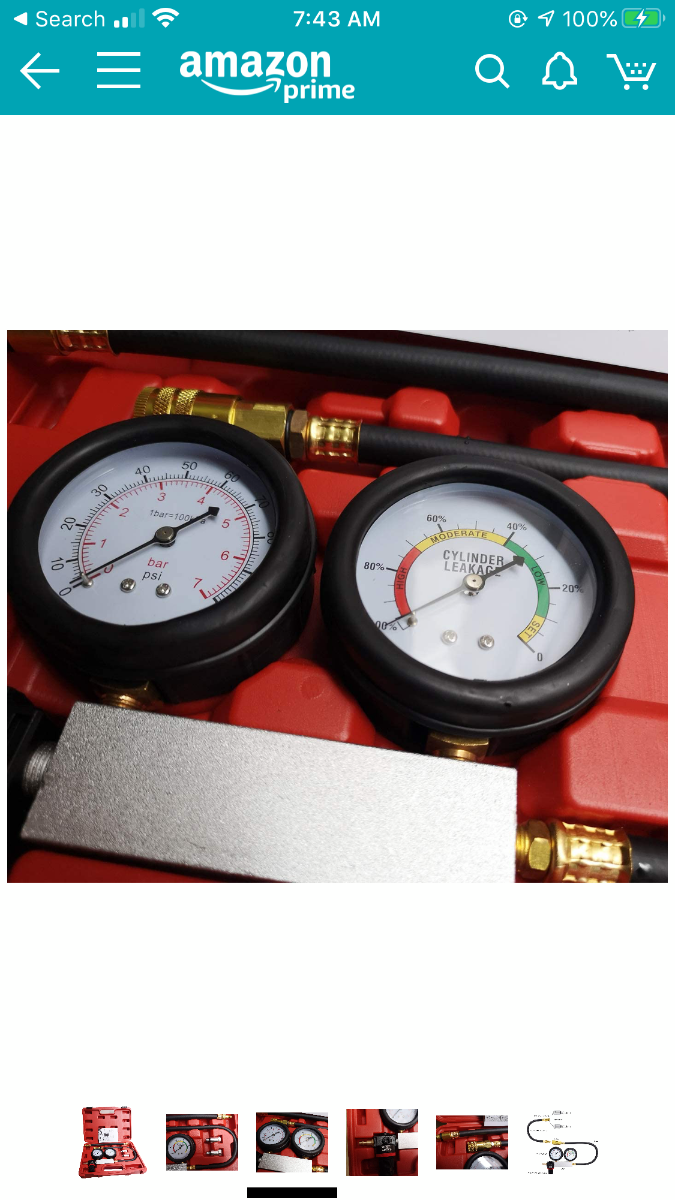

I used this leak down tester from Amazon. I just ordered a compression tester too, since they’re pretty cheap.

Do you think that using this leak down tester is not a valid test then?
Steve
Steve
- Posts: 5549
Re: Leak Test Results - What Now?
I wondered if Ron had done them. Great!
Ok now we are on the same page re the %, learned something new. I looked up how this tool is used, but don't see anything about cranking the engine over when doing the test, just bringing to TDC, pressurizing the cylinder, checking for air leaks and reading the % gauge after a few minutes.
https://shop.advanceautoparts.com/r/car ... w-to-do-it
Now that some of us that didn't know can see what tool you are using. I would think leaving out the cranking the engine over when doing the test should be fine for the type of test you are doing. Without seeing the instructions that come with the kit may be a different test that may or may not apply here. Did you make your own 1/2NPT to 14MM adapter that I talked about last year?

No, I have no equipment or knowledge to make the adapter, bought one from one of the Model T parts suppliers (don’t recall which one).
