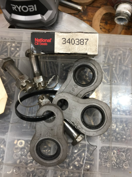

While I haven't got mine together yet, I've got the proper tooling to machine the recesses to add seals to the pedal shafts and starter bushing.
Here's an example of adding seals to the pedals using the National 340849 seal.
https://modeltfordfix.com/how-to-keep-y ... territory/

BE_ZERO_BE
- Posts: 662
- First Name: BOB
- Last Name: CASCISA
- Location: POULSBO, WA
Re: Any way to reduce hogshead leaks thru pedal shafts
Here is a solution from a friend.
Respectfully Submitted,
Be_Zero_Be
