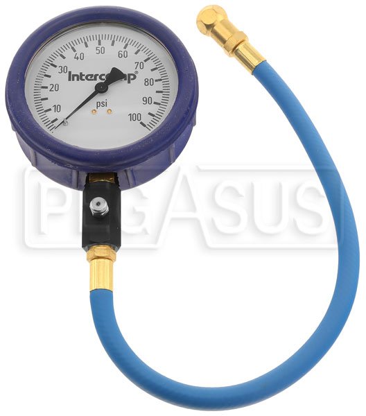

Re: Source of 100 PSI Compression Gauge
I don't think is NECESSARY, but in my case I thought it would be "better"
there are generic 100psi air pressure gauges out there, but they all seem to be 2" I figured I'd buy a 100psi tire pressure gauge / hose kit and put that gauge with my compression tester
alternatively - I realize now that I could cut the end off the tire gauge hose, and crimp a 1/2" pipe fitting on, to create a Model T specific gauge

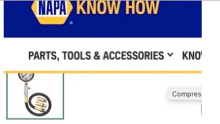

Same here, the 300psi works for the T, unless you want so much accuracy, you better get an expensive pressure guage with certificate.
I just use the normal low cost unit from say NAPA, and change the ends , as they are pipe threads, to a 1/2" male pipe thread for the adapter to Model T spark plug hole. These testers have the handy button lock and release for easy tests.
IF you have to have a small range gauge, then McMaster Carr has bunch of psi, from 10 to 150 styles, 2", 3" and 4", the basic ones are $10-$15. Just replace the gauge of your tester.
McMater Carr units:
McMater Carr units:
