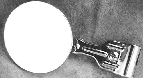

Does anyone make a nice mirror that mounts to the two bolts that hold the windshield frame to the body brackets? I'm not happy with the clamp on ones I have - The angles you can set them at are limited and even though I padded the clamps with rubber they tend to move on the window frame.
This is what I have

Scott & Tim : Using the mirror you have, position mirror to your liking, then drill thru clamp bracket at windshield stanchion and insert self tapping screw to stabilize mount.

Cut the clamp section off and make a snug fitting angle that attaches to the pivot bracket.

I've tried everything from a piece of old innertube to a section of heavy duty rubber hose. I've glued them in, I've wired them in, they always "migrate."
The other problem is that the head only allows minimum up and down movement which makes them hard to adjust. Nonetheless, I appreciate the ideas.

If the most movement is up/down the windshield frame, then something attached to the frame above and below the mirror bracket should prevent that. Just a couple of turns of a thin strip of waterproof tape (Gorilla, other) should stop that (or hose clamps) . If you have forward back movement (wind forces) and you did all the things you said, my guess is that mirror clamp jaw profile, where you want it to be, doesn't match your window frame profile. Example like the jaws are to clamp something round and the frame is oval in its cross section or the reverse

I believe that Snyder's has a much better quality mirror, but although the arm is bright metal, the mirror head is black. I have the same mirror as the OP and it vibrates so badly that it is all but unusable. I wish the head was Chrome (or even better, Nickle), but I'm about to order one anyway.

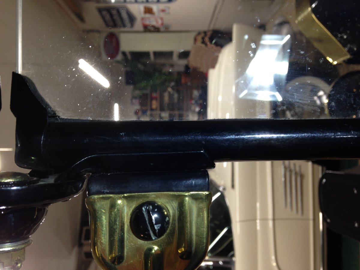

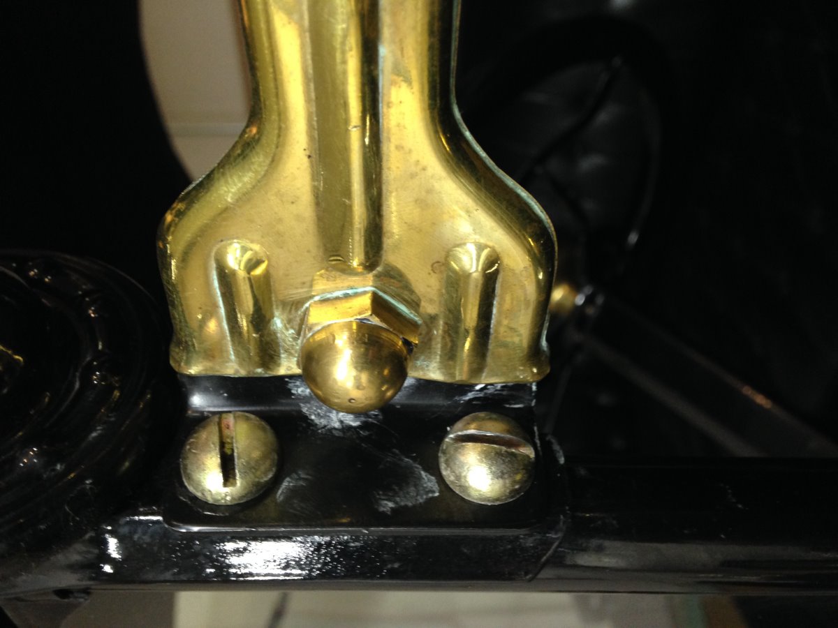

Bill Bohlen (Antique Motor Sports, I believe) produces a real nice mirror that bolts to the windshield hinge - brass or black.

Bob, how's the jiggle factor on that angle/hinge mount mirror? I like that.
Tim, I did mount a mirror to one of the windshield bracket bolts on the Crappy '24. Solid as a rock.
