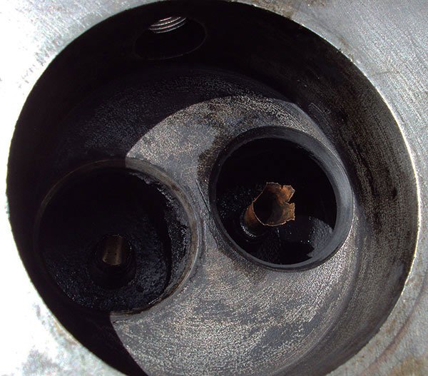

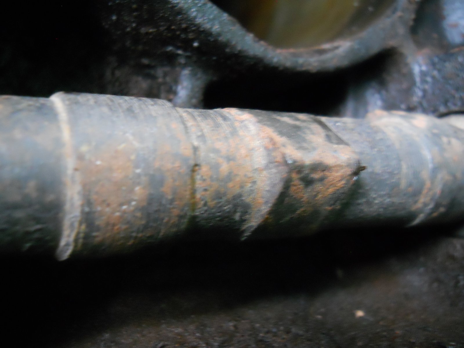

I took the Chevrolet overhead off last year because the exhaust valves were hanging up and was getting backfire through the carburetor. I don't think it was a spring issue as they are a little stronger then stock. I think I am running into maybe two issues; used wrong type of valve and might needed about .001 smaller stems. The seats are 3 angle with the contact area being about 1/16" wide. Looking at the Manley catalog and cross reference to the size I need, the closest match would have the 44 degree head for the exhaust type valves. When I installed the valves I used all intake type and as the photo should show, the exhausts are a bit burnt. The hang up may be caused by carbon in the guide or expansion of the head and or valve stem. This is something that came on over time, not right away. I am thinking a long the lines of getting the 44 degree valves and lapping them in, I don't have inserts. The seat are cut for 45 degrees. A little more back story; When I put this together I used 2 piece push rods with allen head cap screws on the rocker arms for sockets. Because of the size of the recess it is very possible that the push rod was shifting position and not allowing the valve to close all the way. When the head goes back on, I am going to go back to ball and socket, ball being on the rocker arm, but will keep the 2 piece push rods. Oh for ignition I was running the coils off the magneto and an OS-1 carburetor. The photo of the valves shows the intake, exhaust and new intake type valve.

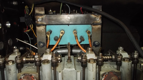

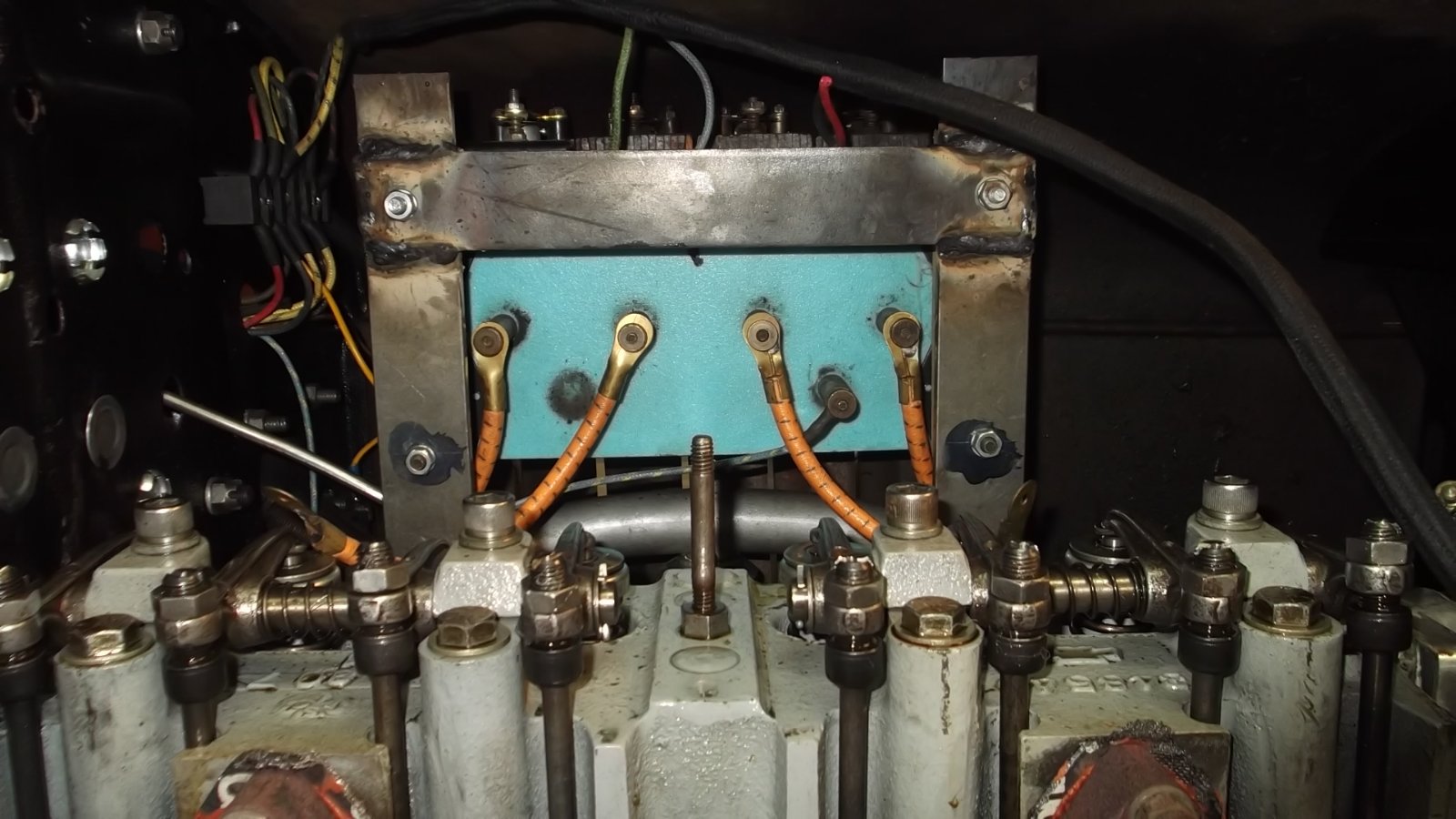

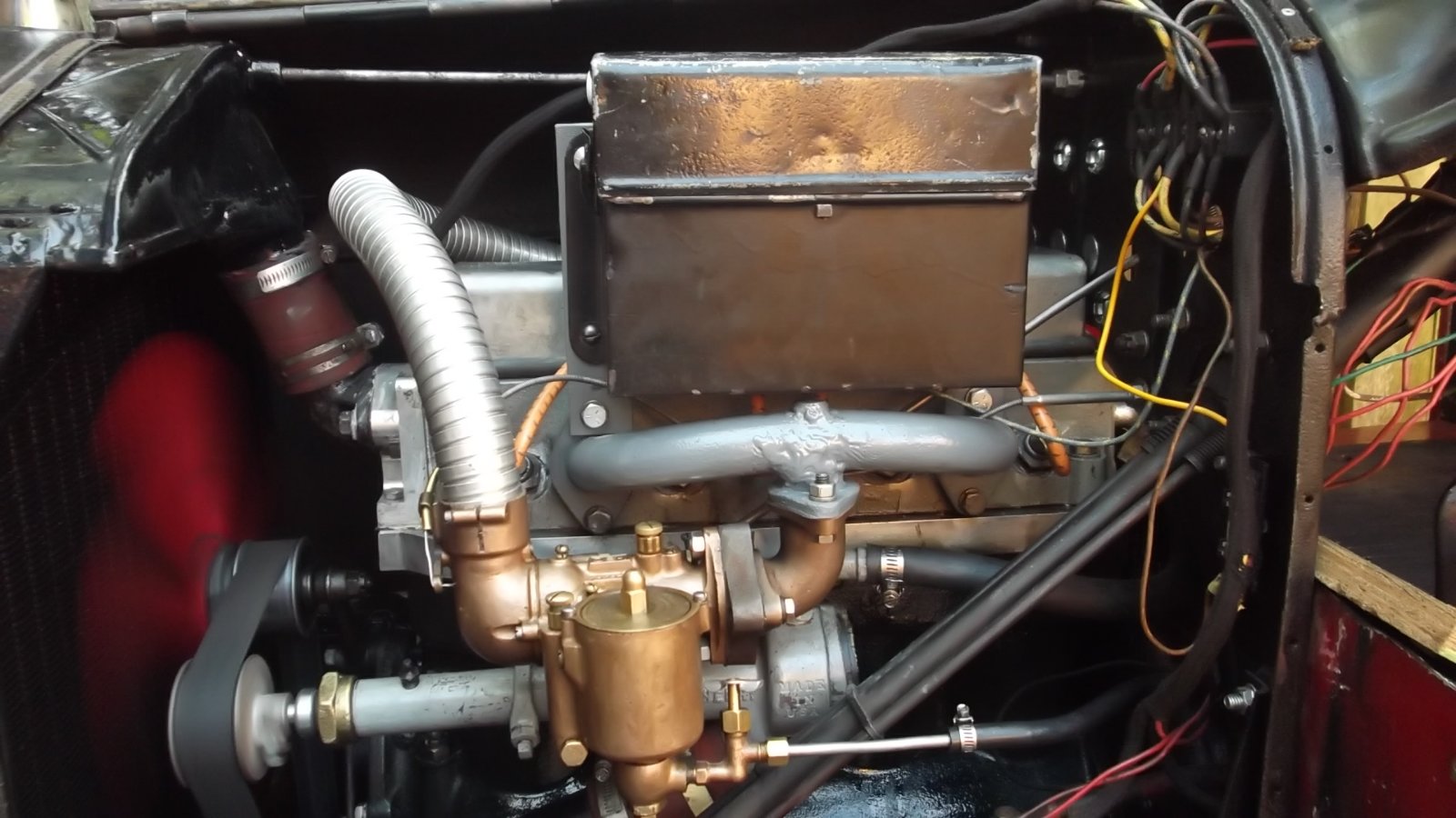

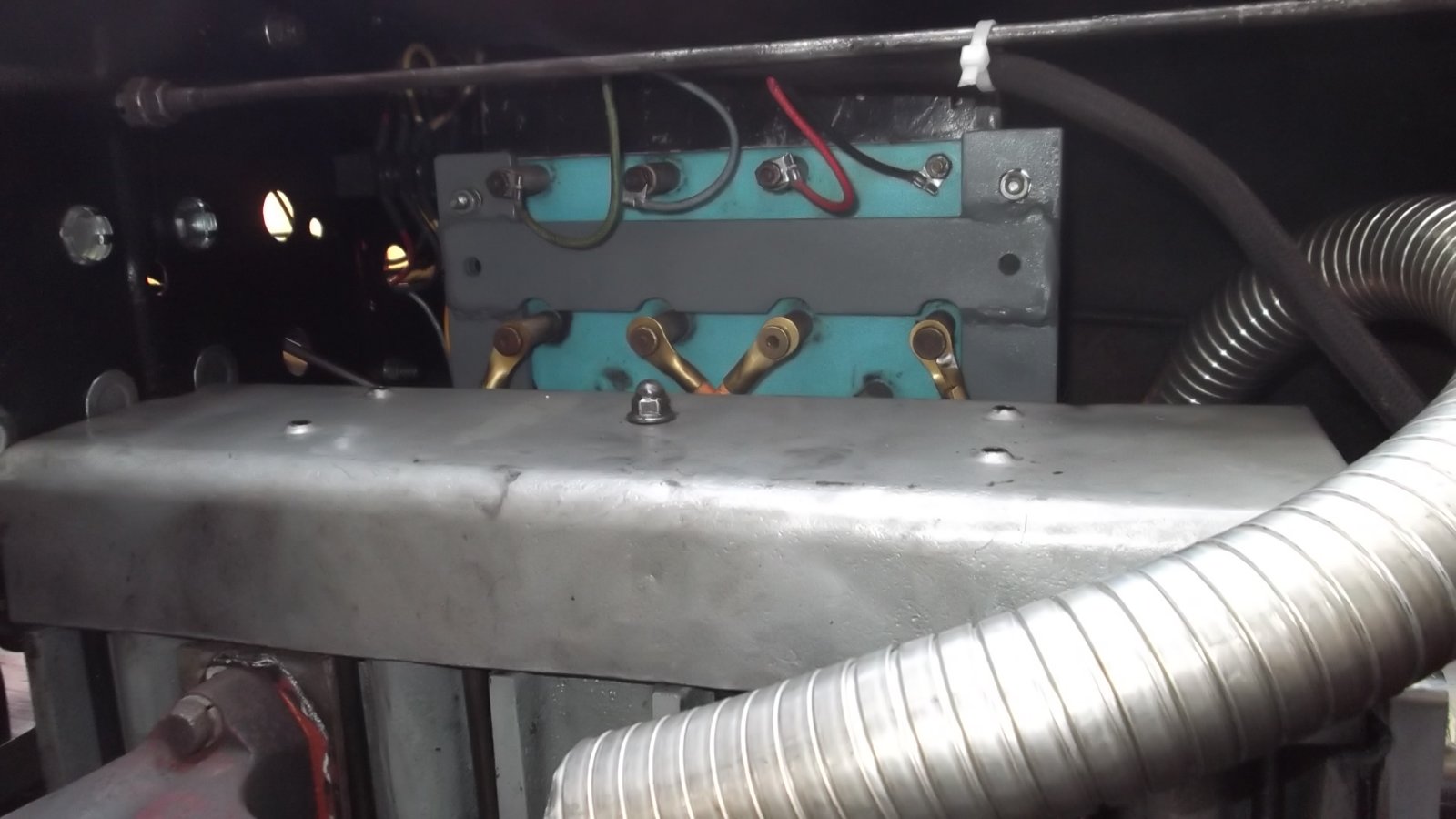

In case you are wondering how I mounted the coil box;

When I first started this project I was using the stock springs that were not as strong as they should have been with no issues that I could see or feel had the car up to over 50 on the flat and was using a VW 28 carb too boot. The springs I replaced them with when checked in open and closed were a little higher.
Here is the information I was working from;
http://chevy.oldcarmanualproject.com/ch ... o/2804.htm
Maybe I need to go back and recheck by installing a valve in one of the other heads I have, using the Chevrolet original setup to see if the measurements I was using work out. Quick check, the spring height both original and modern retainer is approx 1.721 with valve closed.

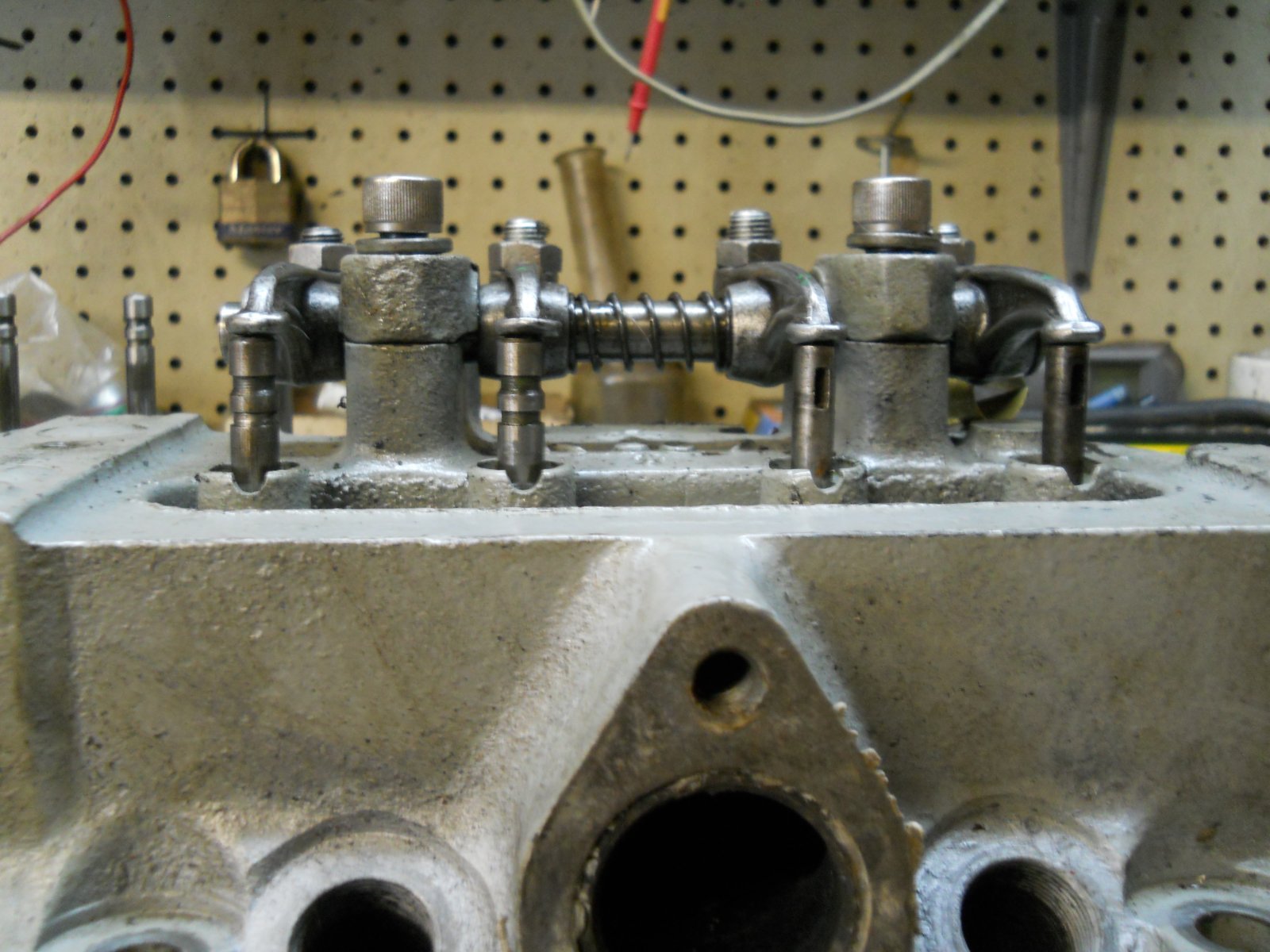

Give me a side photo of your #1 cylinder valves on top dead center. If your rocker arms are not set at the correct angle of contact, you are in a bind. Remember, that is a “B” series head, rocker ratio is 1.33 to 1 X cam lift. Sounds stupid but after they heat up, clearances close up and the tip of the rocker slips into a mild bind.
Just Saying been there done that. Sometimes rechecking the rocker contact alignment and slightly redressing the tips is all it takes. Your other specs sound Great Mark.

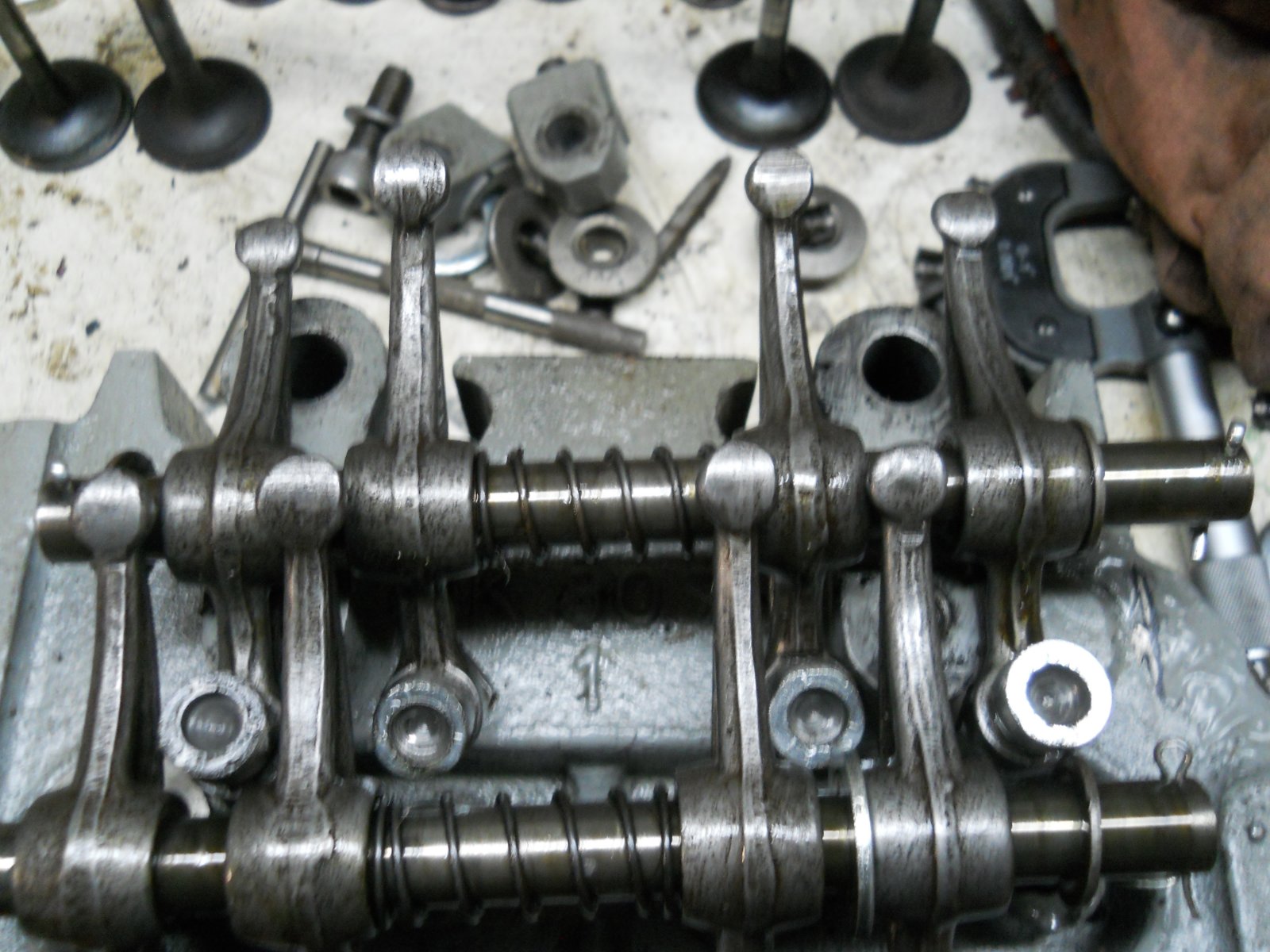

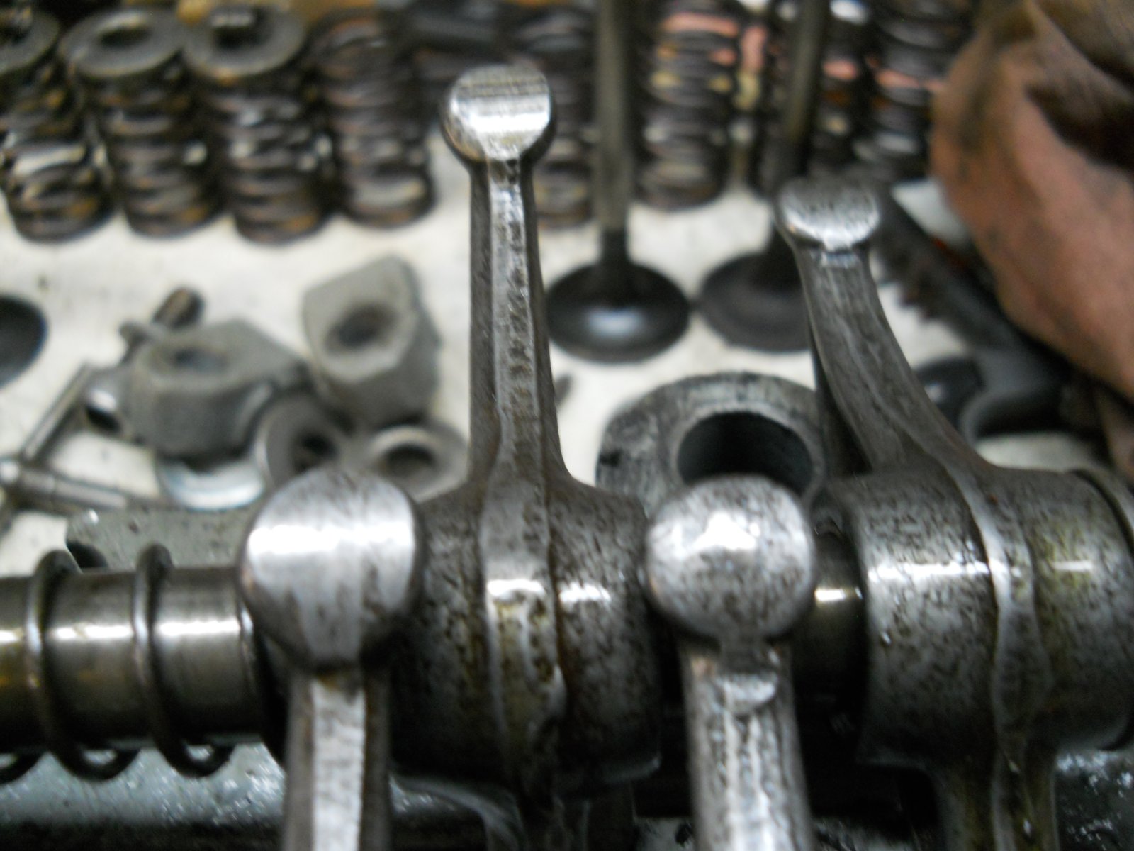

Got the B thing now. I thought the rockers were 1.5:1 on this head? Here are a couple of shots with the valves closed, No 4 are stock Chevrolet valves and No 3 are the replacements, I took shots with valves open but forgot to take into account the multiplying factor so will need to redo.

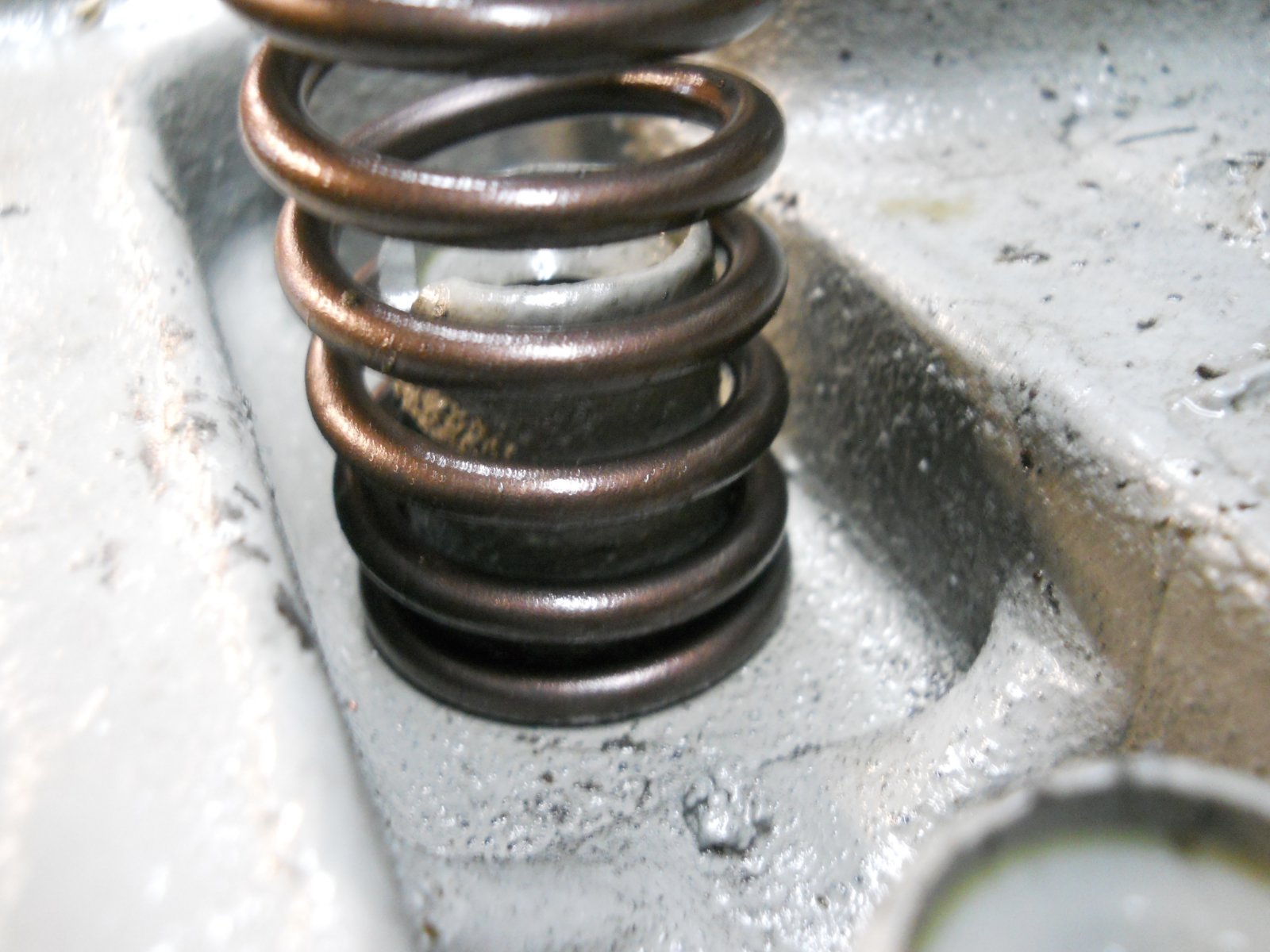

My calculations of the spring height at open is off, I was doing it at 1:1 not 1.33:1. I am going to take a break from it today, I need to get some other things done. Not dropping it and will get back to it shortly, maybe this weekend or later today. Oh by the way, I set my gaps with the engine up to temp, maybe not as warm as on long drive, so gaps should be ok.
Thanks guys.
Did a little more checking, the Chevrolet cam has about .190 lift (worn) X 1.33 put it in the ball park of the valves opening .300. So I was off. With a .260 T cam, that would be about .3458 approx that the valves open, so is greater then not less then the Chevrolet cam. Subtracting the gap allowance of about .010 would be about .335-.3358. My head hurts! ;)
While the base height of the spring remains the same at 1.721 and with a spacer on the spring I can get about 45LBS with the valve closed so now have to recheck what it will be with the valve open.

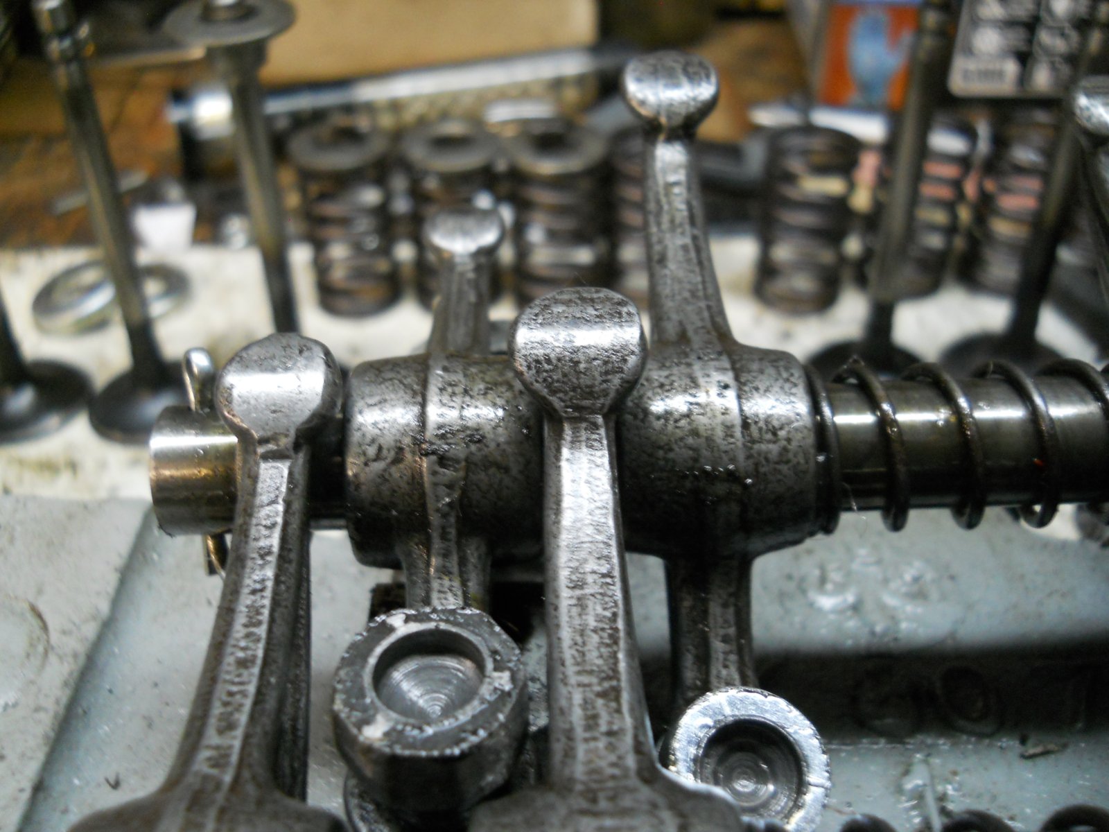

You do good work on taking pictures!

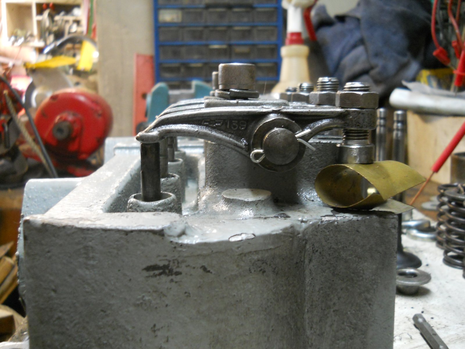

It appears you do not have enough radius grind/polish on the tips. Using a rocker arm attachment on an older model Sioux Valve Grinder to ratio angle would really help. Lack of angle/introduction causes a binding to occur thus preventing the valve to rotate naturally and will cause them to stick. I believe this is where your bad pixie is hiding.
Hope this Helps and all the Best,
Hank

RE the radius, I sorta was thinking about that yesterday looking at the pads. Not something I really know about but sorta can picture what and why.
https://www.ebay.com/itm/SIOUX-VALVE-GR ... Swxbhe1Dz1
I was thinking maybe some of the pads looked a little flat and that they might not slide/roll across the end, not thinking that it would causes problems. I will have to take a look in the Black and Decker we have at the shop, I did a long time ago when we first got it, might be an attachment that at the time didn't know what it was for. There are a lot of dodads and what-nots in the cabinet.
While we are on the subject of the valve train, I noted that the exhaust lobes on the Chevrolet cam are more flat across the end so the valve stays open a little longer. The intakes are pointed so they ramp open and closed quickly. Looking at a Model A cam that we think is full race, both the intake and exhaust lobes are a little flat too, but not as much as the Chevrolet exhaust. Would there be any benefit to keeping the same cam lift but getting the exhaust lobes ground to the Chevrolet profile?

Ok so I looked at the pads on the ones I was using, not as bad as I thought but need attention. The one, top row, 2ed from the right has cuts running through it. The rest if not radius-ed need to be smoothed. Looked at the other set in my parts, yck! They need even more work. The two cam photos are the 28ish Chevrolet cam. RE the radius on the pad, good info for anyone installing an overhead, RAJO etc.

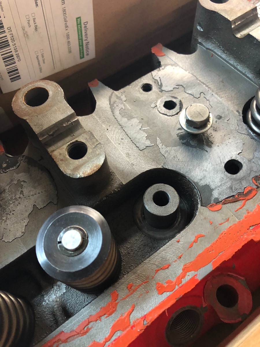

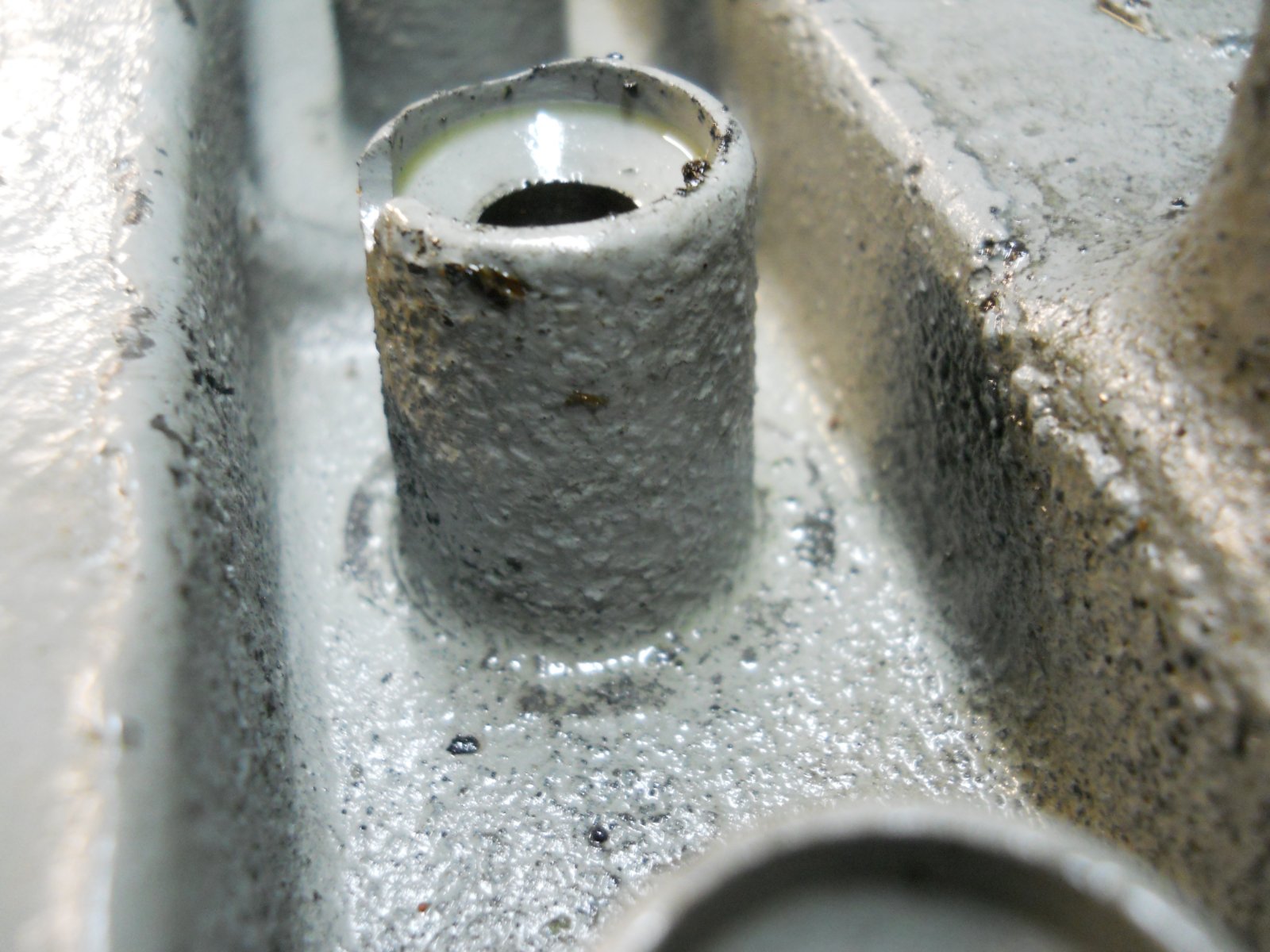

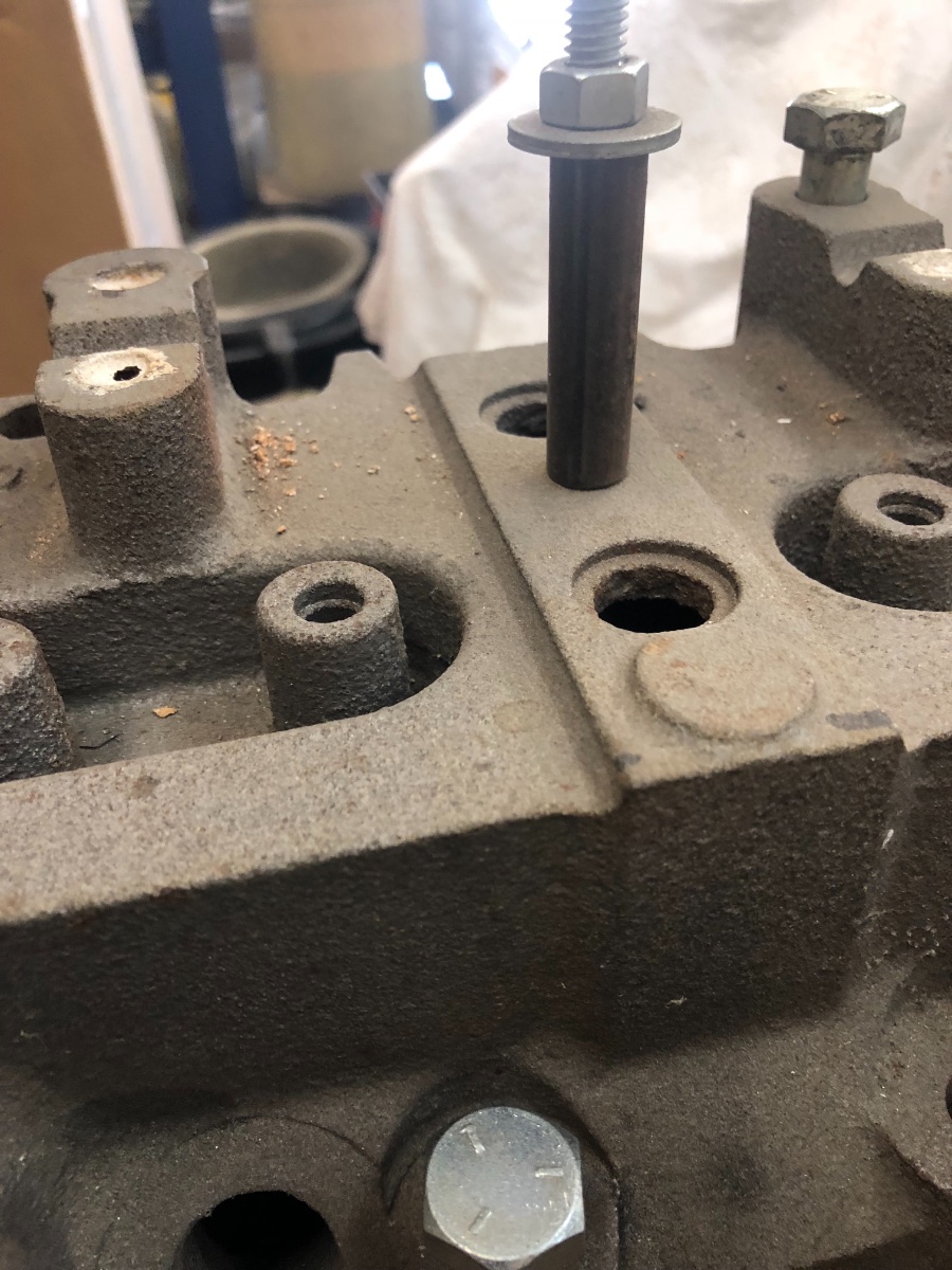

Here are some photos of a stock valve guide boss.
Here is after a trueing of the sides and decking to the main casting height.

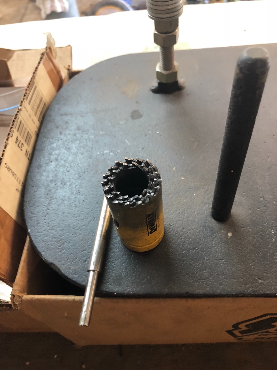

I make my own tool, using multiple bimetal hole saws glued together with JB Weld (it is only cast iron and cuts like butter)
Simple valve springs used.
Hope this Helps Ya'll!

When I did my bosses, I counter bored them, then drilled an oil well as original. The only reason I did the counter boar was because the modern spring retainers came down too far. I'll post some photos tomorrow. I agree on the pads needing attention. They are pretty snarky. Thank you for the information, I am sure I am not alone in needing this heads up. Should add, the valves shown are from the front two cylinder, the back ones don't look like that, they all still have shine on the contact surface.

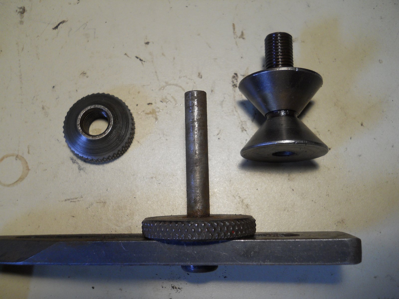

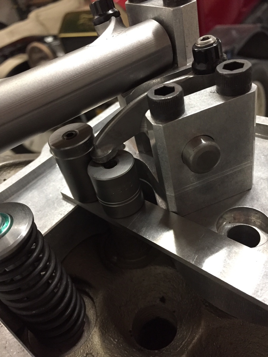

Post by Mark Gregush » Sat Jun 13, 2020 5:54 pm

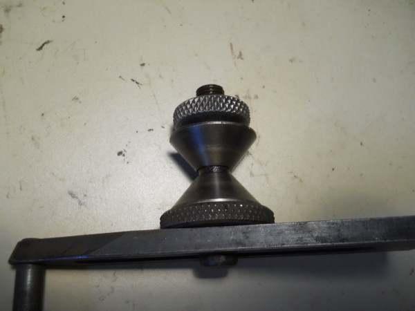

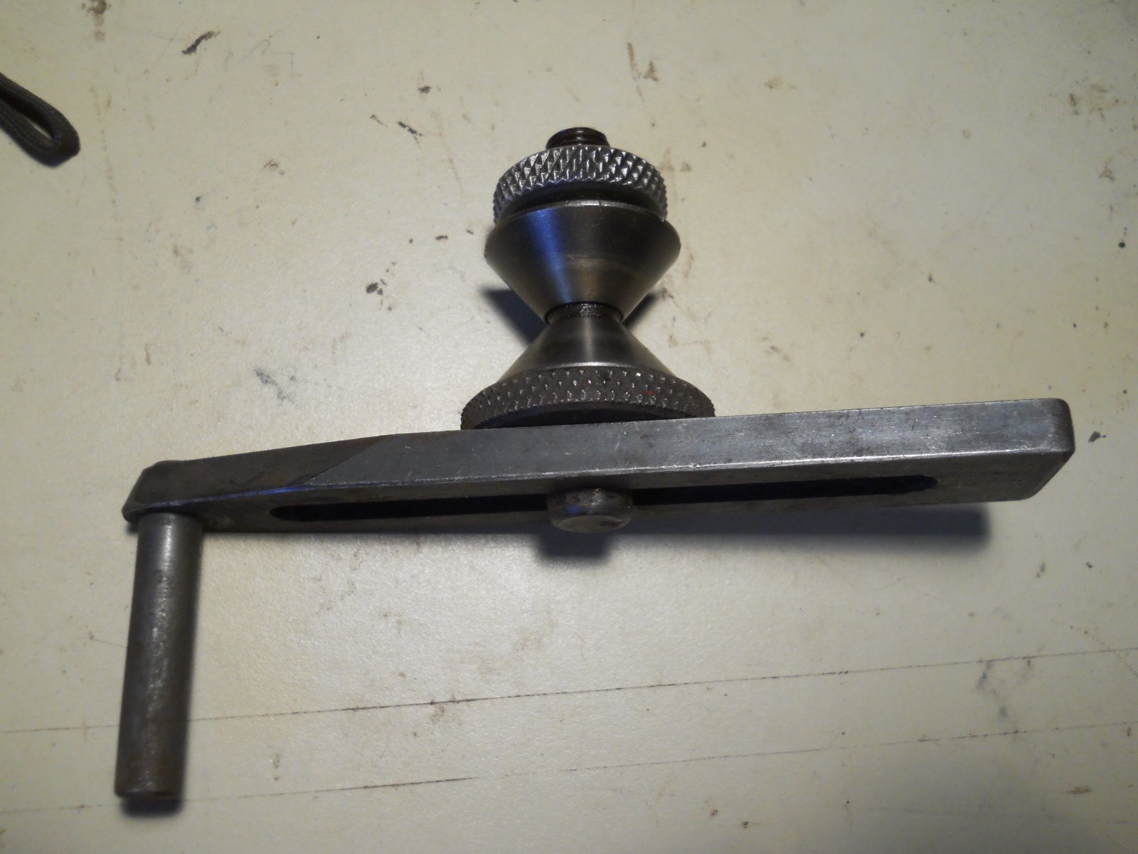

Few more photos. The Black & Decker holder for doing rocker arm pads and how I did the bosses. I am still working on freeing the adjustable cone on the rocker arm holder. I don't think it's threaded, if it was, there would be a flat knurled area to turn it. Tried a little heat and paraffin but she no move. The knurled piece at the bottom is not attached to the cones, it clamps the center shaft to the bracket, the top one is not attached ether, it locks the adjustable cone in place after the rocker is installed.
