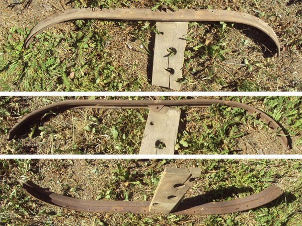

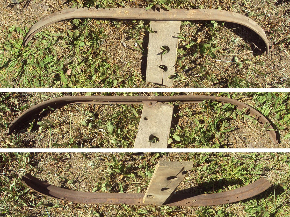

I posted a WTB thread in the classifieds looking for these parts, but I don't know much about them, so I figured I'd post here on the main board to try to gain knowledge.
I recently purchased a "rain gutter" for my wood dash '23 center door. In reading about that piece, I learned that there should be two vertical pieces - one on each side of the wood dash, below the hood hinge notches, between the cowl lacing and the wood itself. They appear to be little more than sheetmetal with a right angle bend, and some nail holes, but I can't find ANY pictures of those pieces off a car, or even pictures specifically of those "drip strip" or "drip edge" pieces on a car.
Can anybody enlighten me ?
pictures taken from other threads on the forum

Re: dash (firewall) rain gutter / drip strip
Post by Rich Eagle » Thu Jun 11, 2020 7:09 pm
This?
This?
no, not the top piece, the side pieces

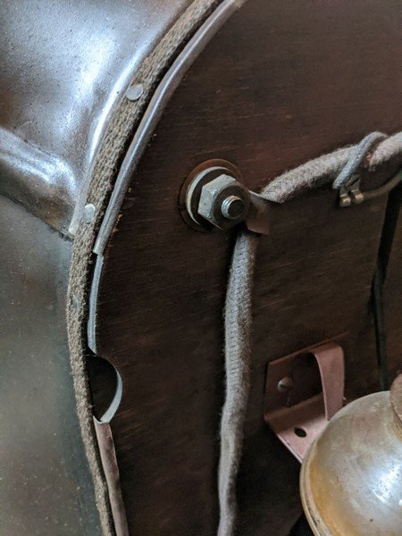

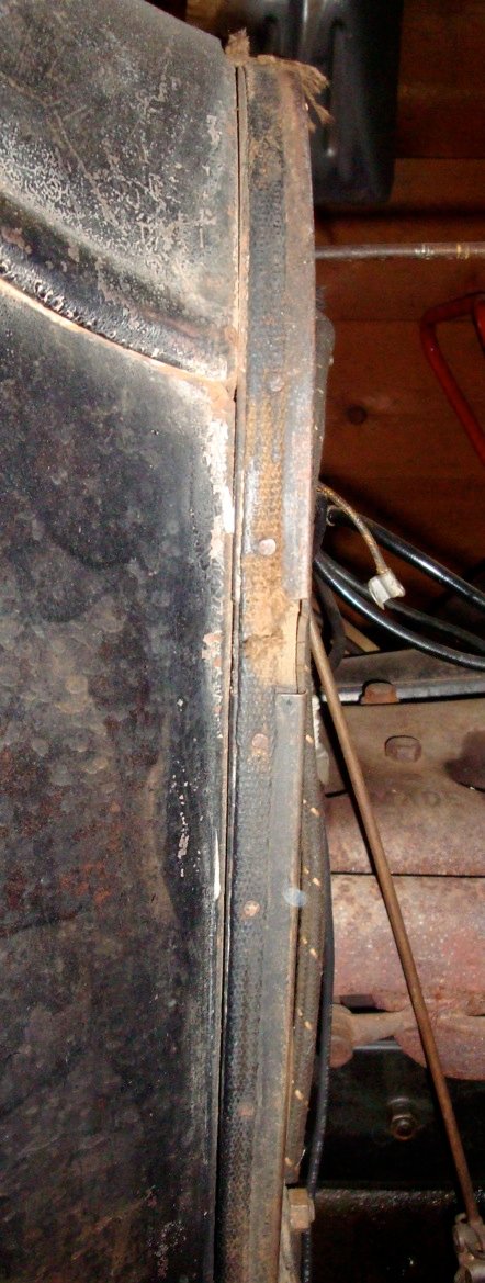

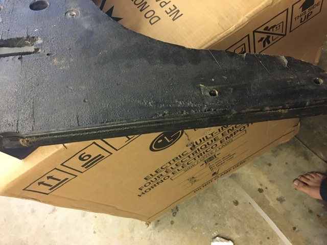

SleepyT
Posts: 58
Joined: Sun Feb 24, 2019 11:42 am
First Name: Russell
Last Name: Furstnow
* REQUIRED* Type and Year of Model Ts owned: 1921 touring, 1914 roadster, 1913 roadster
Location: Flagstaff, Az
Post by SleepyT » Thu Jun 11, 2020 10:15 pm
Here is one of the side pieces on what appears to be an original firewall.

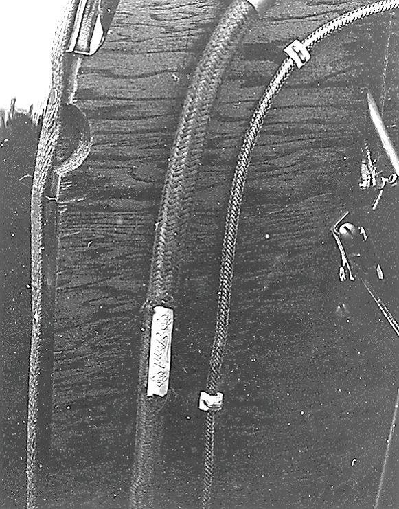

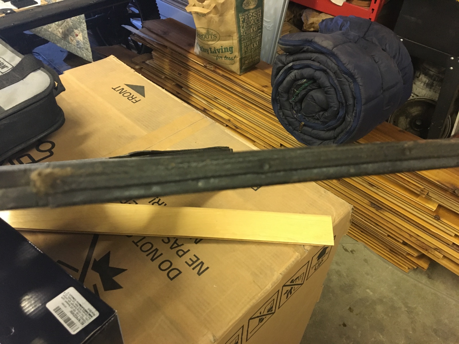

Post by SleepyT » Fri Jun 12, 2020 9:33 am
[image][/image]More pics [image][/image]

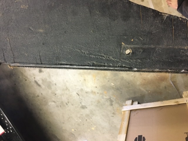

Post by Angmar » Fri Jun 12, 2020 6:19 pm
Here is a photo of mine on the 18. I was able to re-use my metal and the nails when I installed a new wood firewall. Took some work to get the nails out. (keeping with the old look).
