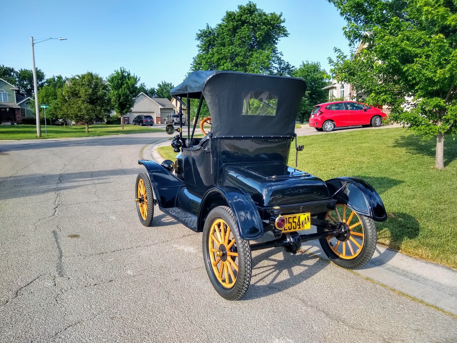

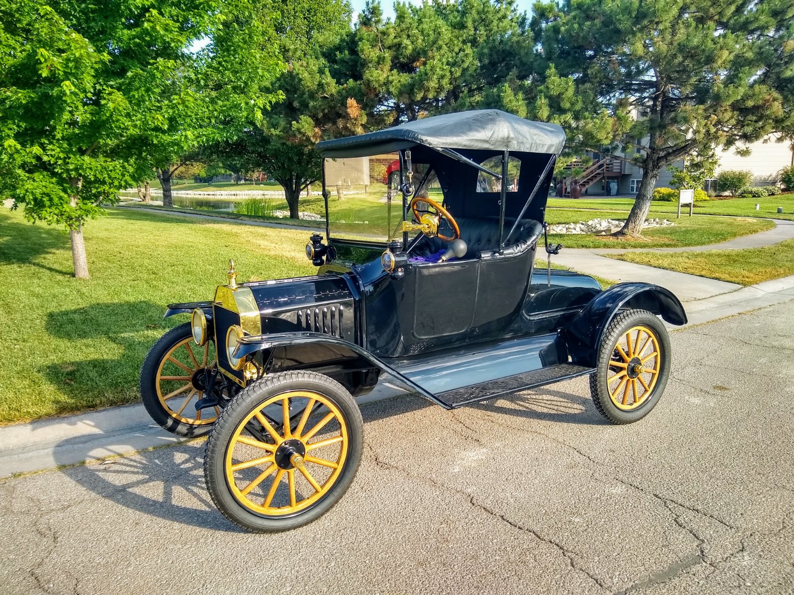

This morning it was in the mid 70's (compared to the mid 90's from my earlier posts) in the garage, as well as a few days since I last started the T. Continuing with my experimenting, I wanted to see how many pulls it would take to start without choking or richening up the mixture 1/4 turn as Neil does. It took three pulls on the mag to start. I went to get some gas, followed by a short drive. After gassing up I thought I'd try to see if my free start streak would continue when warm. Sure enough, it did. Customers may have wondered why I was using the "electric" start while I was standing next to the car...
Anyway, it was a nice morning for a drive and was also the first time that I drove it with the top up since finishing the restoration. The visibility is much better out the back with the bigger window right behind me than the 3 narrow windows further behind on our 21 touring. I wonder why Ford thought it would be a good idea to make the rear windows SMALLER.
When I got home, I stopped before turning in to take a couple of pictures and put the top down. With the top up, the bow just barely clears the garage door frame and is too close for comfort for me. After taking a few pictures, I turned it to battery an she started right up on its own. I thought I have gotten more than my fair share of free starts with our NH equipped 21, but this is ridiculous! Now if it will only start this easy during the winter...
Neal
