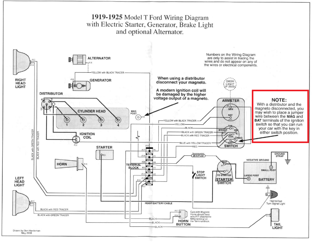

Do you have a fuse from the switch to the battery under the dash? Always helps to understand how the car is wired - extra lights etc Example diagram

Since you have trufire, you must be running on battery. If so, try turning the ignition on and see if you get current to the terminal at the bottom of the coil box. If you do get current there, the wiring between battery and ignition switch is OK and the switch and wire to the coil box is OK. In that case, your problem might be the trufire unit. If you get no juce to the bottom of the coil box, try tracing back toward the battery. If you have juice on the battery side of the switch but not on the coil side, your problem is in the switch.
- Posts: 6599
Re: Then there was smoke !
