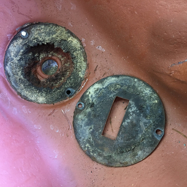

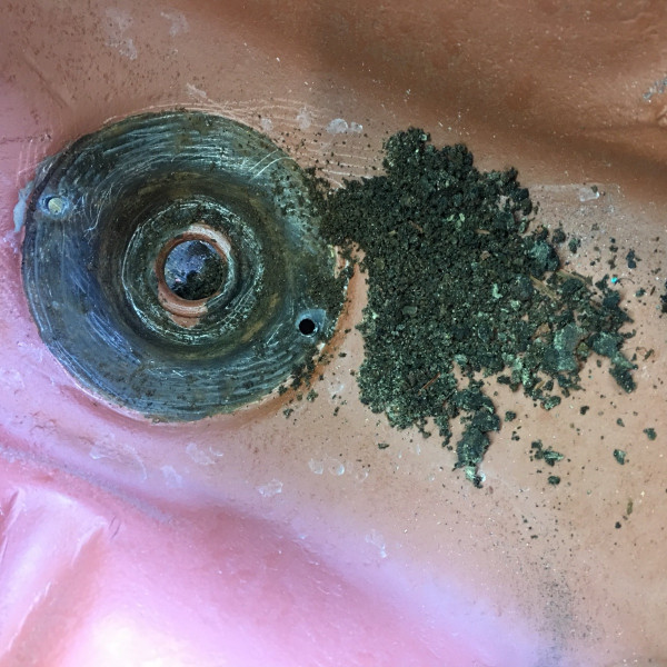

You Have To take the baffle out. Check this out:

Post by Kevin Pharis » Sat Jun 20, 2020 3:59 pm
Mopar_man wrote:
Sat Jun 20, 2020 3:22 pm
I want to go less aggressive and then a bit more.
It doesn’t hurt anything to leave a few $$ worth of solvent in the bottom of the pan for a day or two... but if you are critical about cleanliness today, you will still be critical tomorrow too. And if it’s “not clean till it’s clean”... you might as well take the baffle out now and have it clean and reinstalled (or leave it out) in an hour or so.
Rich Bingham
Posts: 1942
First Name: Rich
Last Name: Bingham
Location: Blackfoot, Idaho
Re: So how do I get this stuff out.
Post by Rich Bingham » Sat Jun 20, 2020 4:16 pm
The baffle is there for a reason. Over years, folks have found all manner of items in that “hidey-hole”that could have raised hob with the mag if they hadn’t been trapped there. Still, it would be a good feeling to know the pan was squeaky clean through and through ! (I’d put it back)

Post by Wayne Sheldon » Sat Jun 20, 2020 4:40 pm
Having over the years found a couple small bolts, a broken bolt head, nuts, several washers, a big cotter pin, in that little junk trap, no way I would recommend leaving the piece out! Like Rich B says, remove it if there is good cause to do so, but replace it. I braze them back in if need be. One early pan I repaired had had water sit in the bottom, and on the ground for a bit too long. The junk trap rusted away, and the tea cup rusted through part way around. I brazed heavy sheet metal shaped to fit around the tea cup, then made a new junk trap and brazed it into place.
