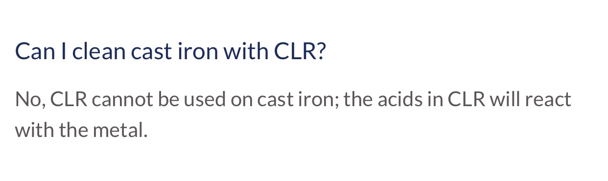

Has anyone used CLR to clean out rust from a Model T engine block? I just saw this on CLR’s website.

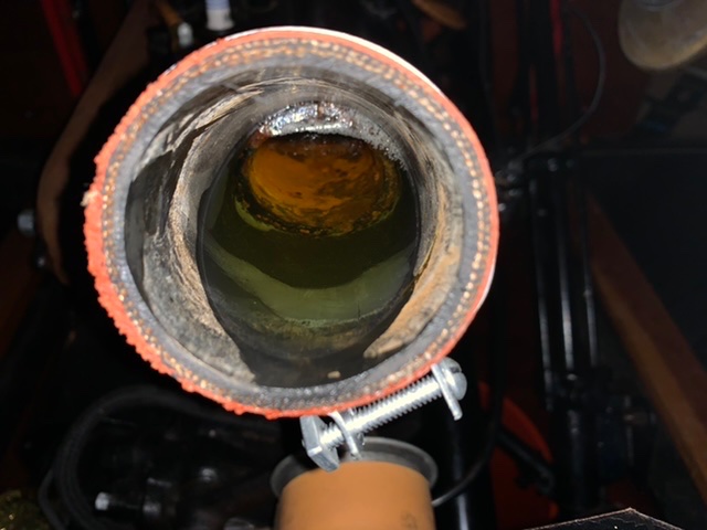

To clarify, there is no radiator connected to the T. This is just for the water jackets in the block. It took just under a gallon to get the level where I needed it. I’ll flush it with water after the soak and might use pressure as some have suggested.
Hoping this will not only assist with cooling but with get rid of a lot of rust and debris I don’t want floating into a new radiator. I’m sure it won’t get all of it but hopefully it vastly improves the situation.

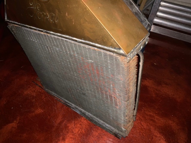

John, this is preparation for a brand new radiator as the old one has crossed over the line of being in rough condition.
Scott, here the pic of the old radiator.

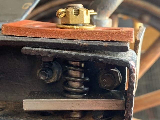

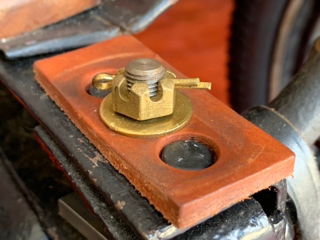

Is this correctly setup? If not, can someone please post a pic of this same area so I can ensure I have the correct support for the radiator when it comes time to mount it?
I look forward to when Model T events start back up so I can attend to see other Ts in person and learn that way.
