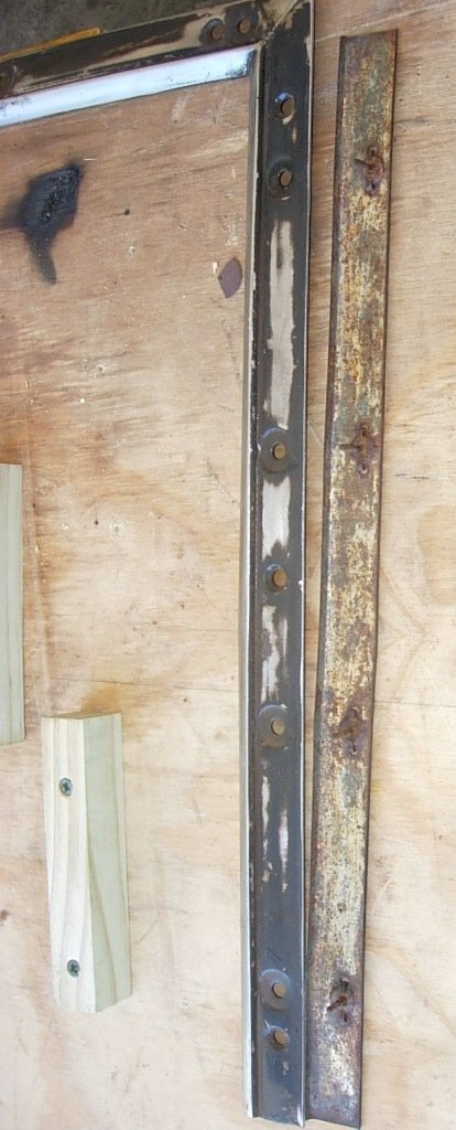

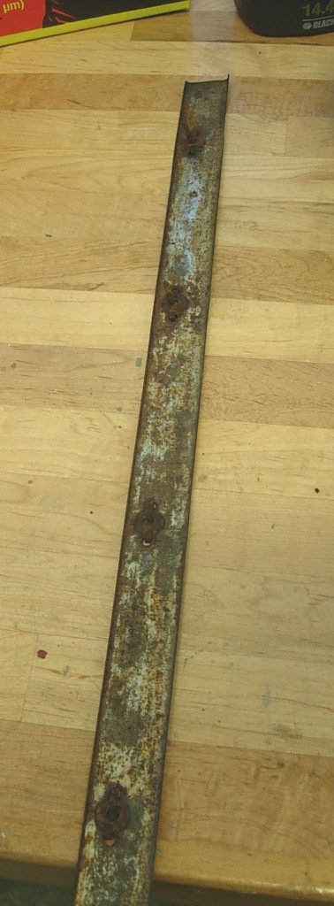

Seeking to see if anyone is producing a metal insert that is covered with cloth and snaps in place between window and door latch post.
The insert is 18 5/8" long and 1 1/32" wide, formed in a "U" shape with one side 0.160" and the other side 0.070" high, metal thickness 0.030".
Here is picture of the window frame and metal insert.
