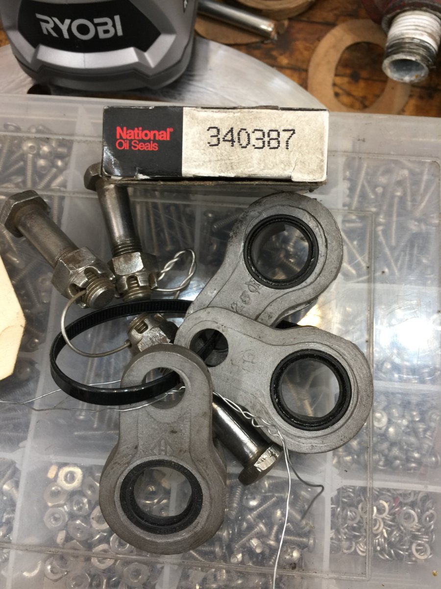

Here is a solution from a friend.
Respectfully Submitted,
Be_Zero_Be
Be_Zero_Be

I did the o-ring thing to the hogshead on my 11 touring. Both on the shafts and clutch shafts (from the inside). I'm glad to report they still weep oil. A proper lip seal is a better alternative. I rebushed and used new shafts and supports. Somewhat frustrated after all the work I did.
