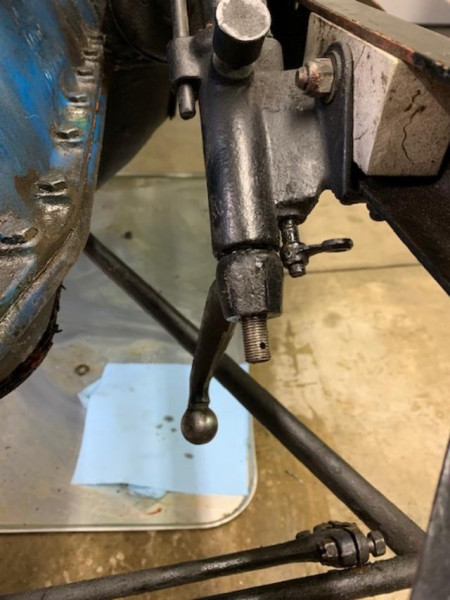

Looking for some wisdom, as a new Model T (1923 runabout) owner, to how I can safely remove a Pittman Arm. The Ford Service Manual addresses using a brass or lead hammer but I haven't had any luck and scared I might damage something in the process. Any suggestions would be greatly appreciated.

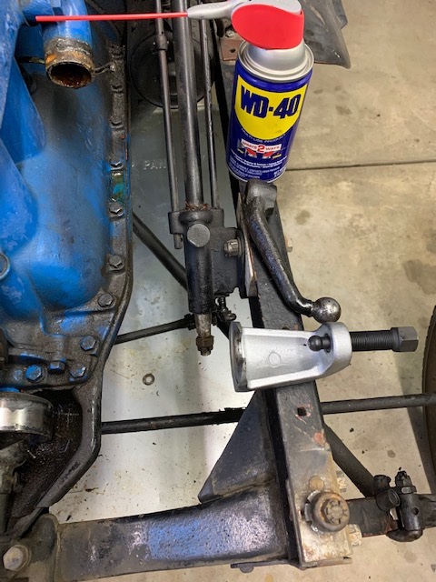

Last year when I needed to remove the pitman arm while restoring our 15 T, I followed the advice on getting the suggested OEMTOOLS 27175 tie rod end removing tool. It worked very well for me:

try a puller such as the one shown in Neil's post. You might need to remove the 3 bolts attaching the bracket to the frame so you can slide the bracket up the shaft to get better access for the puller. Tighten the puller and then tap as you would to remove the rear wheel hub. You might need to apply some heat, but not too hot or you will change the temper of the parts.

Just wanted to update everyone on our success and quick thanks to everyone for their help!
The Tie Rod End Remover Tool did great. Couldn't fit the swivel adapter in between so ended up using a 1/4 steel plate as a spacer to protect the drive shaft threading. Cranked it crazy tight, sprayed some WD40 on and walked away. Five minutes later we heard the steel plate hit the floor with the Pittman Arm!!!
Thanks again!
