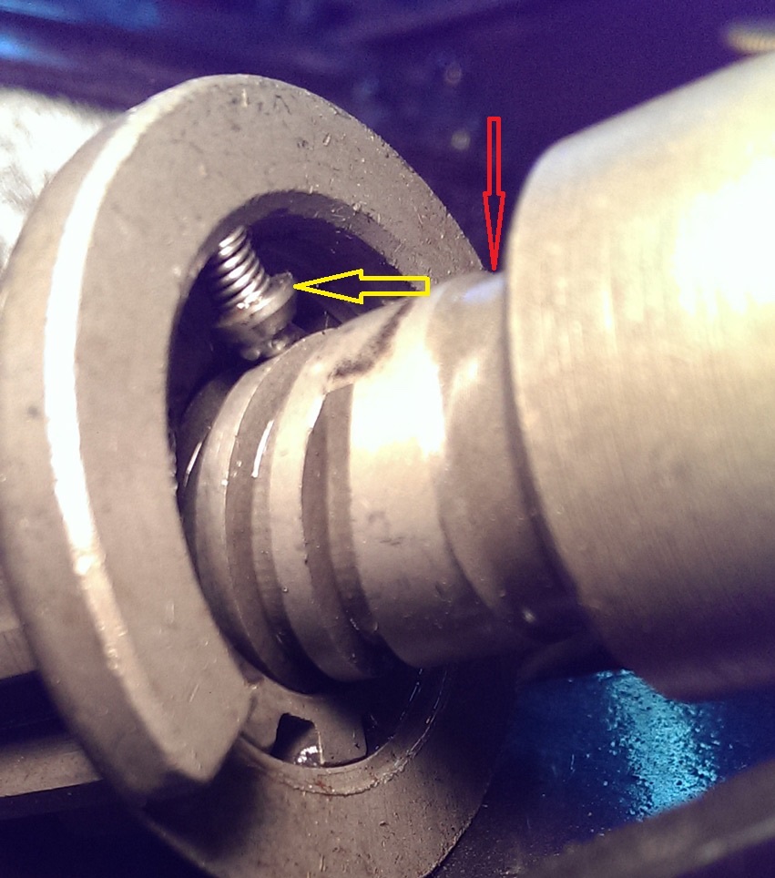

I had the same thing happen. Thought the starter shaft was bent, so took of the cover for a look. All OK and shaft running straight. It turned out that the Bendix cover just needed to be centered more accurately. There's not much clearance between the cover and the bolt securing the Bendix spring.
Posts: 7298
Re: Bendix noise?
Post by Allan » Fri Jun 19, 2020 12:45 am
Jon, there is very little clearance between the bendix cover and the spring retaining bolt. The bolts need to be the special type with the head just half the thickness of usual bolts. Check the inside of the cover for any register marks where things may have come together.
Occasionally, I come across bendix springs which are heavier than standard T issue. This will also position the bolt heads closer to the cover due to the thickness of the spring.
