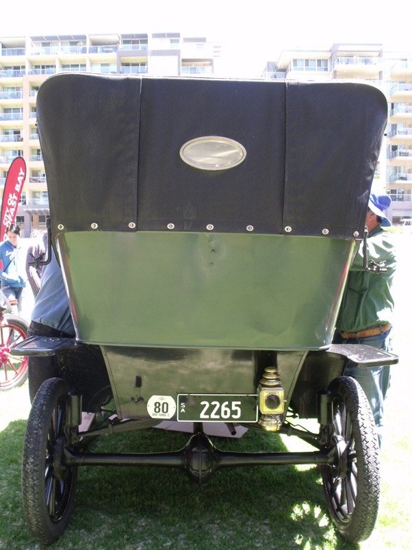

I was looking through photo's I have saved of the years and I see that on Mr Mullins 1912 car his tail light was on the right but there is a light bracket on the left . Did he have 2 tail lights at some point? The other question is are your tail lights right handed and what I mean ,is the blue lens still facing out and the clear facing in. I have been looking at internet photo's from clubs across the pond and Germany, Australia and seeing left hand lights on the right side or 2 tail lights but both are left side lights , is there a right handed license bracket Cheers Colin

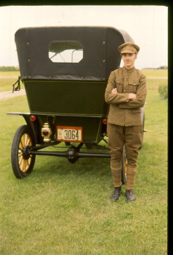

Yes I would, I have made a right hand light and I am going to add it to my 1912 T I know its not correct but the more red when you hit the brakes the better. Distracted Driving here in Winnipeg Canada is a big problem. The picture was me in 1977 doing a local movie about going to war . Cheers Colin

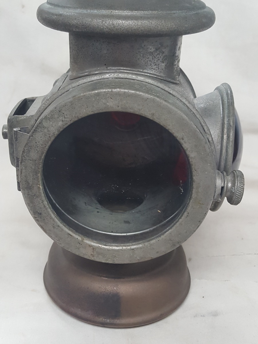

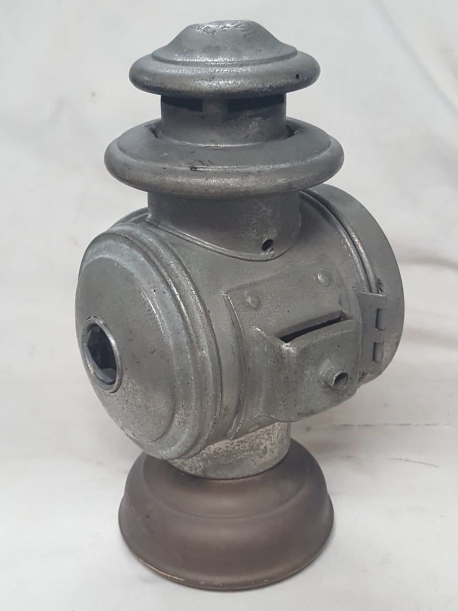

This is a Gray & Davis tail lamp that I sent to Australia for use on a Cadillac. It probably originated in Canadian Provence that drove on the left.
It too is set up to be mounted on the right side of the car.
