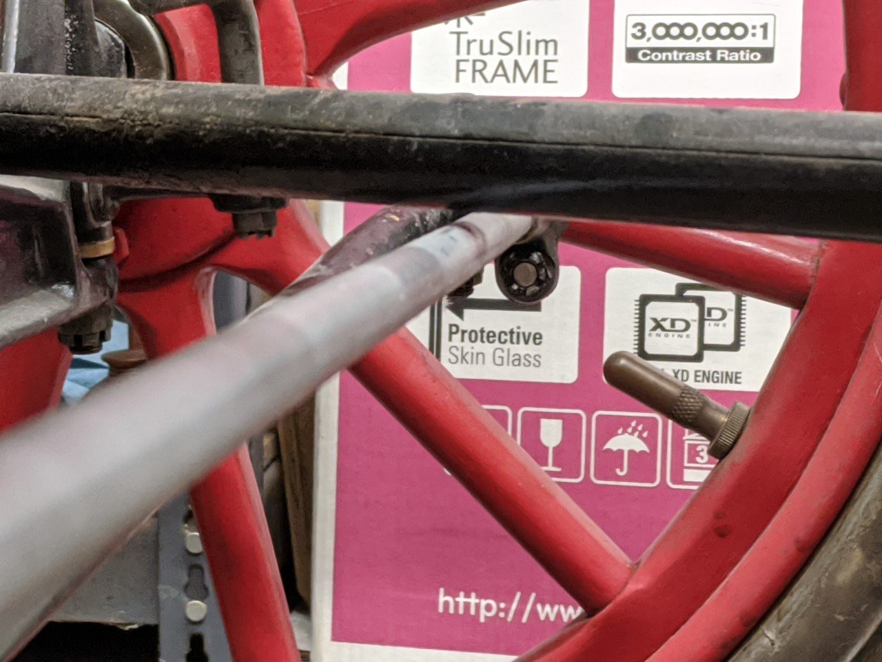

The tie rod is about 1/8 to 1/4 at the most from the wishbone. I would think that over time it would bend or break.
The only solution I see is taking the steel steering shaft to my welder and having him extend the shaft about an inch.
Do any of you know what to do or think it is too dangerous to let go.
This is a 1912 torpedo restoration.
Thank you in advanced, Bob

that is a drag link.
If that is as close as it gets, why is it going to bend or break? There are no sprung components which will close that gap during operation that I can fathom. If you have that described gap when the wheel is turned hard to the left, I think you're OK.
My guess is that your steering arm on the spindle may be tweeked just a tad, bringing things close. Yours is not the first car that I've seen close clearances on.

It will get closer when the body rises relative to the axle - over a sharp rise for example.
I would jack the chassis until the front axle is off the ground. If it's still clear then it's OK.

Compare pitman arm lengths vs year, in this link: http://www.mtfca.com/discus/messages/82 ... 1528302899
there is some chance that you have a '26-27 pitman arm, which is shorter, and will raise the drag link "up", reducing clearance. It is a quick easy measurement and will settle your mind about this or will spur you to install the correct part.

Looks like there is no engine or radiator in the car .
As you add the weight of all the components , the car will settle & that clearance will improve .

Drag Link - thank you - I often confuse the two.
Measure the pitman arm - good to know!
I was afraid road bumps would bend the drag link. Guess not.
I put an accessary wishbone on my 12 touring. I plan on putting one on this torpedo too. Thanks for the advice!
Hmmm, hopefully the engine will setting things out. Good point!

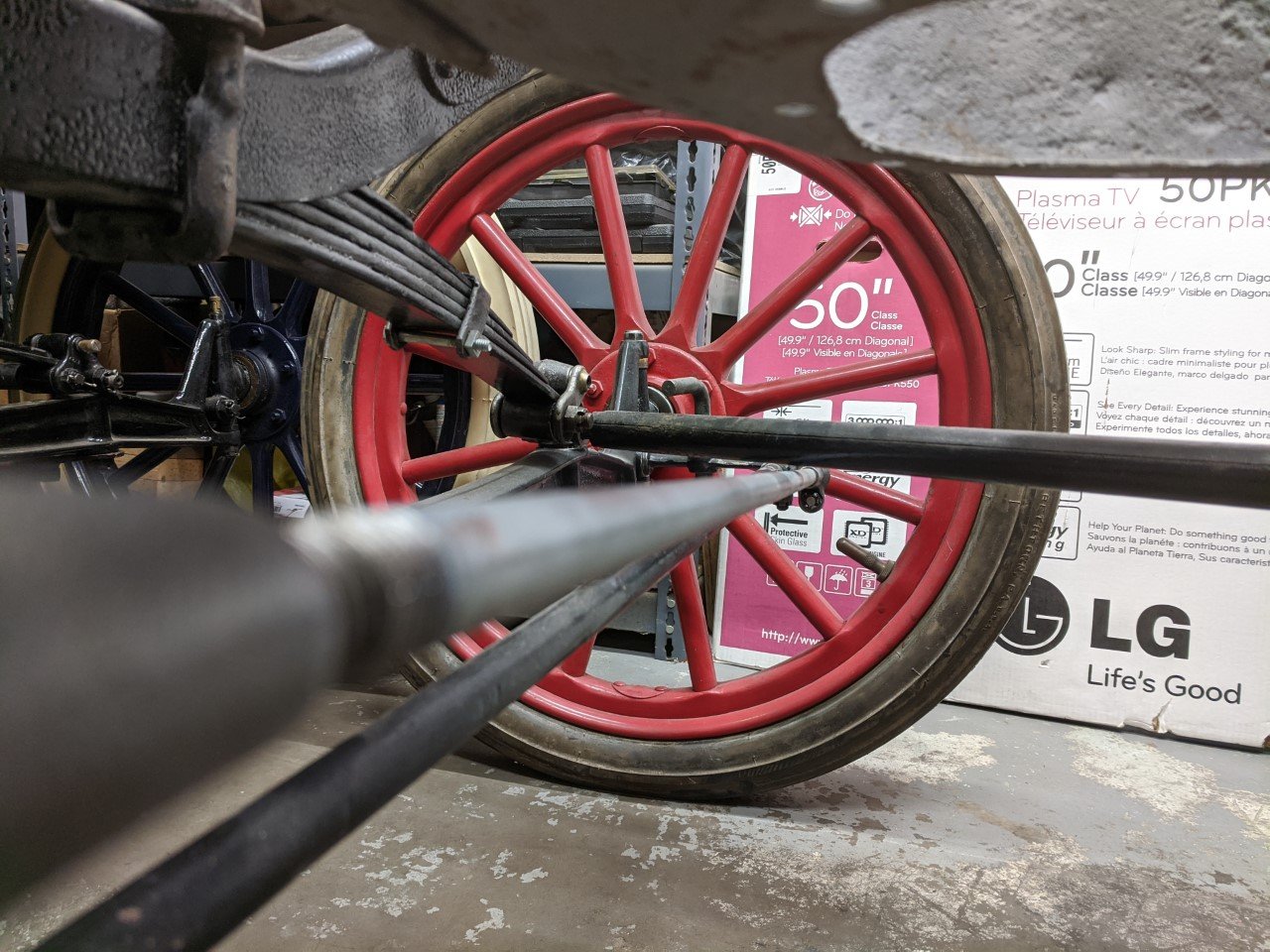

In your second photo, when I enlarge it, I believe I'm seeing a gap between the shoulder of your wishbone and the spring perch. There should be no such gap. Makes it look as if your wishbone is not fully seated against the back of the spring perch. It's very important that it is.

I agree Jerry, something's amiss in the wishbone at the perch. Also the nut is not on far enough to get a cotter pin in.

Plus the wishbone looks to be installed upside down. If it is ,flipping it would change the gap on the drag link and set the proper caster on the spindles. It appears the spindles are straight up and down or slightly leaning forward on top. Just something to think about.
- Posts: 4399
Re: Is this too dangerous to keep as is?
I believe you're correct Dennis.Dennis Fleming wrote: ↑Thu Jun 18, 2020 10:04 pmPlus the wishbone looks to be installed upside down. If it is ,flipping it would change the gap on the drag link and set the proper caster on the spindles. It appears the spindles are straight up and down or slightly leaning forward on top. Just something to think about.

that's a very astute observation. I think the seam on the wishbone being up so high is also another clue...all of which I missed.

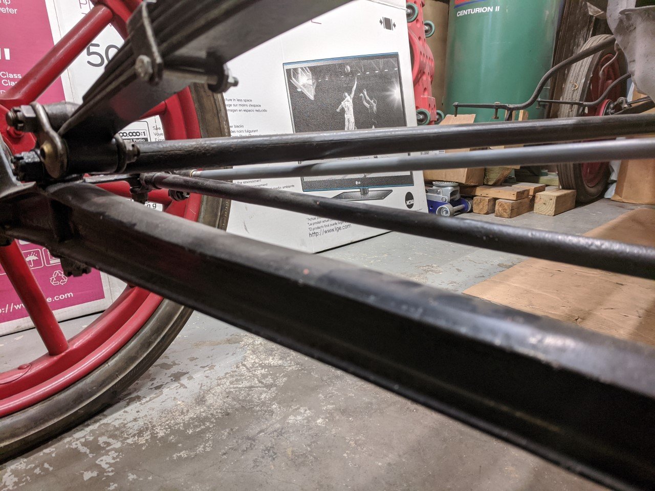

I wonder if all the early wish bones had a visible seam? Some do and some don't I believe. Also, Ford beefed them up in later years, and they are considerably stronger than the earlier ones. I admire the correct dust covers and rim nuts on your car.
- Posts: 7150
Early wishbones I have had varied considerably in weight. I put it down to internal rust. Some do have seams, but the majority are bronzed up. Sometime later in production, the tubes were shortened and the later ball end Y forging with the longer legs was used. I do not know when this change was made, but I fitted a new old stock one to my 1917 shooting brake, just because I could.

If the wishbone orientation is incorrect and not installed correctly then the answer to the tittle and question of this thread is absolutely YES!!
The gap between the drag link and wishbone is far less worrisome period!
Please be safe.
