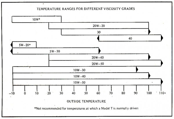

Post by Steve Jelf » Tue Jun 16, 2020 11:46 pm
A very expert Model T mechanic told me he uses 15W-40. Another, who probably drives more than the rest of us combined, uses Kendall 20W-50. (I don't know why Kendall.) Ford recommended 20W. But 5W-20 is NOT the same as 20W. I would definitely not mix in the 5W-20 at 50/50. Maybe half a quart at each oil change, if any at all.

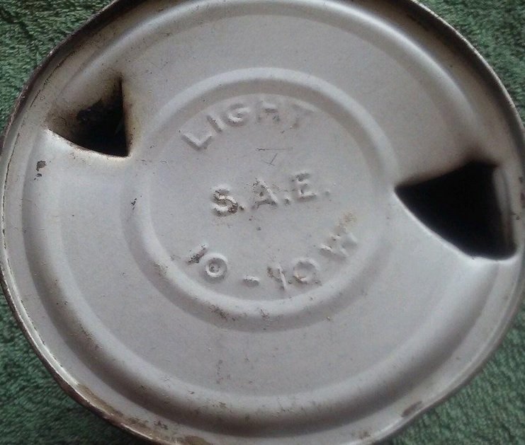

Squirrel
Posts: 140
Joined: Sat May 30, 2020 9:54 pm
First Name: Jim
Last Name: Forbes
Location: Sierra Vista AZ
Re: Oil weight
Post by Squirrel » Wed Jun 17, 2020 9:10 am
Pictures of old oil cans. Draw your own conclusions.
