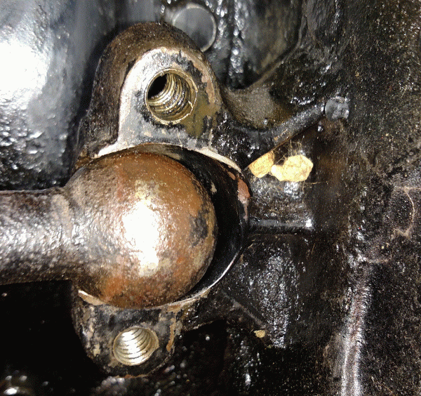

My wishbone looked like this when I got it. I fixed the ugliness but still had a misalignment problem, which I have not resolved yet. I'll get to that next project.
I used a ratchet strap attached to the front axle and rear frame to gently pull the wishbone into alignment. Then I installed the cap. The alignment issue in my car is due to severely worn shackles and bushings. I have replacements and I'm waiting for the paint to cure before installing them.
