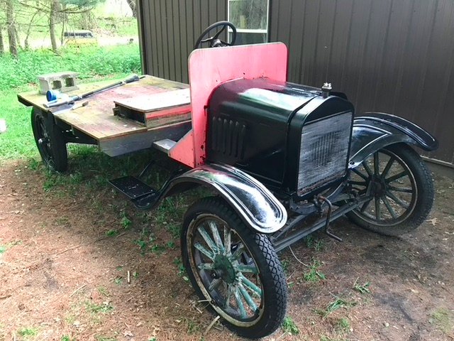

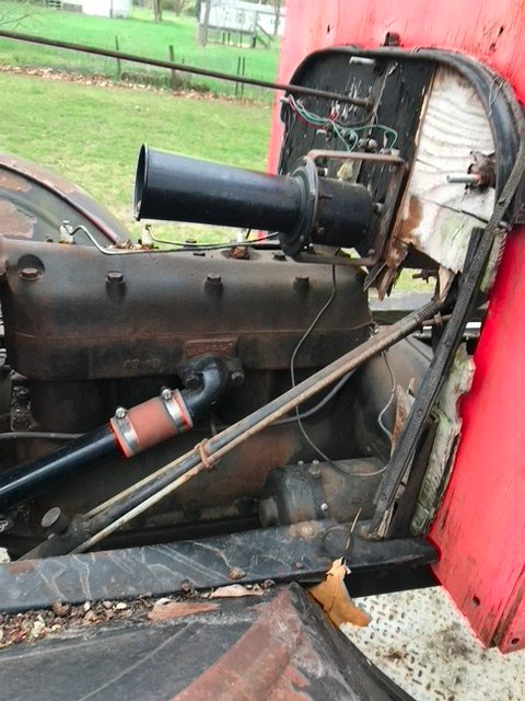

Some of the comments and questions prompt me to ask: How about some pictures? It might help if we know what we're talking about.
Corvette Guy
Topic author - Posts: 86
- Joined: Wed Mar 11, 2020 10:05 pm
- Last Name: Jones
- Location: Northern IN
Re: Wood vs metal firewall for a TT
Ya, ya, ya, I know this post is worthless without picts, so here goes.

HA, all were wrong. No cab TT. I wood stick with wood. You have seen mine Scott. Oh ya I have a metal firewall. If you have a good pattern, I would use it so you dont have to change mounts. Its going to be one of a kind. I think you will have fun with it no matter what.
