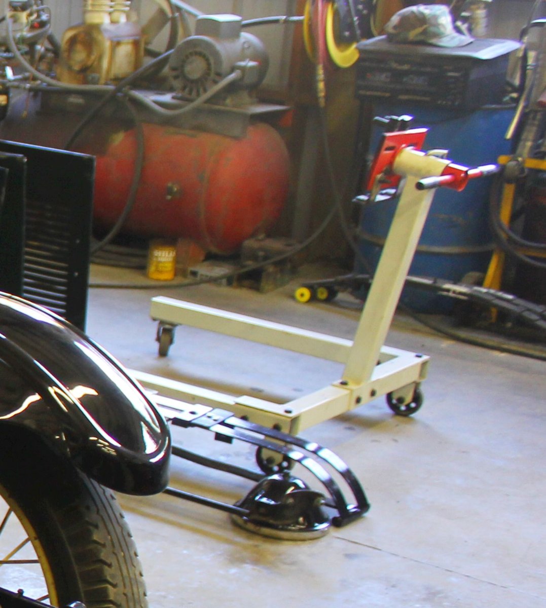

Re: Engine Cradle v. Engine Stand
I really like this engine stand. Very stable. As far as cradle I use three jack stands.
